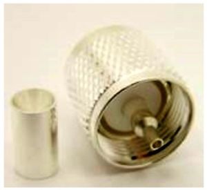

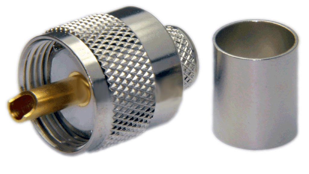

There are many crimp connectors these days but I prefer using silver/teflon with the large center pin hole similar to the standard solder type. There are some crimp connectors that have a small center hole that to me are a crimp center because a tinned center wire won't fit. See pics.
