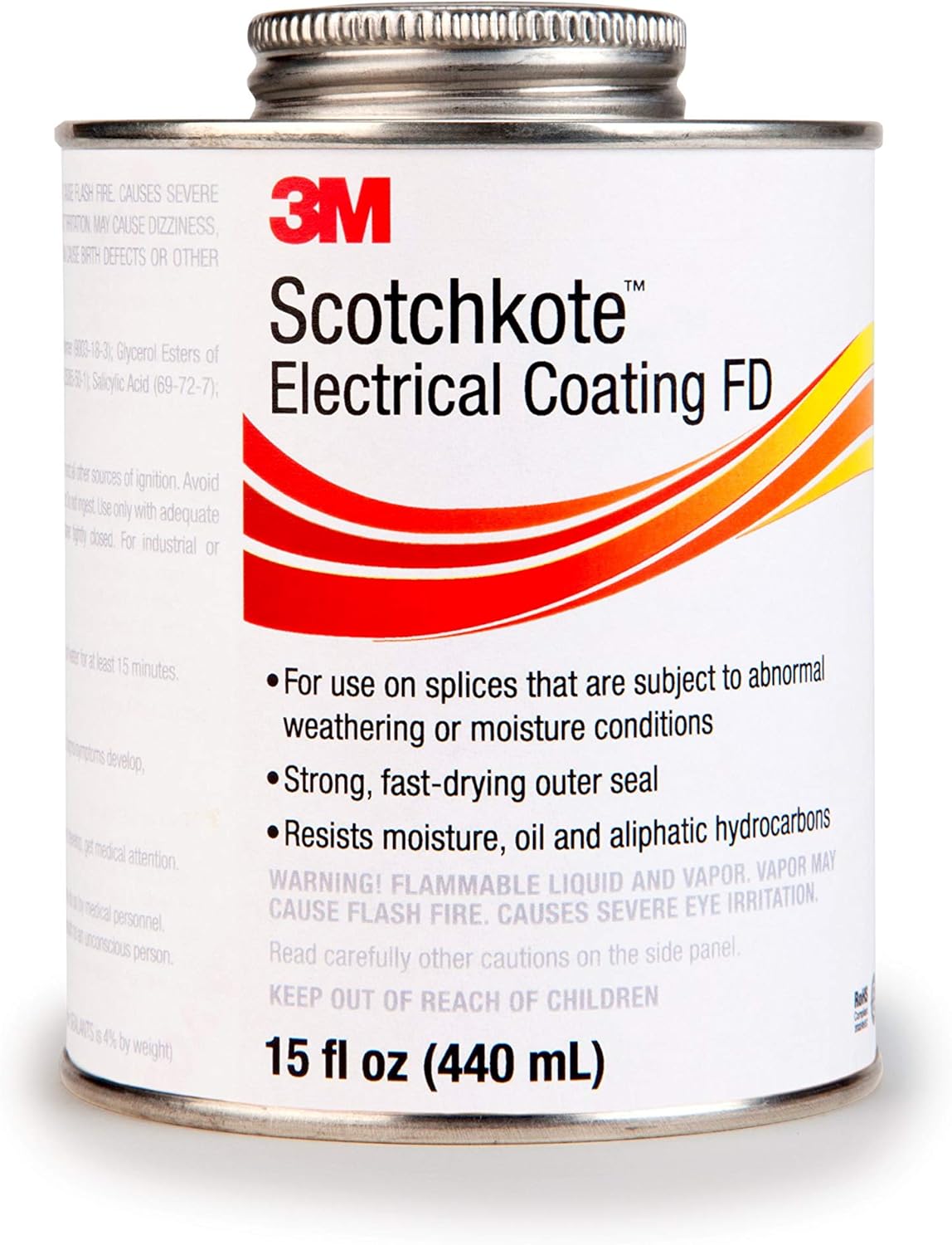

On my ground bondings I
apply this with the included brush. It's messy but it works well.
