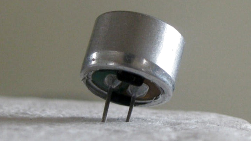

There is a seller on ebay that sells a multiple element retro fit kit for the D104. Just put all the elements in parallel, giving more gain. And I just happened to have a hand full of the small electret elements that came from telephone handsets that were in the recycle at work........
Behold, three elements wrapped in tape to make a snug fit. Plus the stock element makes four.
Wow! What a difference it makes! Big clean clear audio, better than any power mic. Seriously, you gotta try it.
Just a note, the electret elements that you normally buy will probably have too much bass. The studio type elements need an equalizer to make them sound natural. The dc blocking cap that is sometimes needed will trim some of the bass, but it also attenuates the signal.
The elements that I have been using come from telephone / speaker phone applications and have a great frequency response with a natural sound. Now that I found this out, I need to go back to some of the other mics that I did and fix them.

Sure, the radio cuts down the bandwidth, but the microphone cuts it more. I thought the telephone capsules were just ordinary capsules too. So I bought a pack of 10 elements from Amazon and quickly found out that they are not the same. An ordinary element has too much bass and sounds muddy. It needs an equalizer. The telephone element has the bass attenuated, but not as much as the Anytone or President ones. The telephone people want you to sound like you. This is what the radio people should want too.
