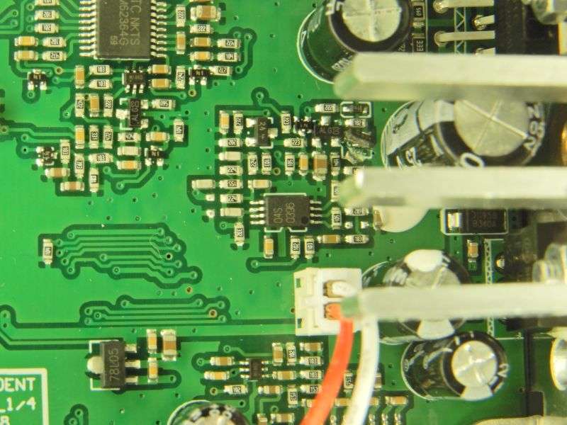

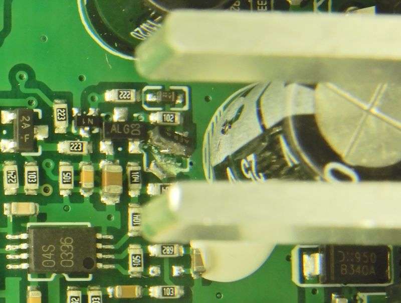

Found it. I unsoldered the collector lead on Q34, opens up the modulation. Got a customer here right now, so no detailed graphic aids yet. Just melted solder on that lead, bent it upwards on the two remaining leads. If someone wants to put it back later, they can.
Took a couple of pics. Film at 11, as they say.
As promised, here is the AMC sensing transistor for the President (Europe) Ronald. Thanks to the party who posted the service manual. Could not have done this without it. If you're in the mood to have a look at it, the transistor in question is Q34.
Here's a wide view to get you oriented.
I prefer to simply lift the collector lead. The two leads on the side opposite will bend upwards enough to break the connection. You could just remove it, but with parts so close all around I prefer to make the minimum disturbance that I can.
It's pure dumb luck that a customer brought one in Saturday with the request to make it louder.
Here's a closer view of Q34.
This will affect AM transmit only. Won't defeat any other limiting/compression feature.
