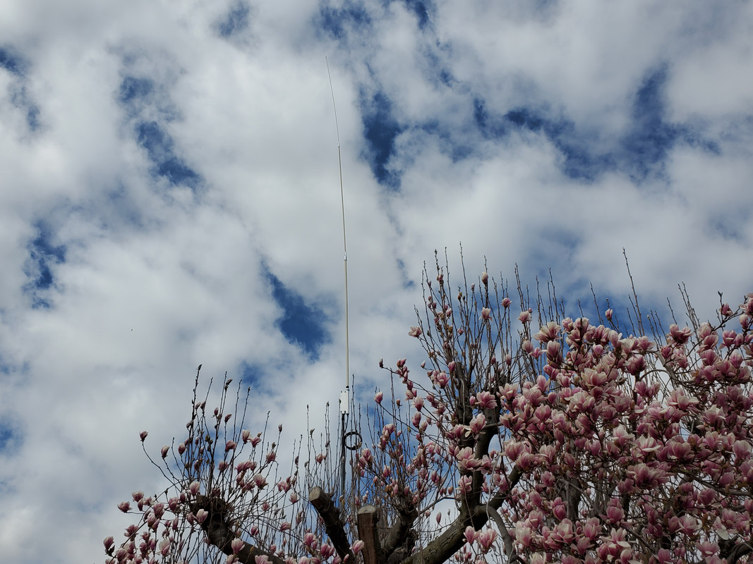

Finally got around to setting up the base (still need to find a good desk, equipment is on chairs and the floor for now). I used an 20'9" EZ UP mast, painted it and a Sirio 5/8 gainmaster with brown acrylic enamel, topcoated using a two component fluoropolymer with a silicone additive to make the surface slick, hopefully that will shed ice. Liquid paint is only around 1 mil thick, you can see where the metal on metal contact scratched it off, need to do some touch-up work where I can reach it. If I did it again I would have brought the mast to a powdercoater, powder usually is around 3 to 5 mils thick, wouldn't scratch up as bad with the poles rubbing against each other. 150 feet of LMR400DB with Amphenol crimp and solder connectors into a Polyphaser attached to a ground next to the house, then into the radio room. 1.2 SWR.
Neighbors can't see it, crossing my fingers it remains inconspicuous when the leaves drop.
Made contact with a triple 1 in upstate NY running a barefoot Cobra 148F on 37 LSB early yesterday morning, made more contacts on 28 AM with 305 Wyoming and 806 Lubbock with some juice turned on.
