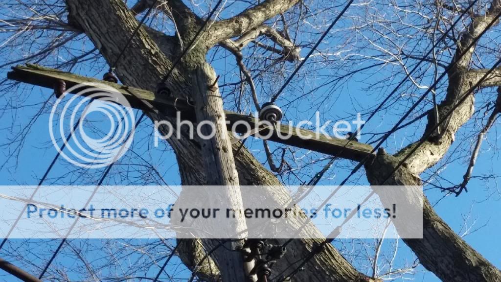

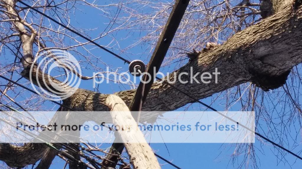

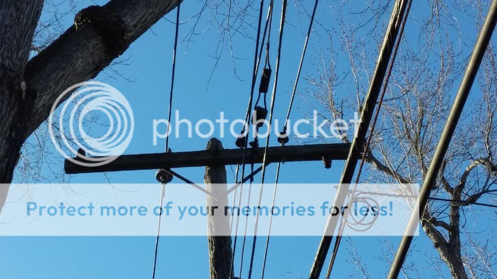

I FOUND IT!!! I Think....
I GOT IT!!!! :thumbup: I hope :rolleyes:
Used my radio buddy handheld CB and found it in 2 minutes :D all the power lines look like this on my street and they all need to be fixed there all rotten
witch brings to an all together different subject how dare the city of buffalo walk down my street and site the people for down spout and rotting gutters when our city power poles look like this! the wood on them is so rotten it is dangerous!!! o I am going to have some fun Monday :sneaky2:
just look at the 120/240 volt lines and how ratty they look!
Yep, that insulator is just hanging there. Just hanging and micro arcing. It's screaming for some WD40.
Those are some decrepit poles and hardware. They might fix the source of your noise, then something else on the line will get loosened and begin arcing.
