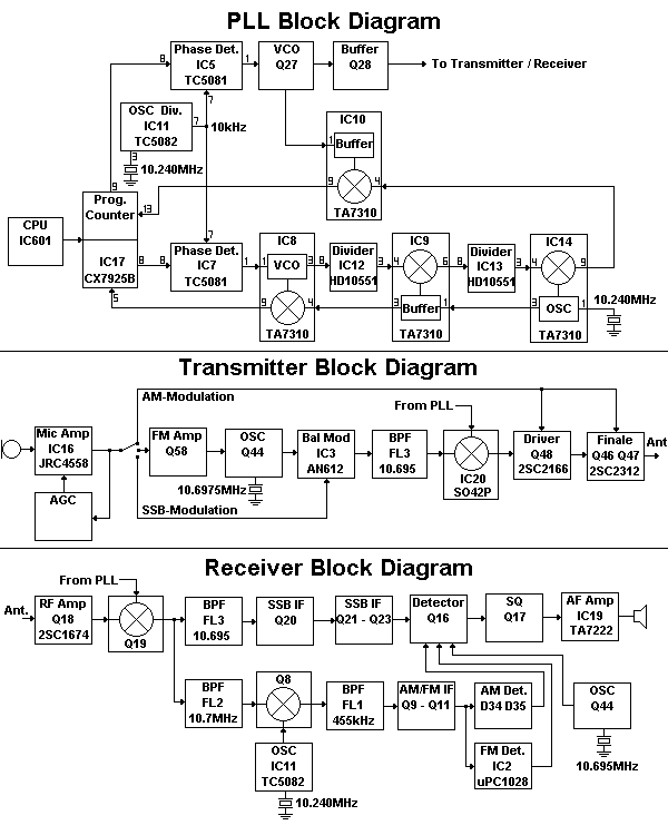

I have a RCI2980 EPT3600-14b board everything works, but I have no rx on am or fm but it tx on them, but its fine on ssb. Any ideas on what to check?
I would start with 455KHz filter.

To receive SSB means everything is ok in the RX strip until it breaks off to do the conversion for SSB - the "break" sounds like a simple wiring problem onto something more exotic and complex...
