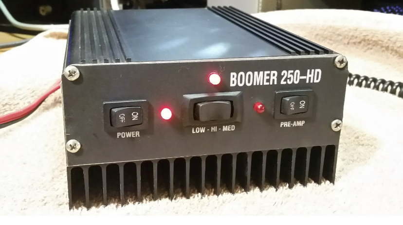

Is it possible to make this 2 1446 into 2879? DEI or hg. Not paying Toshiba prices . Thanks guys.

The original 1446 that are in it are imo better than the hg transistors. If they are burnt and you have no choice or you simply have your mind set on a swap out then hg or dei are your only real choice. If it were me id sell the boomer and put that towards an amp with what I want.

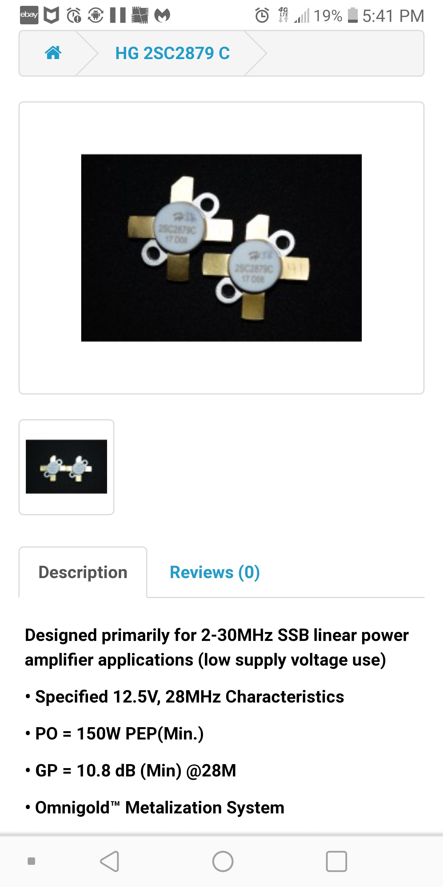

I just talked to a local with a little inside knowledge and rumor has it the HG2SC2879"C" series are 150w pep where the others are 100w pep, 50% more. I just posted this in another thread.
I have no personal experience with these pills, im just told some of the better known builders are starting to use them more.
Maybe they are starting to design their own and will stop trying to reproduce the toshiba.

The transistor slots in the board for the 1446 transistors are not large enough to fit any 2879's in there.
Look at the data sheets for the two different transistors you are talking about and you can see the physical size difference.
Now then, can it be done ???
Absolutely.
Not even cost effective because the board will need to be removed to resize the slots, possibly relocate the transformers to accommodate the larger transistor slots.
A bunch of "stuff" would have to be changed.
Not even worth the time or cost.
As mentioned above, sell it and get what you want.
If I was doing the conversion, it would cost at the very least as much as a new amplifier.
