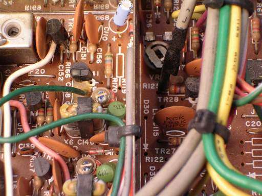

That one's pretty straightforward. One diode D30 gets unhooked at one end, or just removed altogether. This disables the "fixed" transmit side.
The resistor that feeds the front-panel control gets removed and moved onto the solder side of the pcb, where it will reach to a source of continuous 8 Volts DC that stays on for receive and transmit both.
Here's a pic of the diode D30 that gets removed, or showing where it was before removal.
Imageshack has somehow lost the 'before' picture showing where on the top side to remove R119. It's a 100-ohm resistor. Brown-black-brown. But at least they didn't lose the 'after' pic showing where R119 will go on the solder side of the board.
But these are the required two steps for most any 40-channel CB radio. First unhook the transmit-only circuit. Then move the power source for the front-panel knob away from the receive-only voltage source, to a continuous voltage source.

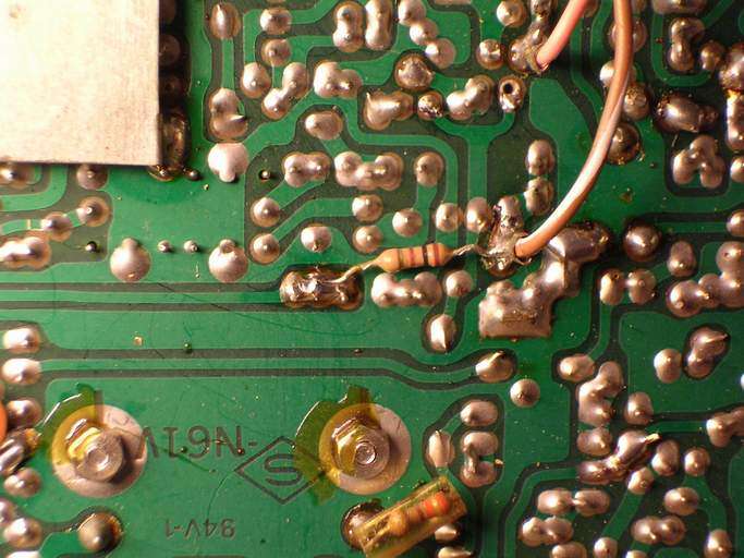

Here's how our tech told us to do it. Works well with shift the same amount in both directions and the 12 o clock position is at the exact center frequency.
1) The hot wire that originally fed rx only voltage is removed and replaced with a feed from constant 8/9v via a 100 ohm resistor.
2) The cold terminal goes to a resistor on the pcb and the other side of the resistor is ground, remove this resistor and replace with a wire link.
3) Remove the tx voltage source component, usually a trimpot but sometimes a diode.
4) Check it now works as unlocked and transmits and receives on the same frequency.
5) Adjust the frequency trimcaps or tuning inductors for maximum range on each mode lsb and usb. Don't try and center it yet with these adjustments, just go for maximum range at the high end.
6) Put the clarifier at center 12 o clock position and add a resistor from the center terminal to either hot or cold to bring it to as close to exactly on frequency on lsb you can get with the resistors you have on hand.
Connect it to hot to raise the frequency and cold to lower it.
A higher value resistor gives less shift, a lower value gives more. Start with 4.7k and go higher or lower to suit. One of those resistor wheel things is a useful gadget for this step.
Fit the resistor permanently, then do a slight adjust the frequency trimcap / tuning inductor to precisely center the lsb frequency.
7) Leave the clarifier at 12 o clock, put radio on usb, and adjust the usb frequency trimcap / tuning inductor to center the usb frequency.
Done! With our cobra 139 base and gladiator mobile which are both 858 chassis, it gives about 3k to 4k up and down either side of center and 12 o clock exactly on center.
