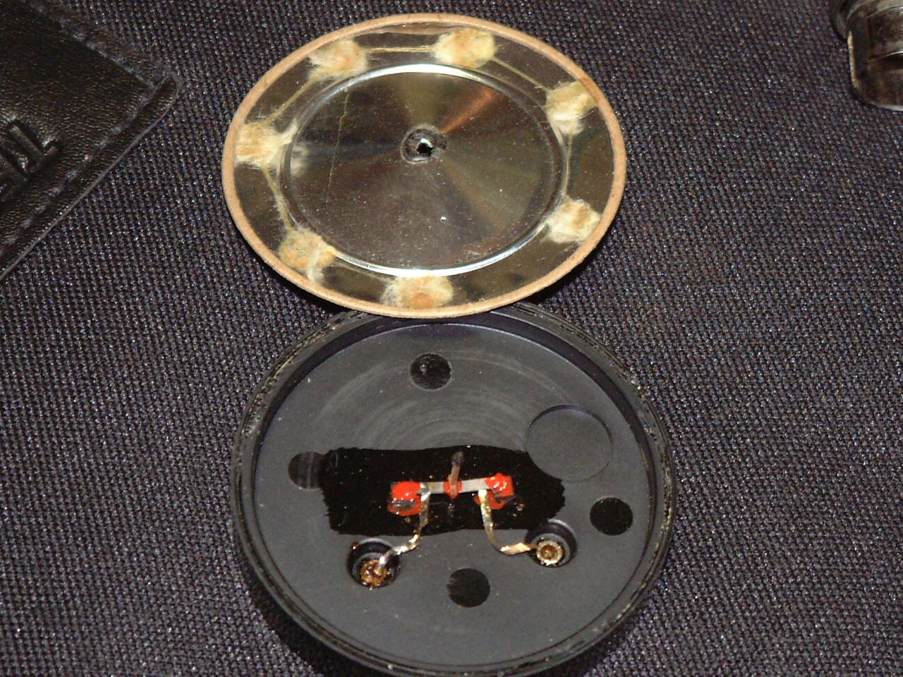

Boy, that one doesn't look like any of my MC320s I have on the inside.
Could that one be the ceramic-element model MC-321? The Rochelle-salt element is bigger, rectangular and wrapped in its own metal foil.
Only two diagonally-opposite corners are anchored to the inside of the cup, so that it flexes along the longest axis possible. The Y-shaped yoke that protrudes through the center of the diaphragm is glued to the other two diagonal corners.
Reactions: Shadetree Mechanic
Now THAT looks like the MC-320. The Rochelle-Salt crystal is wrapped in metal foil. Makes me wonder if a tiny dab of super glue to each of the two tiny rubber support blocks wouldn't fix a lot of them.
I'm no metallurgist, but knowing the alloy used for the diaphragm, as well as the thickness would seem to be an important part it it's accoustic properties. Leads me to wonder if I took an old diaphragm to the local scrap-metal yard if they would let me zap it with their handheld metal-identifier gadget and see what it says is in there.
Forming the new diaphragm with a cone-shaped pair of dies seemed obvious enough. Figured a plastic 3D printer might be able to produce that. Never got around to learning how to model it in CAD to feed into one of those. Seems like the #D printers at the local hackerspace are either busy or broken whenever I drop in on them.
Just another project of high hopes and low priority, seems like.
(y)If the aluminum diaphragm is unusable after it is removed, then maybe it can be fixed without removing it? Maybe drill a hole in the back or a tiny hole in the diaphragm. Then squirt some glue in with a syringe. Lightly probing for the foil pack and then flood the area around it. I am thinking that maybe the reason mine started working again is that when I had the element out, I laid it on the diaphragm and it sat there for days like that. Maybe it stuck itself back together? Maybe it was pure luck and it would have started working no matter what I did. You guys really got me thinking now.

The crystal element in the D104 just started working again and then I fixed it some more with a different mic amp in the tug 8 base but it didn't really need it. The Robyn itself works ok, I just need to make some room for it in the station. Thanks for stopping by and checking it out.
