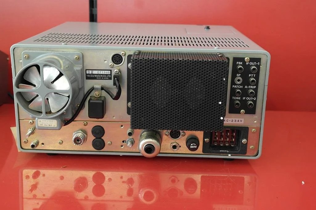

....So, what I have is a Dell desktop with "XP"on it and a Yaesu FT-901 DM that works well also.....I want to get back into "computer generated" CW and RTTY....
...A friend alerted me to 1-2 free-bie programs but, am clueless as to connections or, even if additional hardware is necessary such as an interface....Can anyone give some detailed assistance?....Thanks in advance!

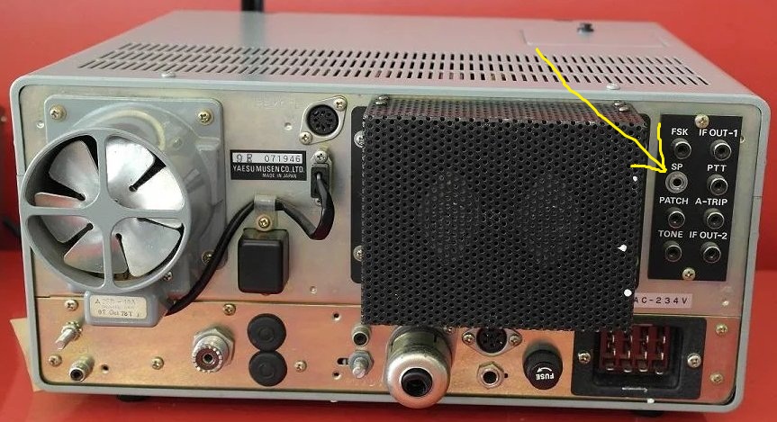

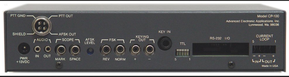

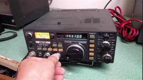

(SHOULD HAVE POSTED A PICT(S) OF THE 730 BELOW)
.......Please advise...

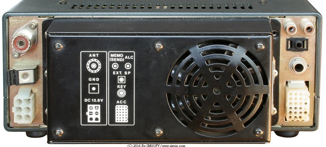

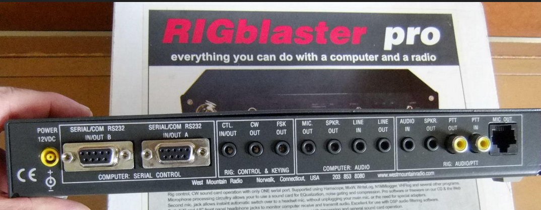

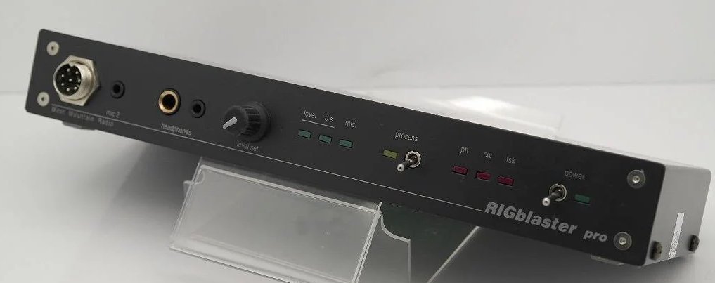

I acquired a "Rigblaster Pro" a few days ago, un-used in orig box, etc.....Spent the last 4 days on and off attempting to get this "!!!!" working and, with no success....
I temporarily put aside the "AEA PK-232, CP-100, and CP1" for now to concentrate on this headache.
Below is a copy of an e-mail sent to the manufacture yesterday to which I hope I can get some assistance:
1...Purchased a RIG BLASTER PRO (henceforth referred to as "blaster") unit a few days ago and have been frustratingly struggling with it since arrival!....
A) ***All jumpers installed for ICOM radio although, specific model not listed**
B)***All "shunts" installed for ICOM radio**
C) ***Jumpers and shunts verified 3x's for accuracy**
2...Radio is an ICOM 730 rig (henceforth referred to as "radio" or "730") with screw on front mic connector.
3...Radio is set to CW mode.
4..."Modular" cable is plugged into the back of "blaster".
5...Other end of that modular cable has a ROUND mic connector and, is plugged into the front mic connector of 730.
6...Audio cable is connected to back of 730 radio speaker output jack (using a "splitter" so as to hear radio through external speaker).
7...Other end of audio cable is plugged into back of blaster "rig audio output sections' audio "IN" jack.
8...Cable is connected to back of blaster at COM Port
"IN/OUT B" .
9...Other end of that cable is connected to port at rear of Dell Desktop computer using Windows XP as an OS.
10..."Blaster" switched to "ON".
11...Front rotary knob of blaster adjusted to "minimum".
12...Processor switch switched to "process" (tried both on and off so-to-speak).
13...Rotary knob is set to "minimum".
POWER LIGHT (WHEN SWITCH IS ON)............... IS "ON"
FSK LIGHT ...................................................................IS OFF
CW LIGHT ....................................................................IS OFF
PTT LIGHT ...................................................................IS OFF
PROCESSOR SWITCH (UP OR DOWN)...............LIGHT IS OFF
MIC LIGHT ...................................................................IS "ON"
CS LIGHT .................................................................IS OFF
LEVEL LIGHT .............................................................IS OFF
LEVEL KNOB ........................................................IS SET TO THE LEFT (NO DIFFERENCE R OR L).
What am I forgetting here??.
...I see many un-used audio cables and wonder why so many.?...

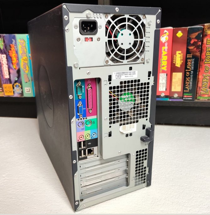

I have installed quite a few of the programs on the CD disk' and just having a VERY DIFFICULT TIME...
My goal is to simply do CW (send and receive) and RTTY (send and receive).
What software are you using for the radio? Maybe use the last version of Ham Radio Deluxe before it became commercial software. Assuming you have HRD installed, you should be able to hit send and it should at least put your radio in transmit.. If it isnt, then double check the serial settings on HRD. That is what controls the transmit on and off.
A picture of the inside of the Rigblaster may help. :)
Also, don't plug in your Commodore 64 with the stock power supply. They are notorious for taking out C64s. In short, it probably took out some ram chips, next to go is the PLA chip, and from there on out, anything else is game. I would offer to fix it but I don't think I have any extra PLA chips to sell or give, but suppose I could at least socket the chip so then you can put in another. We can save that discussion for another time. :) For now, gotta see how to get your rigblaster to make that Icom go into transmit.
**CAPS ARE NOT YELLING AND ONLY USED TO SEGREGATE PORTIONS OF THE CONVERSATION**
I WOULD HAVE TO GO BACK AND CHECK BUT, INSTALLED A FEW FROM ENCLOSED CD.
I DO NOT HAVE IT INSTALLED AT THIS WRITING
BEFORE THIS, I STILL SHOULD BE ABLE TO RECEIVE...1 STEP AT A TIME..
I STILL SHOULD GET "SOMETHING" ON TE LIGHTS ON UNIT AND DATA ON COMPUTER MONITOR.
IF YOU NOTICED, I INDICATED THAT I WAS USING A DELL DESKTOP!...NOT C-64.....GRIN
NA---N/A----USING A DELL COMPUTER AS INDICATED IN TE TEXT I POSTED.
I JUST RECEIVED A PRE-MADE CORD FROM MANUFACTURER FOR MY YEASU FT-901-DM...EITHER WAY, STILL HAVE TO WAIT TO SEE WHAT MANUFACTURER IS GOING TO TELL ME.......(PS THANKS FOR THE REPLY)....
EDIT: I think that I have to get it to receive as intended and then, to effectuate transmit......

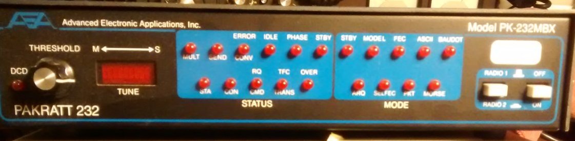

Using the PK-232MBX,

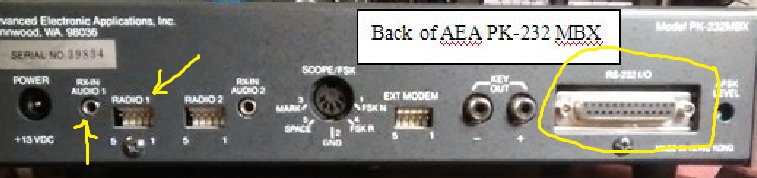

1)...I have power connected to unit (of course!)....
2)...Have RS232 cord from back of "232" to com port 1 on back of desktop computer...

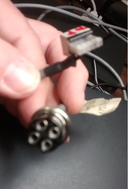

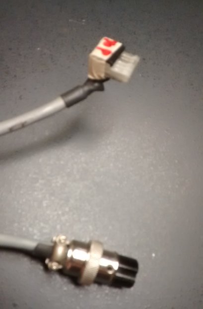

3)...Have cord with 4-pin mic connector connected to front panel of "901" and other end which yields a "strange-looking" flat connector into "radio 1" port of 232.
4)...Have audio speaker cord connected from output of radio to input of 232.
I can get "movement" on front bar graph of 232 but "squat" on FLDIGI program.....Seems to me that I am missing something critical here!...Unlike the Rigmaster, should there be wires connected to the computers' sound card (ie mic and speaker jacks)?

It looks like you got them all attached right. I just realized that duh.... The speaker audio from the radio itself goes into that Radio 1 audio jack... Disregard what I said earlier. I looked at it wrong.
That device I believe works solely by itself. Maybe open up a terminal program like Putty or another one of choice and see if you can at least type in commands and log into your packratt. I dont think fldigi would work for you in this case as you are feeding the audio straight into the packratt, so there is no way for the computer itself to decode/receive it.
But for sure, see if you can properly talk to that packratt through a Terminal program.

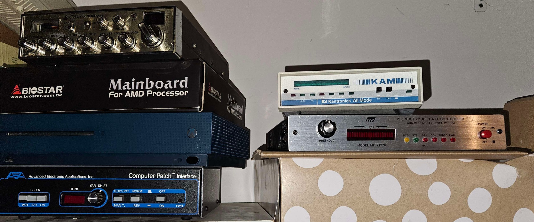

Let me take a picture of the device I got as a freebie last year in September during a vintage computer show in Chicago. Knew it was ham radio related and snagged it up along with a Kantronics device. My Elmer (Rest in Peace K7NNV 2022) Gave me his Kantronics in 2019 which I was able to get working and use a system out of Reno Nevada. Now I want to set it back up thanks to this thread of yours lol.
I will edit this thread once I get a picture.
Here is the picture.
$HIT!
WILL ATTEMPT SHORTLY...NEXT ISSUE TO TACKLE IF TO SEE HOW TO SELECT MODES ON UNIT AND TO TX/RX.

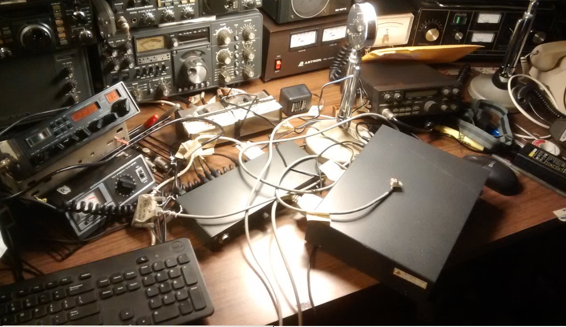

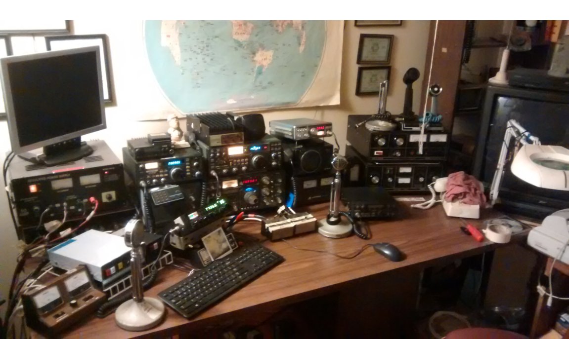

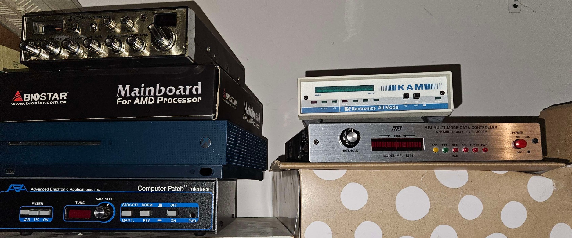

My stuff...Setting back up after many years........Now I realize why I got out of this....Too many headaches!
***Before-----
***During-----
Reactions: doffo
Some great rigs and amps there! I noticed the VHF amp. I want to do some SSB 2m stuff but never got around to it just yet.
For the most part, just choosing Serial and typing in the COM port number, example mine is on COM9, then click open. Putty then should open up a blank black window. Press enter to see if you can get the Pakratt to respond with something.

I TEND TO GO FOR THE OLDER STUFF BUT, BACK THEN, THEY WERE RELATIVELY NEW....AHHH, I LOVE TUBE FINALS!
I HAVE A 150W(?) AMP UP TOP THERE SOMEPLACE THAT IS 2M....FAN OF DENTRON STUFF...DENTRON MLA-2500 WITH MT-3000A TUNER....A DENTRON CLIPPERTON-L IN THE CLOSET, A DRAKE TRANSCEIVER (NEEDS ONLY A COUPLE OF TUBES AND A X'TAL OR TWO...
MY TOWER WAS HIT (I LITTERALLY SAW IT TAKE A DIRECT HIT ON IT WHICH LEFT A BURN MARK THE SIZE OF THE END OF A PENCIL ERASER ON IT) YEARS AGO AND SINCE COAXES WERE CONNECTED, TURNED IN ALL MY EQUIPMENT TO HAVE EVERYTHING I OWN IN THERE CHECKED AND ALIGHNED AND, IF MARGINALLY GOOD, REPLACEMENT PARTS INSTALLED INCLUDING ALL TUBES...I WANTED TO BE SURE THAT ANY MAGNETIC CURRENTS, SPIKES, ETC DIDN'T INFILTRATE THE PARTS AND TAKE OUT SOMETHING....I HAVE 2 HRS ON ALL MY STUFF EXCEPT THE DENTRON AMPS WHICH I HAVE LESS THAN AN HOUR KEY-DOWN TIME.

Also, wondering if I have my Rigblaster here with me... Thought I had it in Nevada. may have to go look out in the garage for it soon. I havent used it since I dont have my Icom 706 MKIIG here. My 756 PRO II I have a separate cable set to make the task easier, but the rigblaster is nice to interface with other radios. I might have to make a Kenwood TS-430 cable for myself and give it a try. This way its a close setup to the way you have it there.
