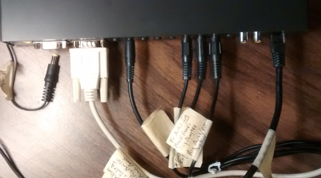

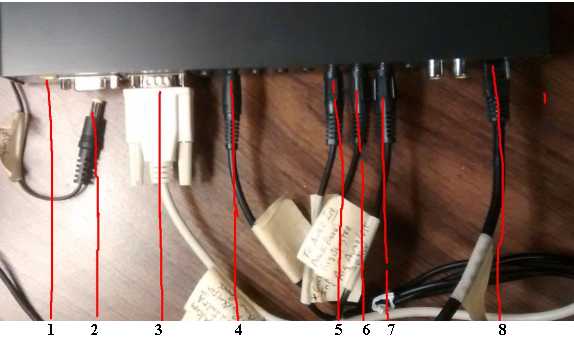

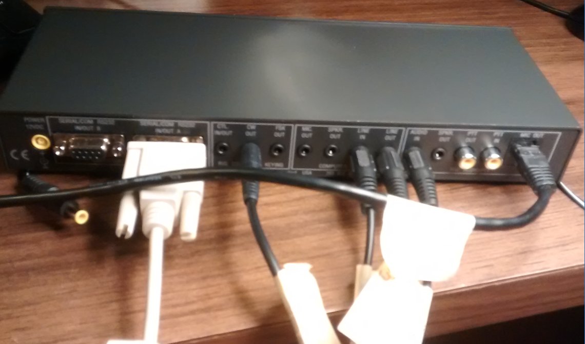

A few picts -
The Mic input may be sensitive and over drive the audio, so keep an eye out on the levels... You may need to select the microphone input on Digipan in the Sound card settings if the mic input isnt set to default in windows itself.
Otherwise, you are for sure set on connections. Yes, when you click the T/R button one time, it will keep transmitting till you click it again. :) Just making sure if you click it, then click it again to turn off transmit that it is keying the radio. Next step is to setup the audio side of things.
