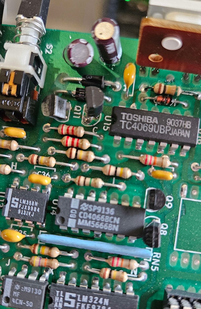

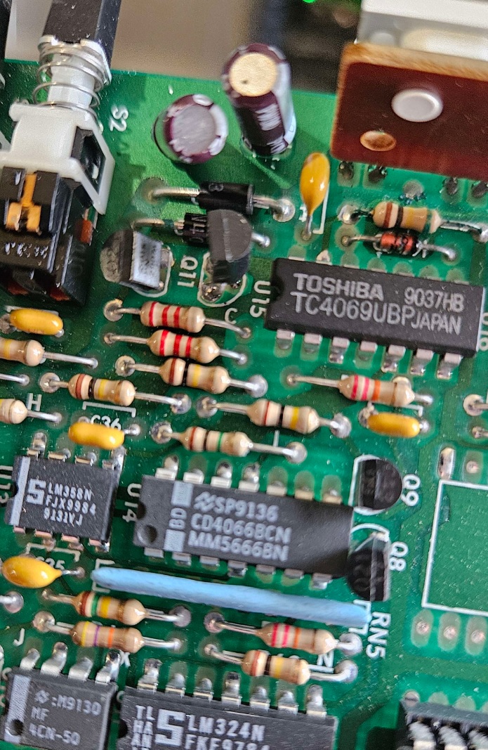

I had chance to plug in that Kantronics KAM, and it was dead. Thought I might of used the wrong serial cables, but it turns out the devices are notorious for them to just go dead. There was a good page explaining the problem and I was able to change out the 2 capacitors on the front of the device, and the device works great again. That might of explained why it was on the free pile lol.
Your PakRatt should do something similar once you use Putty to see if you can get inside it.

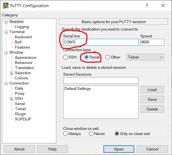

When you open with Putty and turn on the PK232, does anything ever come up? It should be outputting something at least to sign in, maybe pressing enter? But from what I gather, it may print junk up until it actually shows a * on the screen, then you press shift+8 on the keyboard to get the * character. For sure do you click on the serial button and then click open?
NO - JUST A CONFIGURATION SCREEN...THERE IS ANOTHER PART OF PUTTY THAT, WHEN I CLICK ON IT, PULLS UP A BLACK WINDOW BUT, PRESSING KEYS ETC DOES NOTHING.
SEE ABOVE
YES...I HAVE IT CONFIGURED FOR SERIAL COM 1 AND NOTHING HAPPENS....

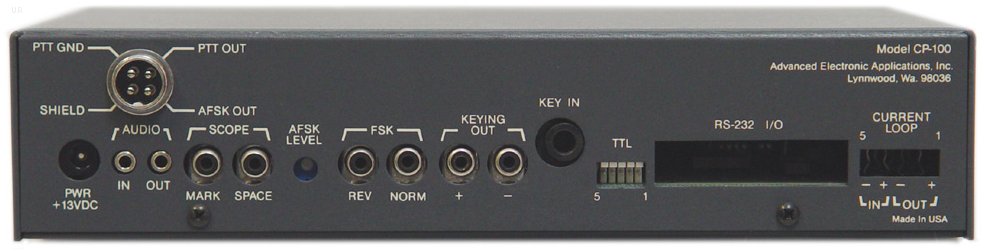

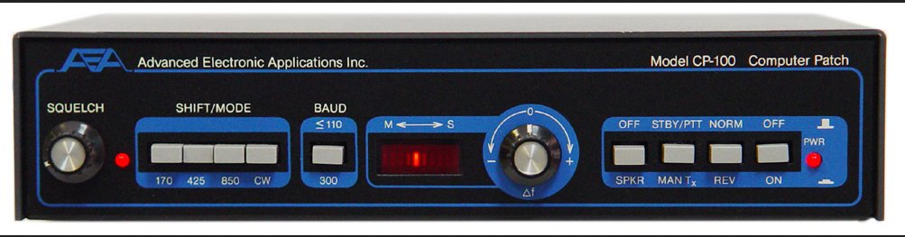

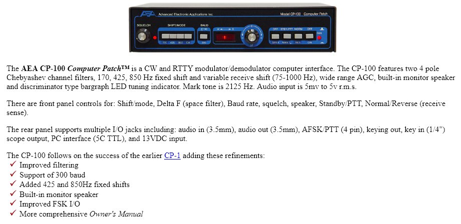

LAST NIGHT, I ATTEMPTED TO TRY USING MY AEA CP-100 FOR WHATEVER REASON:
I RE-INSTALLED FLADIGI AND IS "READING" (USING YAESU FT-901DM) BUT, WHEN I PLUG IN THE CORD (PREVIOUSLY PICTURED) WITH ONE END TO THE FRONT PANEL MIC INPUT OF RADIO AND THE OTHER SIDE OF CORD WITH THE "FLAT END" TO THE "TTL" PORT ON CP-100, THE RADIO GOES NUTS AND KEYING WITH EVERY SOUND RECEIVED....( I JUST DID THIS TO SEE WHAT WOULD HAPPEN)....

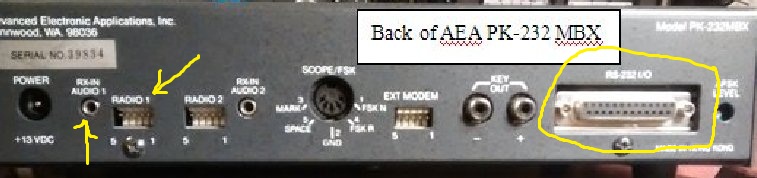

GETTING BACK TO THE PK232 UNIT,
YA KNOW, THIS SHOULDN'T HAVE TO BE THIS DIFFICULT....
A) RADIO SPEAKER AUDIO OUTPUT TO COMPUTER MIC INPUT,
B) COMPUTER AUDIO SPEAKER OUTPUT TO AUDIO INPUT OF PK232,
C) SERIAL CABLE FROM BACK OF PK232 TO SERIAL COM 1 PORT OF COMPUTER...
D)
"PATCH CORD WITH 4 PIN MIC CONNECTOR TO RADIO MIC INPUT JACK AND OTHER SIDE TO RADIO 1 (OR 2) BACK PANEL INPUT OF PK232...
