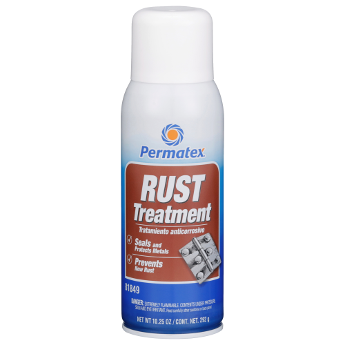

Here is a rust control product I bought years ago at my local Do It Center by the gallon with Phosphoric acid and there is no mixing. Just used some a couple days ago on my bead rolling kit. Can't know what the price is these days but I'm sure It can be had cheaper than MFG suggested price. But like all chemical Use Caution.

That's interesting. Isn't hot phosphoric acid what is used to blue/black metal by forming some sort of crystal structure on the surface?

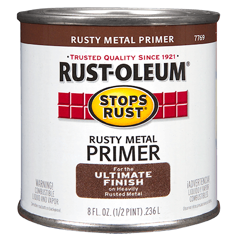

This has fish oil in it that seeps into the rust and will stop the rust from growing.
I've bought and used that also. My next project is sand blast and replace rocker panels on my Cobalt. Pennsylvania is known for Salt and Rust. Only problem is at almost 75 yo just don't crawl around like you use to. LOL Thank god for fabricate & welding skills or I'd be dead in the water by now. 90+ temps and humidity holding me back right now. LOL
