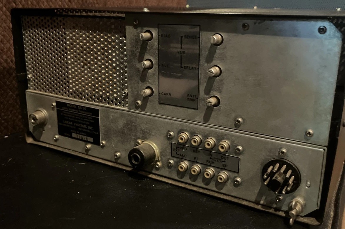

I'm somewhat shopping for a transceiver and some of them have this
Just wondered what it is :oops: :D

maybe to mute a separate receiver, activate an external VFO or anything the manufacturer designs into the radio.
I remember Johnson made some early CB radios that used this for a selective call feature.
It was a plug in accessory that muted the rx until it heard the correct tone to open the receiver.
I think Lafayette had something like that as well.
Jeff
Called an (x) pin octal plug. Common on some older rigs for accessory connections and also for power cords from an external power supply to the transceiver. You see them on a lot of older tube rigs. The old Yaesu rigs seem to have used them a lot. The Tempo One used them for connecting the external power supply to the transceiver.
It's a socket for a power cord... I've recapped so many tube radios that I know this to be a fact...

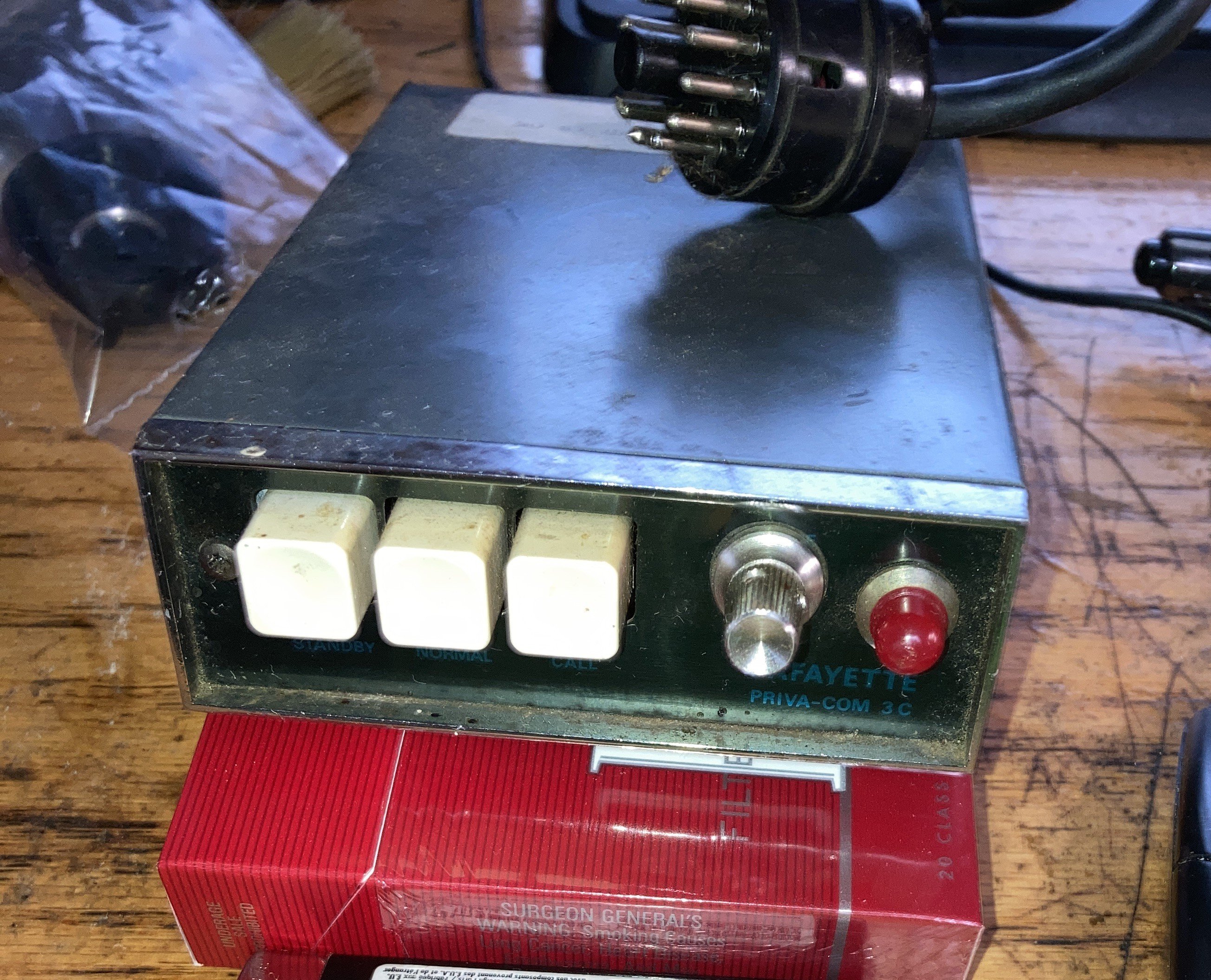

Jeff
Jeff
I know for a fact that Lafayette did make a selective call feature. It was called Priva-Com 3C. Pictured below...
What's it on the back of? Connections to and from will vary with manufacturer. Yaesu carried screen and driver voltages, ran the Tube Heater circuit in and out and had a set of relay contacts (N/C and N/O) accessible via the plug.
Heathkit HW/SB-104 used it for Ext VFO power and T/R relay access. Earlier SB series connected the HP-23(A) power supply this way, as did the HX-1681 transmitter.
And then there's the Tempo, pointed out above.
Etc.
Reactions: saturated

Lots of older tube gear had those such as the Robyn tube radios & the Teaberry Model T radios & many others. Lots of tube type amateur radios as well.
Sorry guys I should have included the radio type (YA THINK ?!?!) :cry:
If I remember correctly it was a SIDEBAND ENGINEERS SBE-36
Thanks again
Reactions: W4KVW
All the E.C.I. tube radios (Couriers, Aircastles, Fannons, Realistics) had nine pin connectors for power. Depending on how the plug was wired it could power the radio with AC or DC.
Just to clarify but octal means eight. Unless it is an 8 pin, it is not an octal socket. The above socket clearly has more than eight pins. Octal are 8 pin. Noval are 9 pin. Compactron are 12 pin and that might be what is pictured in the original post above. You can count the pins......11 or 12 of them. Cannot see real clear. There are some odd others as well. UX5 are 4 pin. UX5 are 5 pin. UX 6 are 6 pin. Novar and Magnoval are both 9 pin but have different diameter pins. Duodecar compactron is another type of 12 pin socket, hence the word compactron being in the name. It is a 12 pin but smaller pins like used on the 6KD6 tube. LOTS of different names for the various tube sockets however only the 8 pin types are called octal sockets.
I see you identified it as an SBE-36. Here ya go in case you don't already have it.
SBE-36 user manual
