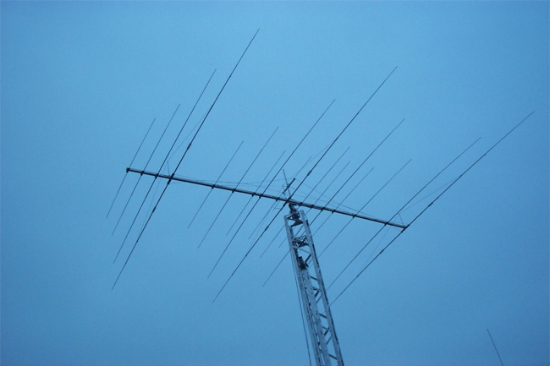

multi-band yagi antennas are quite common. I have not built nor run any, as I am only a CBer, but several of my friends do.
here is an example of several Yagi antennas on one boom:
I'm not really understanding what you are trying to do. Are you trying to make a milti-band dipole(fan or rotatable) or a directional antenna (yagi)? A two element yagi for those bands is going to require some engineering. A yagi is not a situation where you can just slap some elements on a 6 meter boom and expect it to work.
