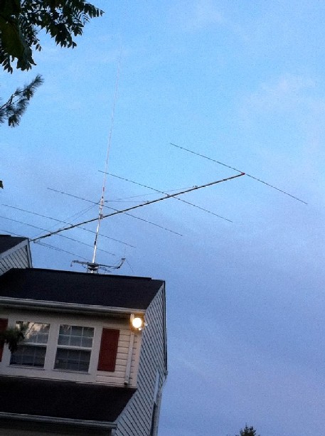

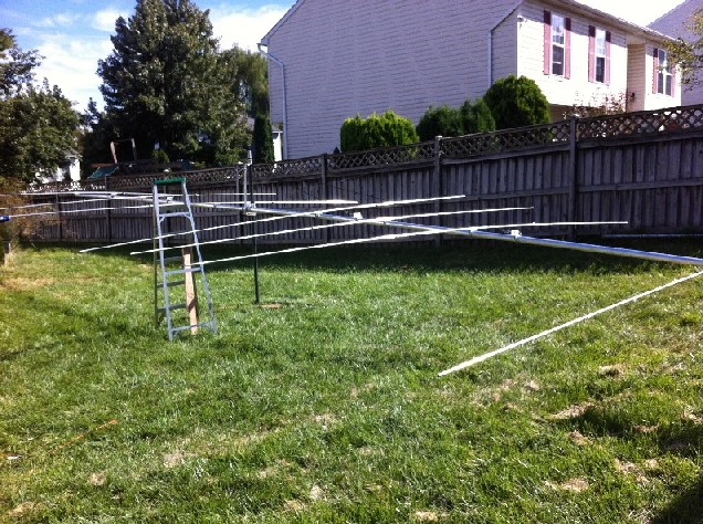

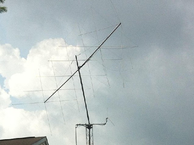

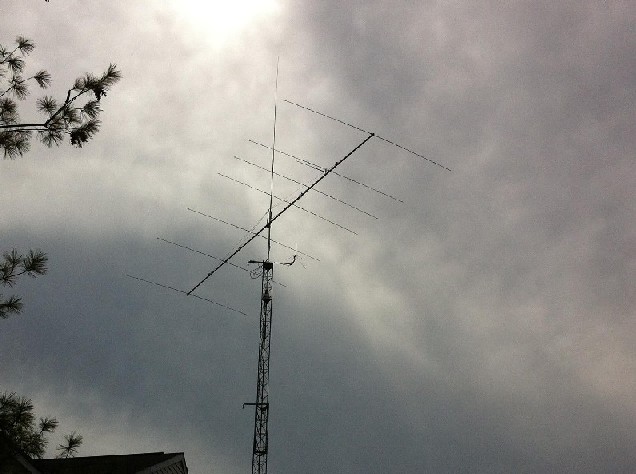

So a freak storm came through and broke my Signal engineering 6 element Quad. Decided not to fix it as I did in the past, and try the Maco M107 Yagi. I have some loose end to tie up but I am happy with the install. I hope the M107 is a performer. There is an Imax on top, and a 2meter GP Just below the M107.

That is a nice looking antenna farm. thanks for the pics.

Summarize, the Quad is my preferred antenna, but I use yagi's because the Quad is a nightmare to construct and keep in the air.
As the picture shows, it is not if the quad gets broke it is WHEN it gets broke.
I see your mast bent also. What did you use this time. I used 1026 dom. Give us a comparison of the quad vrs the yagi after you have used the yagi for abit. Your new antenna looks nice. Sorry about the quad. Peace!

Yes I do. I am thinking about selling If I can figure out how to package and ship. If the you can aluminum solder the beam can be fixed.. or reduced to a 4element. I ran over one of the element wire with the lawn mower and weed whacker.
