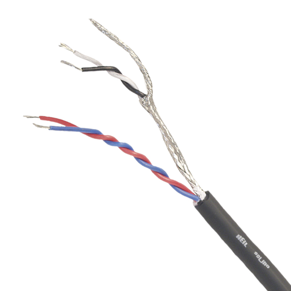

I bought a 25’ roll of Heil straight microphone cord from DX Engineering. Don’t remember what the cost of it was.
I have used quite a bit of it. Works well. I do not like coiled microphone cords at all.

For a 4 pin mic, starquad mic cable (the type typically used for XLR cables) should work well, and you can get the connectors on Amazon, Digikey, etc. If you need more than 4 conductors, shielded network cable like cat 5 should work. Make sure you use the mic audio and mic ground on the same twisted pair, and the PTT on a different pair to prevent noise. If you use network cable, I would recommend using a stranded wire variety rather than solid core.

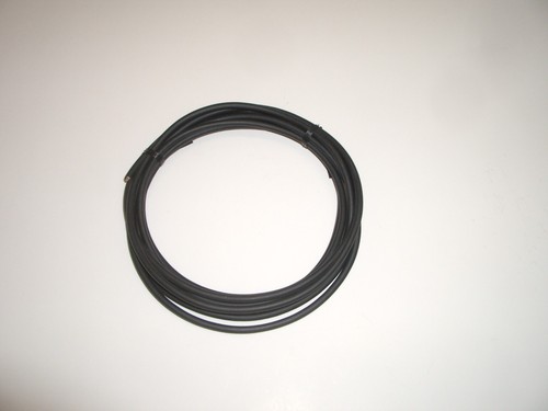

here ya go!
it can be bought in longer lengths as well.

Ideally the audio wires would be in a separate shield from the control wires. But if it works, it works.
