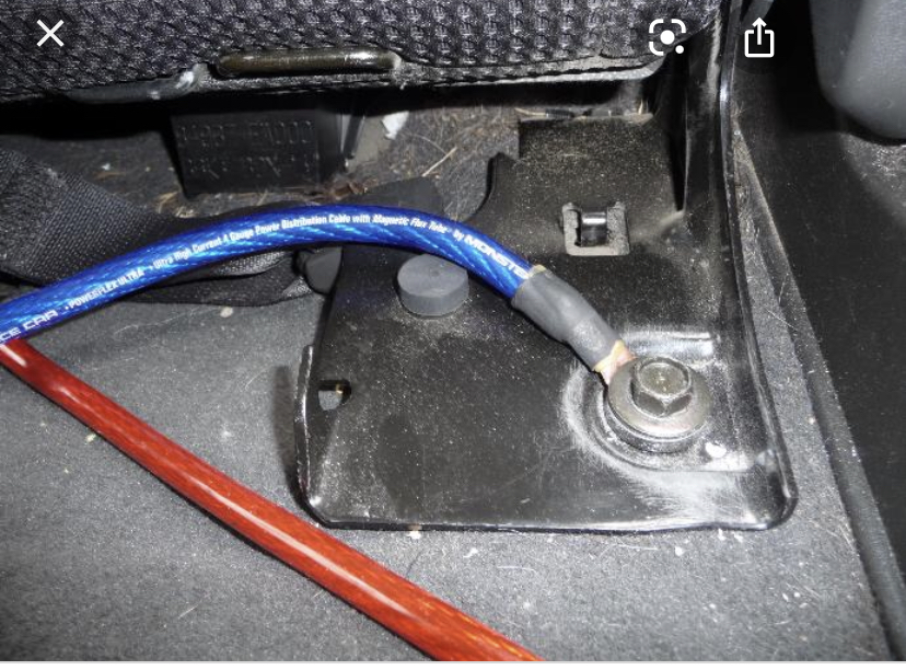

So here the latest. I check the seat bolt with Dmm. Ohms set to 20 I touched probes together reading 0.2 . Ran one to negative terminal to battery other lead to seat bolt were eye lug is bolted to bracket. That reading was 0.2 so that’s 0.00 which is a great ground.
This is a general internet pick of what I did . I sanded bolt threads and bolt washer and the whole bracket to shiny . Current reading 0.2 probs touched 0.2

My 2017 GMC Sierra does that, I'll have to run the RPMs up to 12-1500 to prevent it. The ground looks fine, especially if you're getting .02/0.0 ohms, I will say this, you can have 0.0 ohms until you put a load on it, then if it's not solid, the resistance will increase, the lug will get hot and your ground becomes a current drain, but as long as everything is tight, that should be a non-issue. . Your ground sounds good, as short as possible is the rule.

The true test of your seat bolt ground is to measure the voltage at the amplifier when you hit the key. It is possible to have a connection that looks good when checking resistance because it has no load. A situation like this could deliver adequate average power out of the amp, but peak power would be lower than rated.
