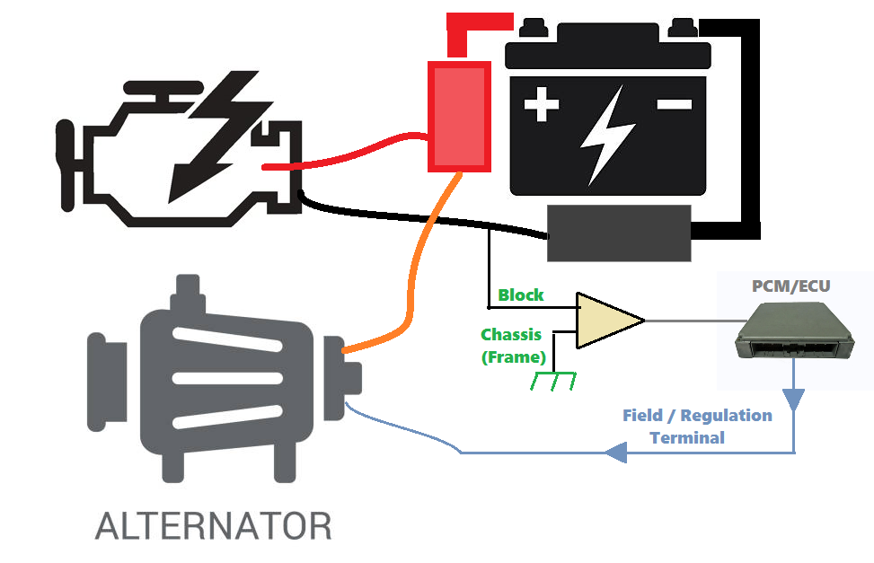

I hope you can understand this diagram.
For if you don't - then you may need to read your vehicle's OWNERS MANUAL for next time...
They (Nissan) use a Comparator to generate a differential output that the PCM then uses to boost or reduce charge rate by looking at the potentials between BODY (Chassis) and Engine Block - when Frame current demand goes up the difference is sent to the PCM to boost alternator output - when demand drops, the PCM doesn't ask the Alternator to produce as much
Due to the newer technology in kinds of butleries, plus their wide variety you can use, the system monitors more of the Frame and Engine needs than the Battery - this lessens the charging swings for the Battery - it simply acts like a load all the time, so the PCM does the decision making - not the Regulator - it's been put in the ECM on Nissans post - 2015...
When you're at Idle, and key up the linear, the system needs to boost the voltage so it should kick up idle - if it isn't then the system is not sensing the load because the system doesn't see a "secondary feed" from the powered system, a Demand line - on the PCM monitor line.

I thank you all for all the help. Handy Andy didn’t give up on this and actually figured it out. Long story short Nissan has a variable voltage regulator on negative battery cable . So it talks back and forth to the alternator bla bla bla . So you all know knock on wood I have zero issues on the move just at idle. Weird as hell Andy suggested to sit idle in neutral with AC on and try key radio and amp and start modulating ::::::: absolutely no movement from battery gauge and I heard something kicking on and off , no it wasn’t the ac clutch well that to but I felt like something in my motor was calling for more juice . Andy knows his crap . Thank you all
