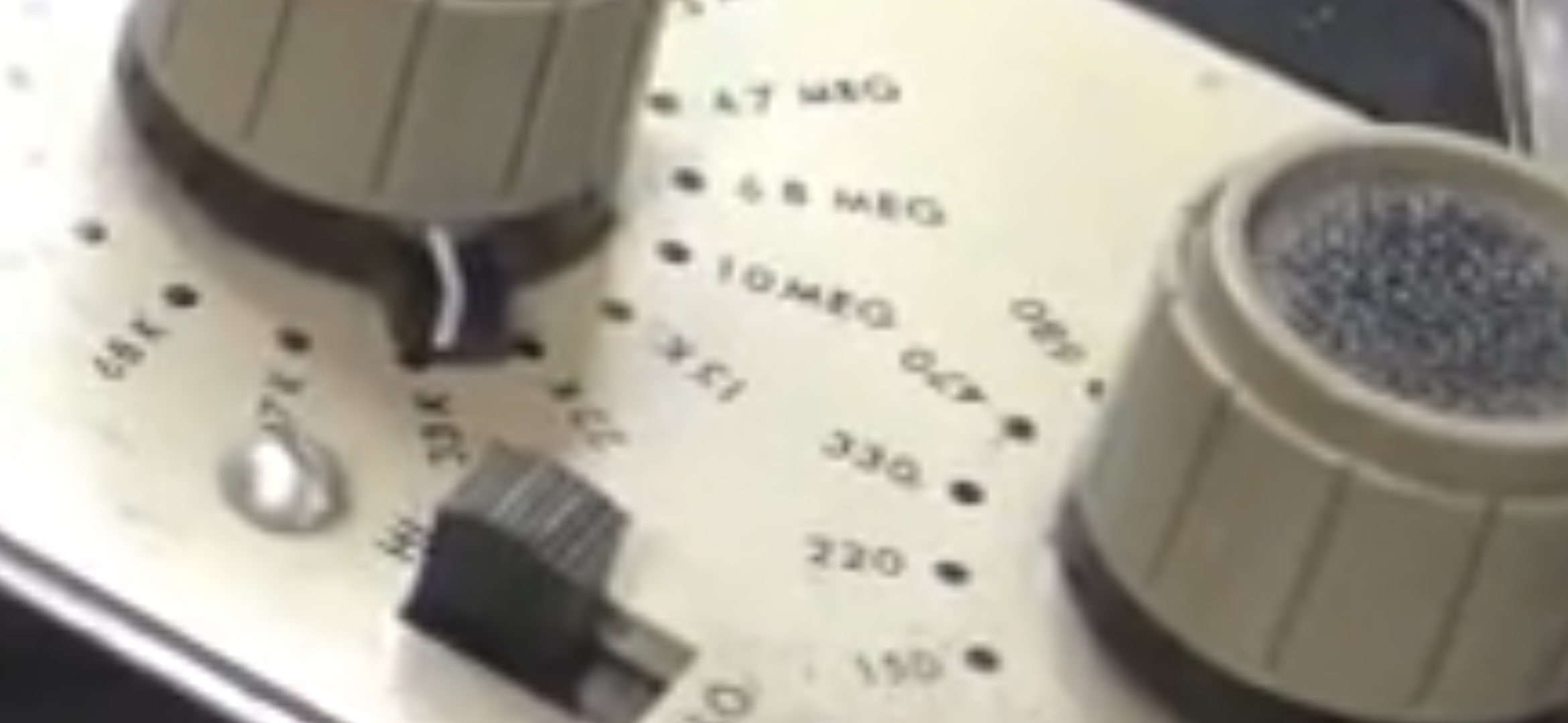

Looks like his box is a variable resistor set to the hi range with selected resistances in the kohm range.

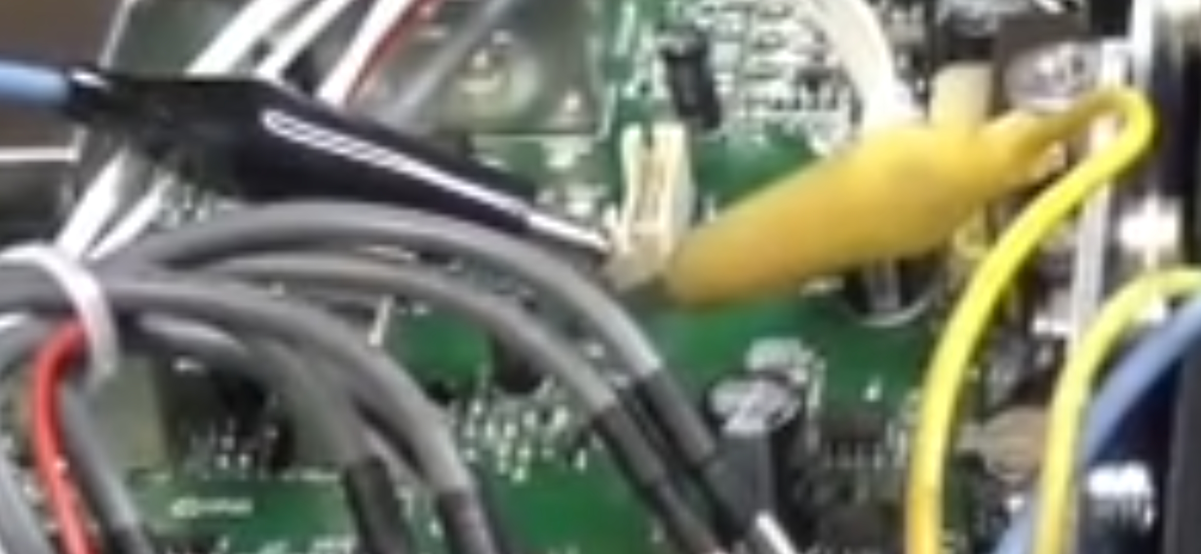

And it looks like the leads go just south of that connector.
So maybe with a zoomed in picture of the components in that area to cross reference with the schematic (no board view available on cbtricks) it maybe could be figured out
A resistor sub box set to 33k leads me to suspect that it's meant to mislead. Might be legit, but the audio-circuit impedances in that kind of radio are typically lower than that.
