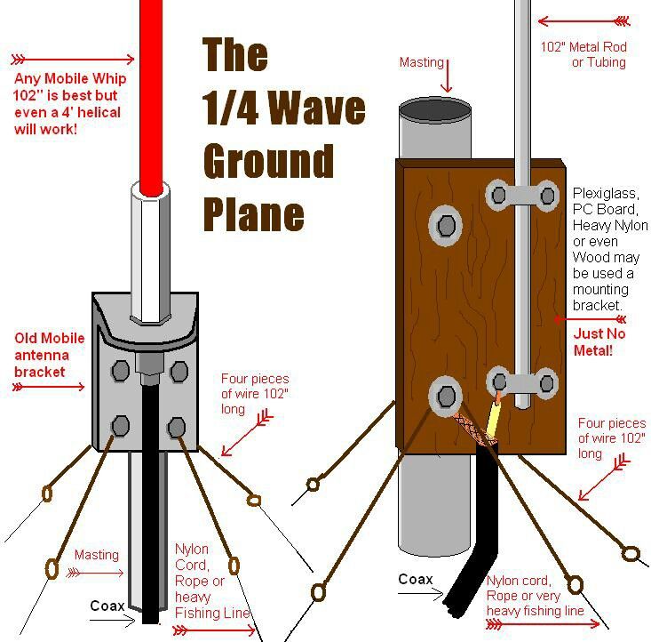

Once the plastic insulator is properly seated, I don't think he'll ever get an acceptable SWR without some sort of counterpoise, whether it be four wire radials or just one. Unless he attaches the steel whip to a Chevy. Or a metallic roof. Something.

When I used my 102 as a ground plane, I had the whip with no spring and 3 radials. If I remember right I made the radials longer than 102 inches and had to shorten them for the best swr reading. I was able to get 1 to 1.5 swr across all 40 channels. It may have been dumb luck, idk? But it worked really well for me.

Hello riverman, I'm going to take you guys advice and ditch the spring and build some radials also going with a different 239. I'm going to come off the bracket with the radials. Is it ok to use stranded 12 ga. Wire with insulation or do I need bare wire. Thanks, Dannell. South MS.
Dannell,
Insulated 12 ga. stranded wire will be just fine. Doesn't have to be bare wire. Just try to make sure the connections are solid to allow the RF to freely flow back to your radio.

That is, of course, what I am using right now albeit with just one wire radial. Have also used 4’ Firestiks. One for the vertical and two for radials (2). That worked good too. The possibilities are endless. (y)

hello everyone, removed the spring, installed different so-239 and 2 radials and I now have 1.4 SWRs on 1/20/40. I never could hear so many truckers before on the interstate, 8 miles away. I asked for a radio check, and got a answer said they could hear me good. So thanks everyone for the help.
Well done Dannell. If you can find a way to get one or two more radials installed your antenna will be even more efficient and a bit more omnidirectional. If not, congrats and enjoy. Welcome to homebrewed antennas!
