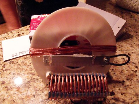

Brett, do you still have that tuning network for 11m you got from me? Have you tried it on 10 - 15? I think it will do that...
