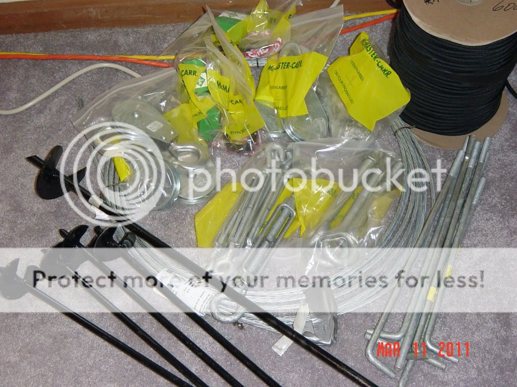

not sure what the aircraft cable is for, but if you are not using a real NICO press tool to make up the ends, always remember the rule, "never saddle a dead horse."
meaning, dont put the saddle of the crosby clip on the stubby side, AKA the dead end, put it on the working side.
torque specs are important, and nylock nuts are your friends.
you probably already know some if not all of this, but i thought id put it up anyway for others who might not.
