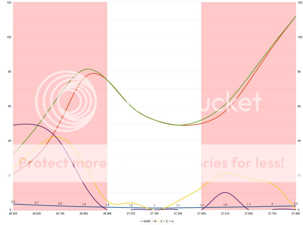

It didn't turn out as broad banded as I'd hoped, but it covers CB anyway. And it's not showing any signs what so ever of CMC with no choke or balun what so ever, directly fed with LMR400. So I'm happy about that, now to get my Heliax situation straightened out :glare:
