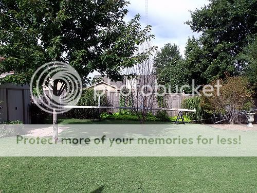

tip over tower - wooden homebrew

What kinds of wind has that wooden tower seen and with what on it's top?
I love the design and I'm thinking I want to build something like that to stick my Diamond x510 in the air with.
The www says we have an annual wind average of 14 MPH, however if they take the night time calms out of the average, I'd say it was at least 6 to 7 MPH higher. Currently, it is 16 MPH, gusting to 32. It is guyed. I have seen it under sustained winds of 35, and gusts higher - near 50 MPH. This with a 4 element Yagi, and a 5/8 vertical Omni on the top.
I love the mast if for no other reason how very quickly I can change out an antenna on it.
I originally thought I'd be able to work this mast on windy days, however, while on calm days I need no help to lower and raise it, I don't do it on a windy day if wind is in excess of 12 MPH. I once tried it while the wind was around 18 MPH. I had it over around 15 degrees. The wind stood it back erect. I quickly pinned and guyed it and waited for another day. My recommendation for this is that you put it where you normally prevailing winds are directly behind the direction the mast will tilt when operating it. Make the wind your friend. When the higher winds are calm, or behind the tilt I operate it without any alarm.
If you do one like this I recommend two bottom posts in the ground with the mast centered between them for greater strength while tilting. There is significant stress at the bottom of the mast on both the lower ground-embedded post(s), and along the mast just above the pivot point when going up and/or down. Also, 2x6's for the section right at the pivot point would be an improvement, too.

On the ground for repairs and upgrade. I plan to make the bottom section from 2x8x16' lumber, and the upper section from 2x6x16' material. I will gain 4' of wooden height, and substantial integrity for the mast. I went with 2x4 materials originally because I feared larger would stress the lifting mechanism too much. Since then the lifting setup has proven to be more than enough for the 2x4, so I will upgrade.
The tip over tower is guyed within four feet of the top.
