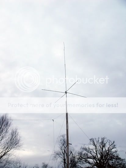

Still working on the fixing up another homebrew 5/8 to test on that tower against my Qv4k. Everytime I try to do a little something my work schedule and other priority obligtions go haywire. I have engineered some GP radials for it, purchased materials to spin a decent matching coil, designed a means of putting them together on the vertcal radial and just need to get them all into a single unit, set my match, and plod ahead with the testing. All this is from hardware store and recycle materials.
I am anxious to utilize this tower in one of the ways I put it together for: easy access for putting test antennas up and down to try them in real time.

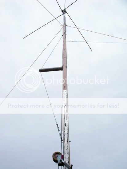

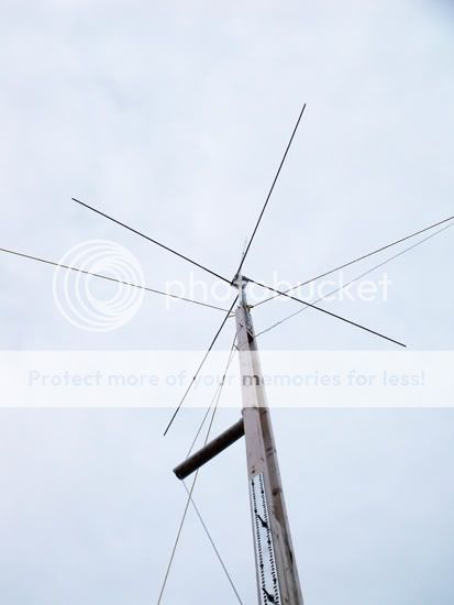

Photos of the lift mechanism
Photos:

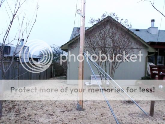

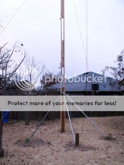

We tend to have wet ground softening winters here, so I added some support for the tower:
