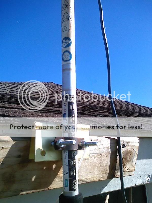

tip over tower - wooden homebrew

Is it easy to lower, enough to try the 5/8(23' .64?)?
That certainly is unique... I like it!
Yes. Very easy. No strain, great gain ;)
When I get it laid over (hopefully this evening) I'll photograph the hoisting mechanism for ya.
I kinda want to build one of these now! Not sure what I'd put on it, but it looks like a good design.
Only thing I'd comment on, is advise running some copper strap from the mast, to a copper rod at the bottom, to act as both an electrical and RF ground.

Better than mines Homer. Door hinge and a weed whacker handle :lol:
:lol: Nice on Homer, You got me thinking here. I got an Idea, probably gonna modify my lay over gadjet.

- You have that guyed farther up, right?
I don't $ee how it could avoid falling to one $ide if not. What'$ the antenna atop that highly unique $$aving mounting $y$tem?
going by your other dollar saving exploits,i can just picture the hoisting mechanism,the wife with a huge f@cking rope,lol.
seriously though homer,its looking real good there,hopefully it will last you years.and i bet it will be a damn sight cheaper and easier to repair should anything go wrong than a commercial tower.
would also be ideal for a horizontal dipole mounted just below the top with no tower interaction.
The tip over tower is guyed within four feet of the top.
I have been lovingly doing honey do's the last several days. :angry: Hopefully, I've cleared enough of the list that never gets shorter to be permitted to play with my toys for a day or two. If so, I'll get the tower over, reinforced, and painted. Sorry, the little woman vetoed the red and white striped scheme. So I'll have to find some paint that let's it blend into the rest of the place . . . :confused1:
As for the dipole, the plan is to try a HB9CV for 11 meters right above the wood, beneath the vertical. We'll see.
