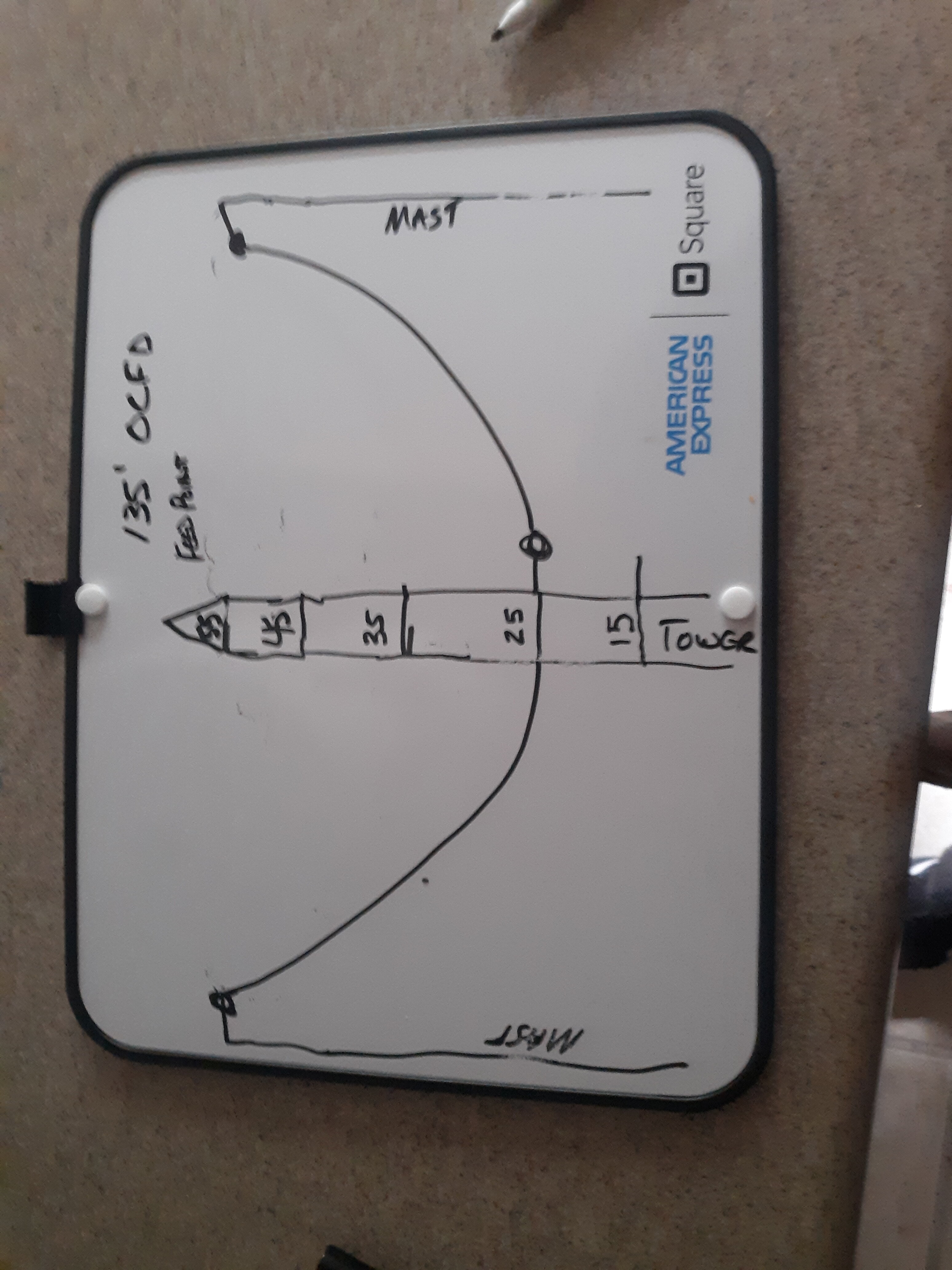

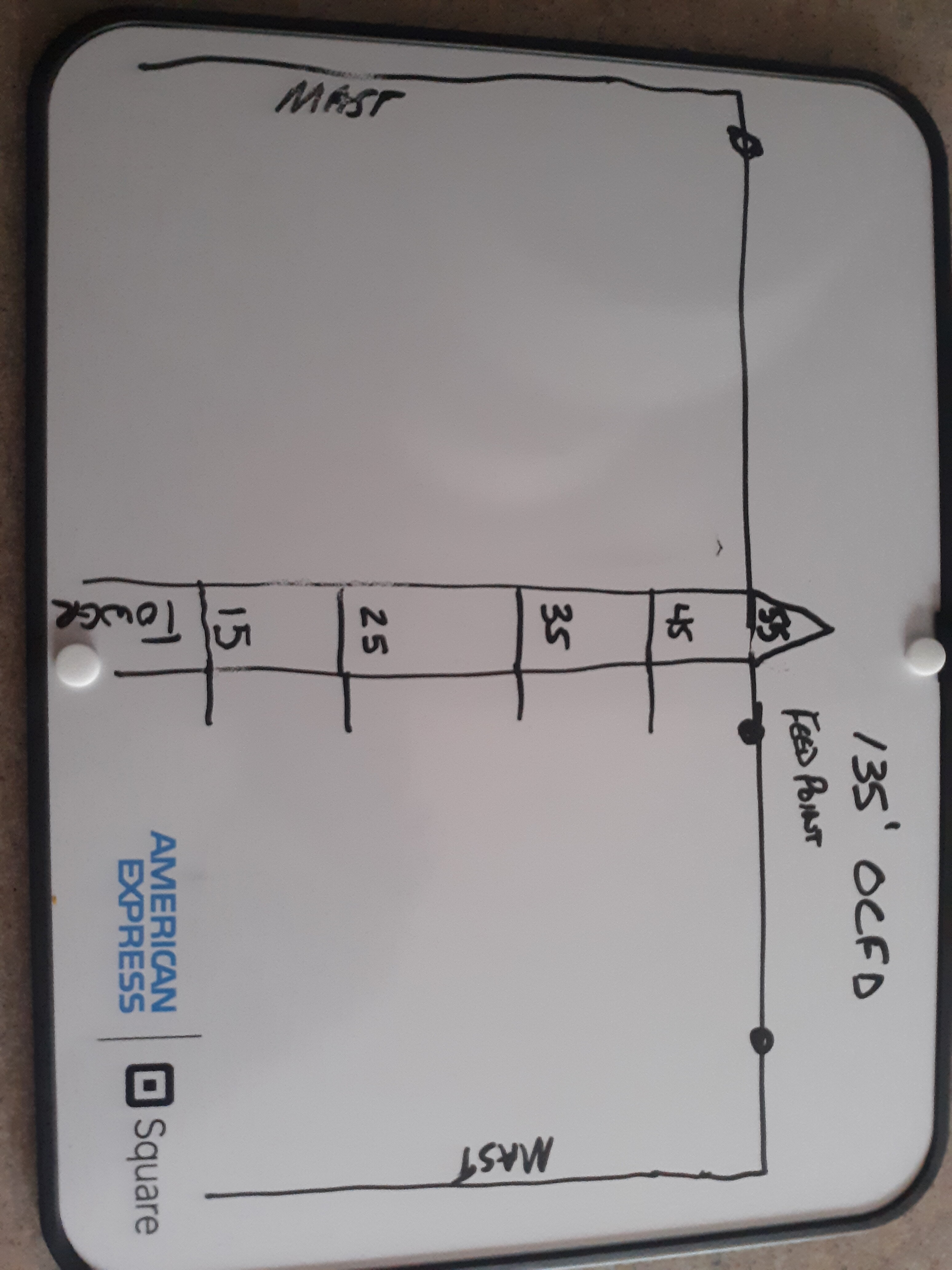

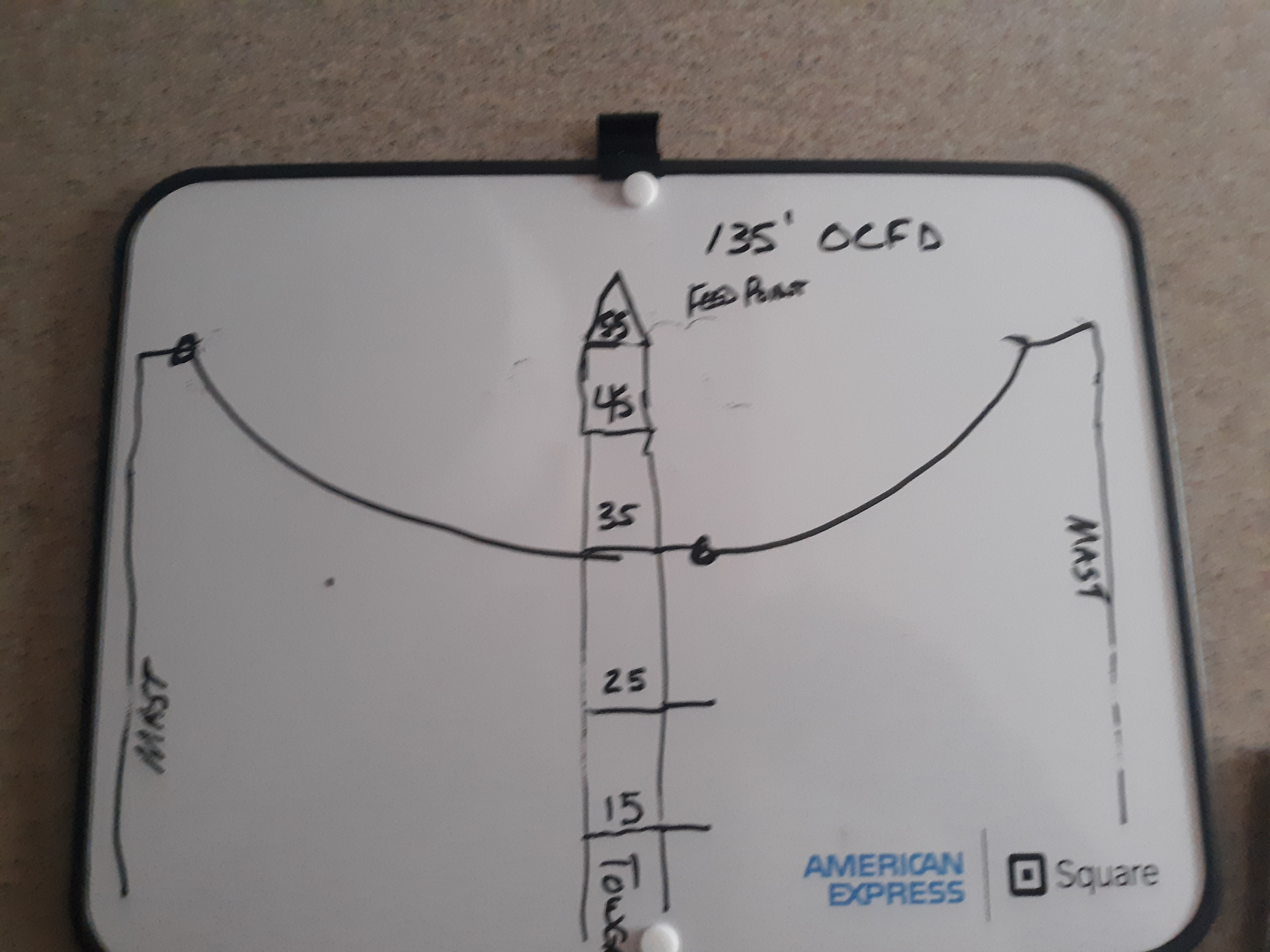

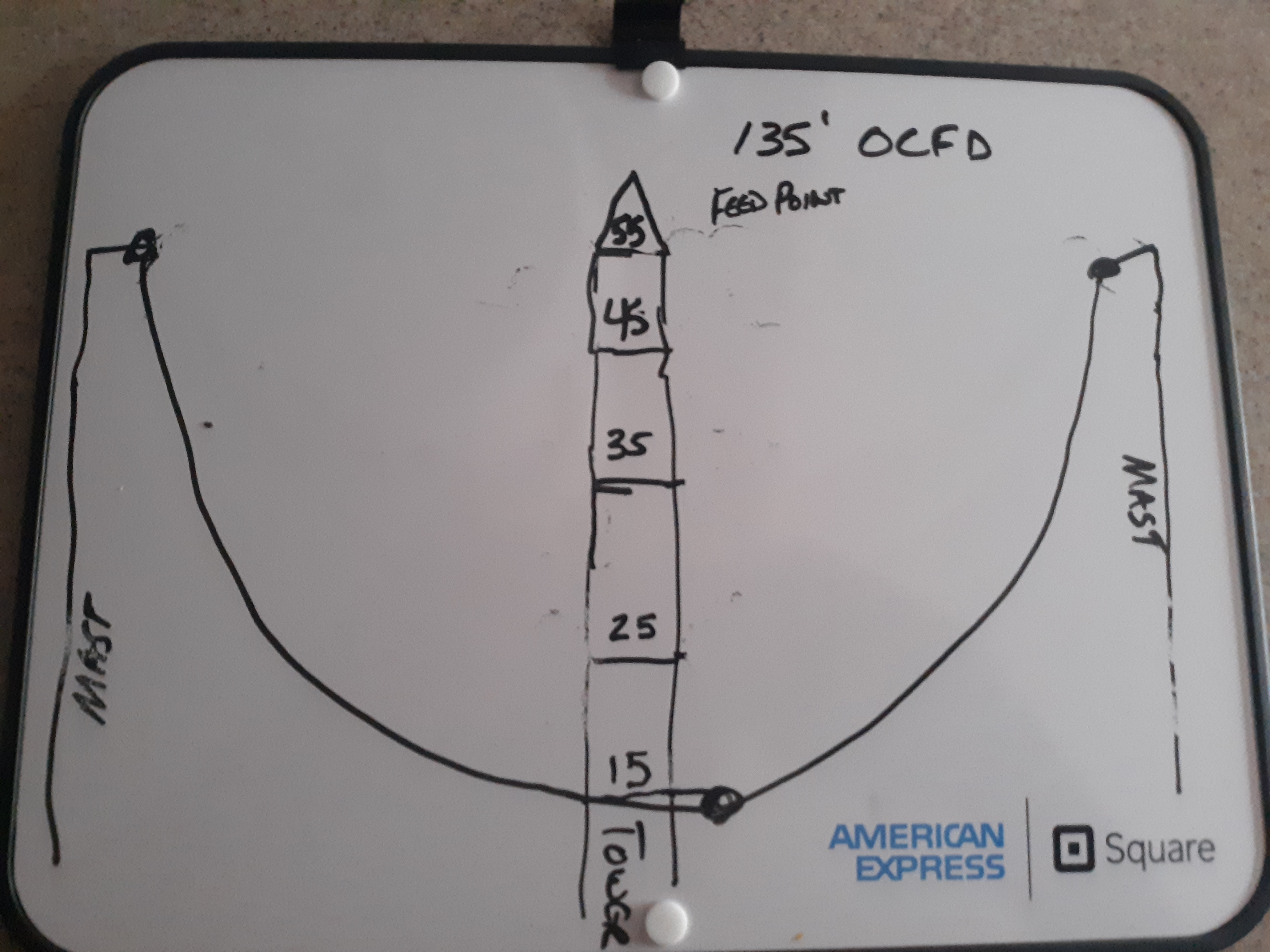

I run a 135ft ocfd that's a flat top at 55ft above ground to the feed point unun. The ends are adjustable as is the feedpoint on height.
As I lower the unun the ends will either drop or they will for a right side up vee shape. As I raided the unun it mors more toward a flat top.
I orig was wondering if anyone had played with the height of the feed point/ vee shape in comparison to any other shape, like a flat top or inverted vee.
I am thinking I can leave the ends and raise or lower the feedpoint to make adjustments in height so nvis will be more possible or dx will be more possible when its higher. Like rf gain by height, haha. But all I've ever seen is inverted vee, i assume because of the feedpoint impedance issue. But each band will be different too so it's just an experiment
This is a fair idea of what it does as I raise or lower. It's what I'm wondering about. If it can be helpful to be able to raise and lower while using it to increase nvis or dx or limit trash interference.
