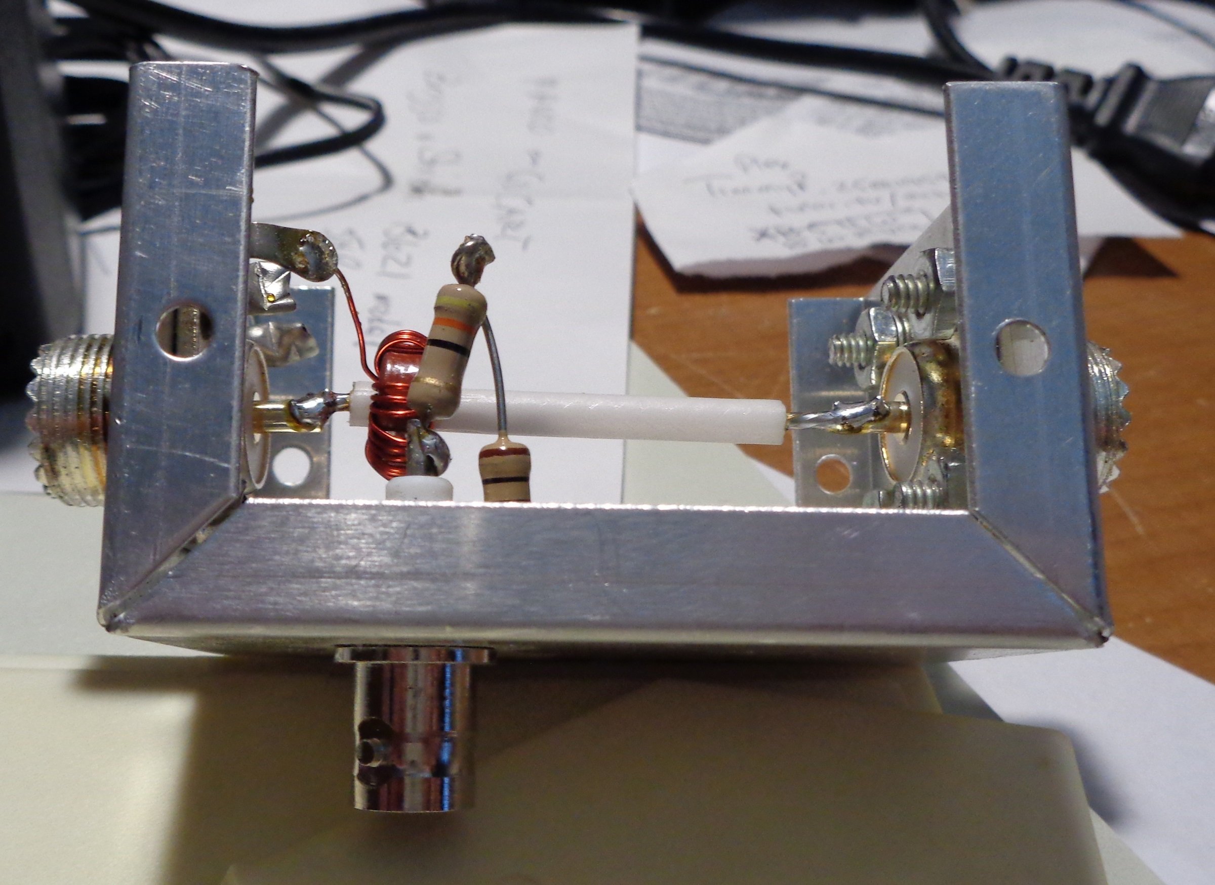

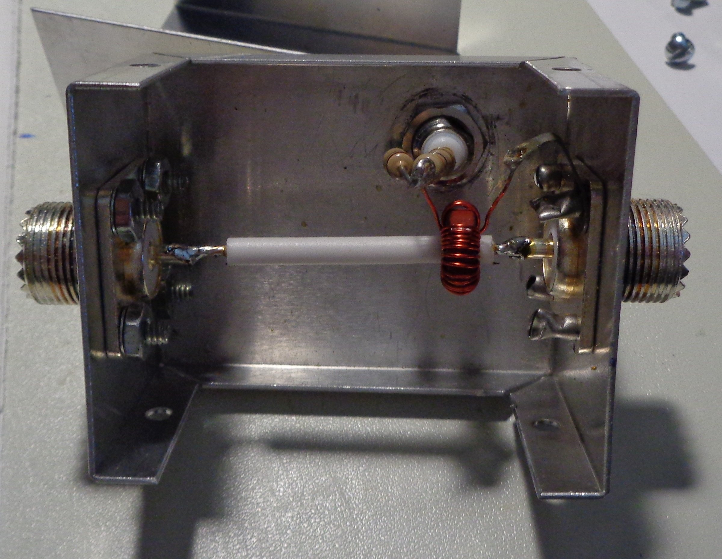

This is the RF Sampler I built. I had a couple of chassis mount SO239 and an aluminum project box and BNC connector already. I just had to buy the torrid. Works well.
Same thing with a different torid: https://www.n4ga.com/50db-hf-rf-sampler/

the absolute cheapest RF sampler you can build?
well, it may not be fancy, but you can wrap a few turns of insulated wire around the wire going to the antenna jack of the radio and attach a scope probe to each end of the coil that you made.
