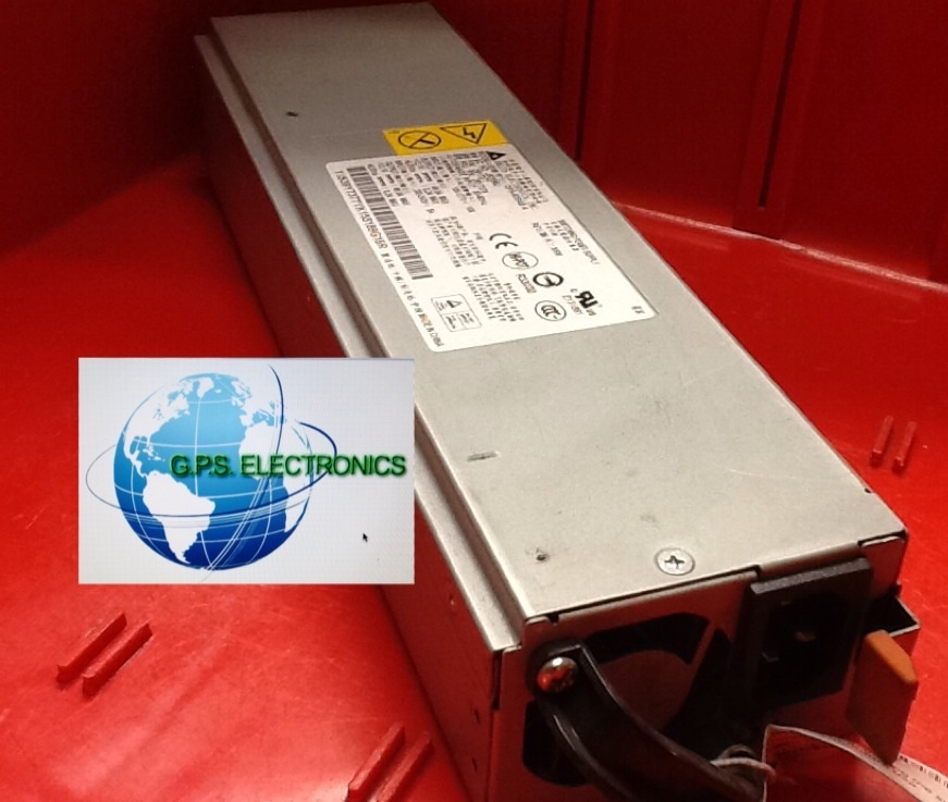

Get a computer server power supply off eBay. Get more for less than buying any off the shelf unit. 50 amps for 15-20$. How does that sound?
http://www.rcgroups.com/forums/showthread.php?t=1292514
http://www.ebay.ca/itm/Delta-Electr...995?pt=LH_DefaultDomain_0&hash=item3a9aca85f3

I went down the path that KM talked about. 43 amp 12.8 v for about $15. I switched it and set the voltage to 12.8 vdc. works great and I have not noted any hash yet.
