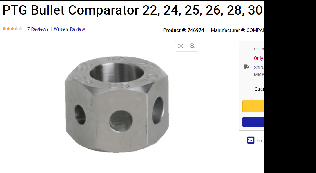

What I have found to be a little easier for me is the bullet comparator. Have use this one for many many years now. It works off the ogive of the bullet.
There are two of these - they both cover several calibers.
