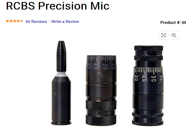

This is one idem that I have been using for the last 20 yrs or so - they have been well worth the money. My first one cost me $18 now they are around $60. These mic's check the head space on the casing.
I have 7 of them for different calibers.
The picture I took from a web site, made it easier then having to get camera out.
