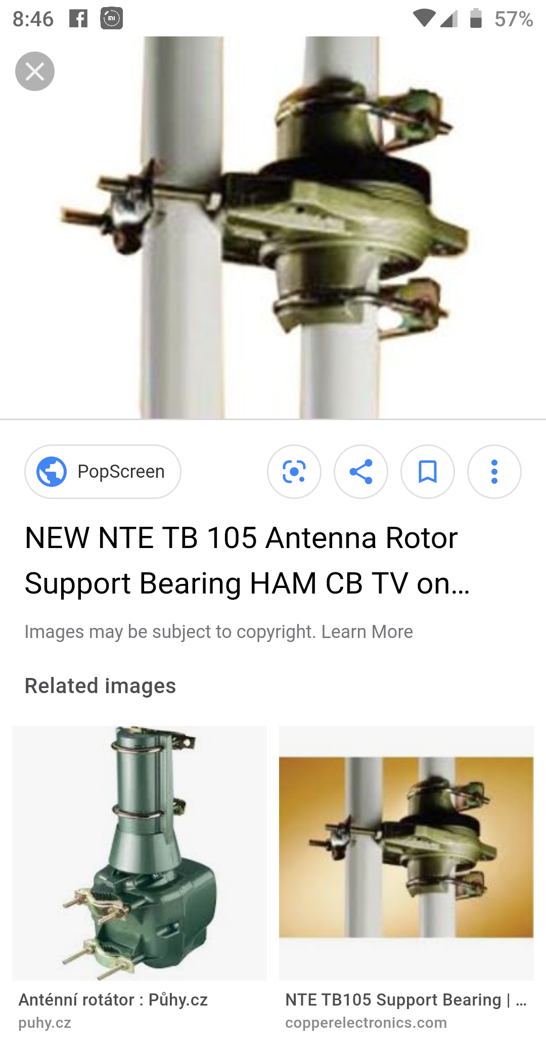

I believe it's a TB-102

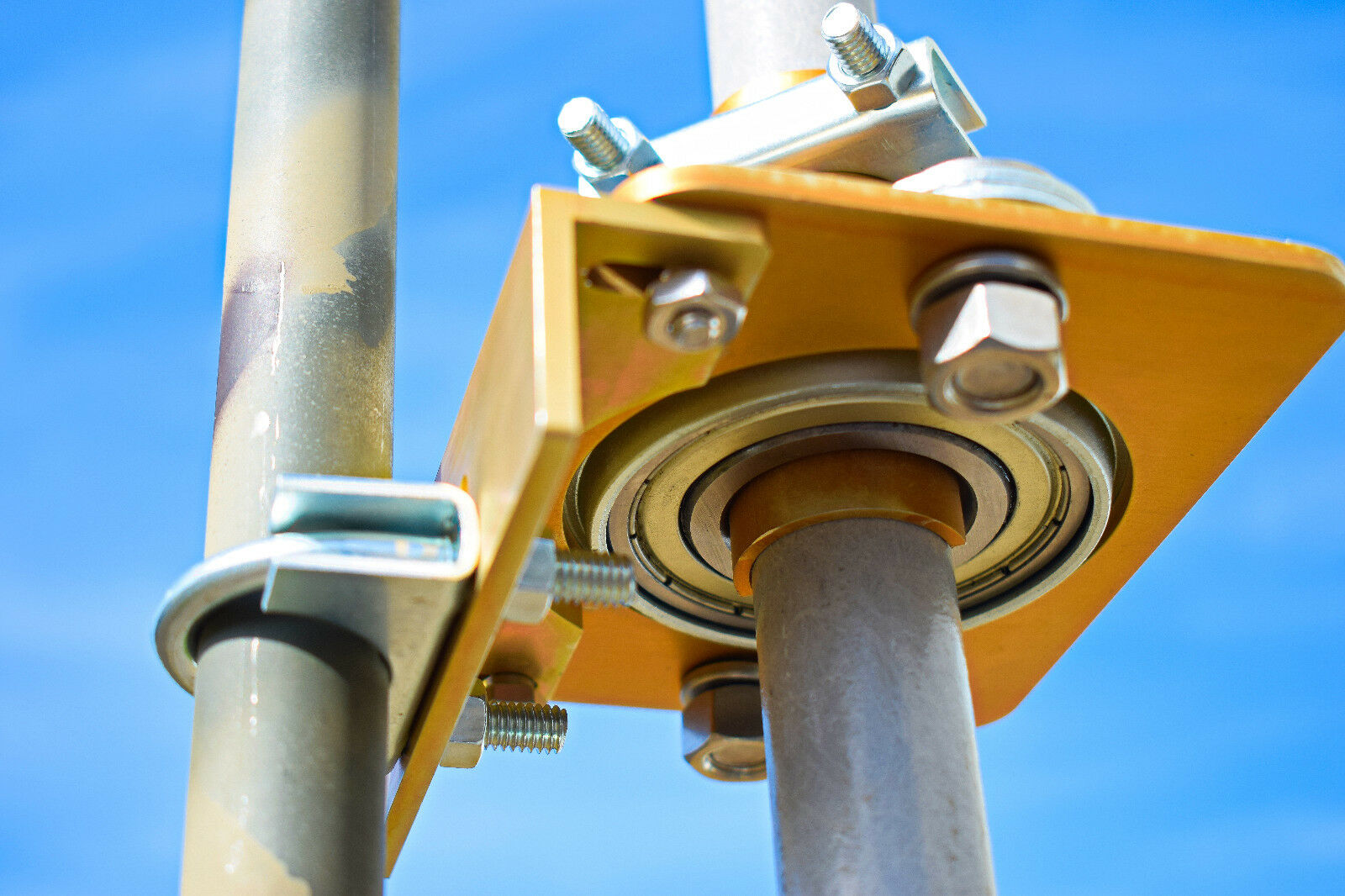

Anyway, I need one. I used to have one, but sold it. I've searched, but no luck. Hard to find.
Here's a picture.
Amazon shows the TB-105 bearing, but , "currently out of stock." Most places I looked said out of stock or discontinued.

They've been out of stock for along time. I needed one for a project about 8 years ago and couldn't find one. Got lucky and found a NOS on ebay. It worked great, but sold it like a dummy. Sorry, but the Yaesu bearing won't work. The UTg105's work great as they allow a higher height above the rotor. Solid Signal doesn't even stock them.

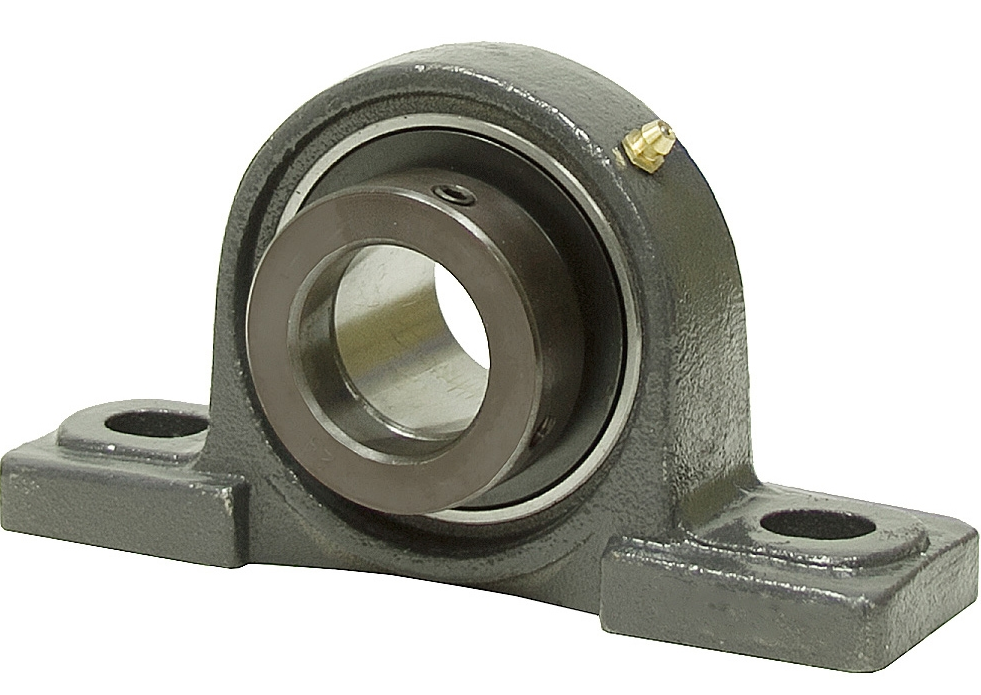

Are you looking to take the vertical load off of the rotator, or lessen the radial deflection that the rotor has to handle ... or both ?? If a mast-mounted thrust bearing is not commercially available, you can make a suitable substitute using a pillow block bearing with a lock collar.
This would absorb all radial deflection, and could provide additional vertical support without suffering damage. Easily mounted to a small metal plate and held to the mast with suitable muffler clamps. Probably not too expensive. Just a thought
- 399
That has potential. Just looking for lateral support. I believe that would work well. Certainly easy to fab up a plate. Thanks for the score.

I was thinking about just such a bearing. The one you pictured looks like it has set screws to clamp onto the shaft/mast.
Could you not use a thrust bearing bolt onto a chunk of angle iron with a muffler clamp securing it to the support pipe?? Just a simple idea.
