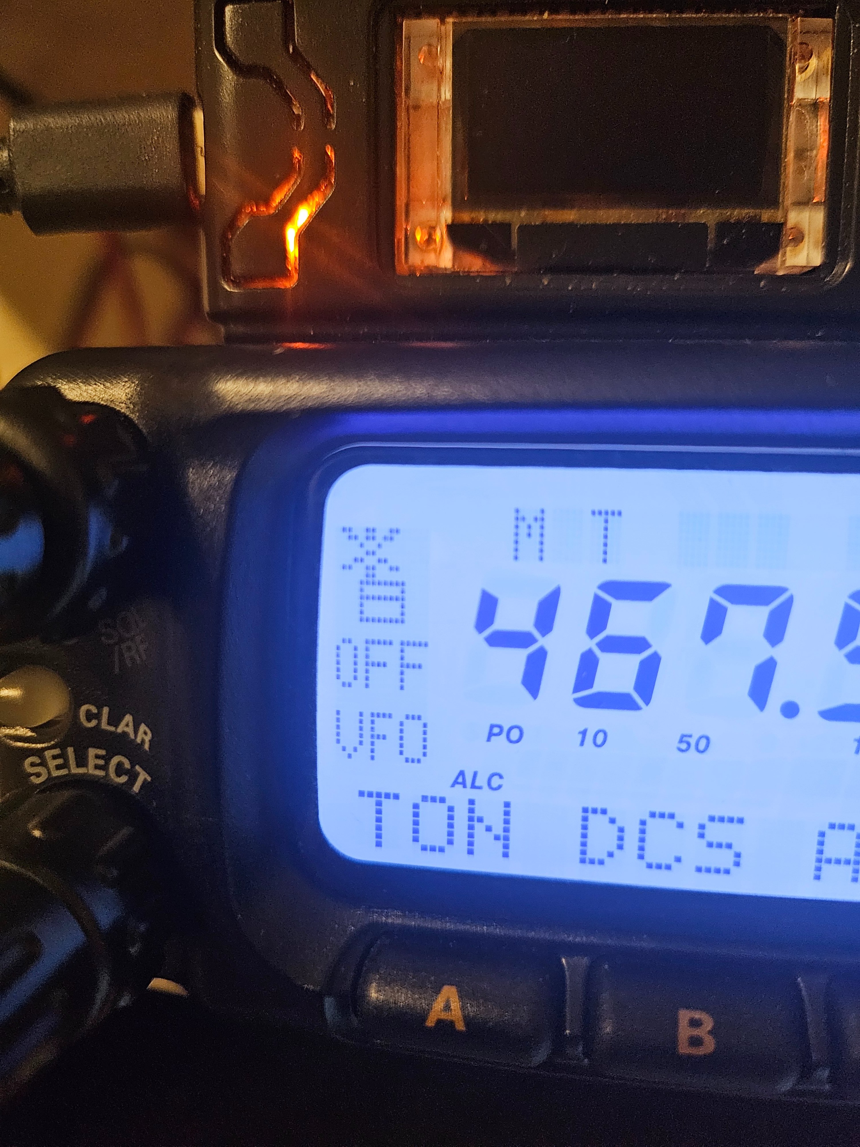

The one I cant figure out is it wont transmit on GMRS frequencies. Mod says 420 to 470 I think it was but the display flashes "off" when I try and grab a repeater up there. And I can find nothing on the web about it...
this is one strange mod.
