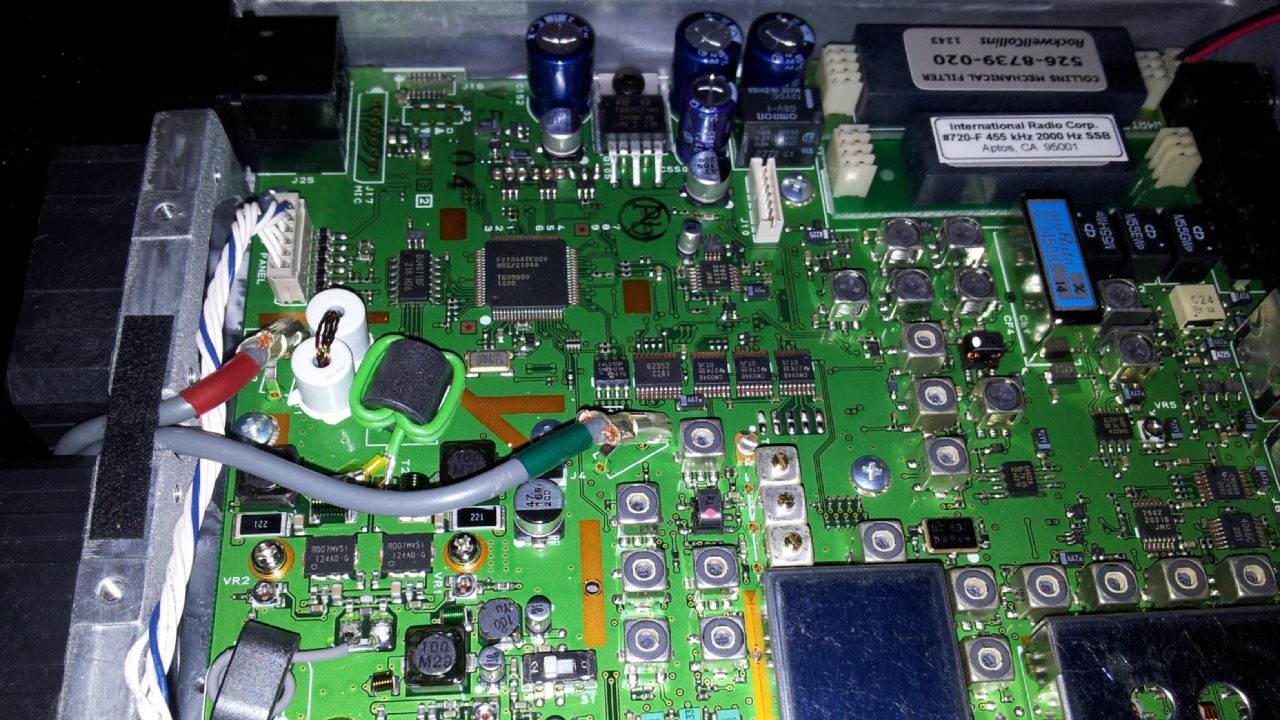

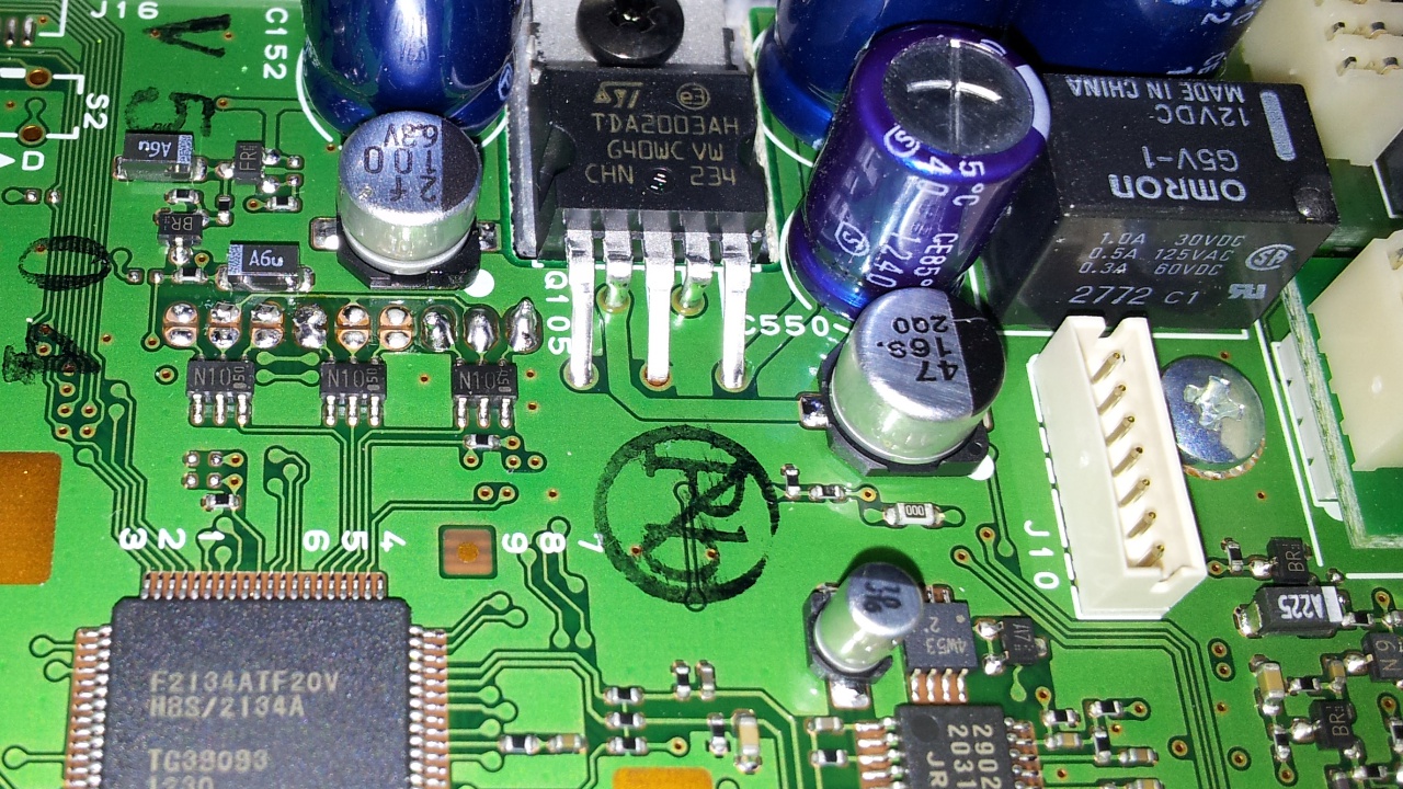

Yaesu FT-857D FT-897D 857 897 Frequency modification expansion
tx is 1.8000 -56.0000 , 137.0000 - 164.0000 , 420.0000 -470.0000
rx you also get 118.0000 - 137.0000 , 76.0000- 108.0000 and .100 - 1.8000
am I missing anything

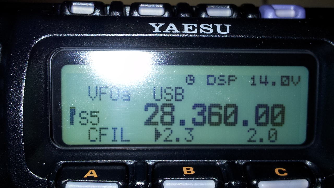

naming filter went smooth pin 1 and 6 to ground on a inrad 2.0 filter rename menu #64 2.0 ..
pics of mod and filter name change
