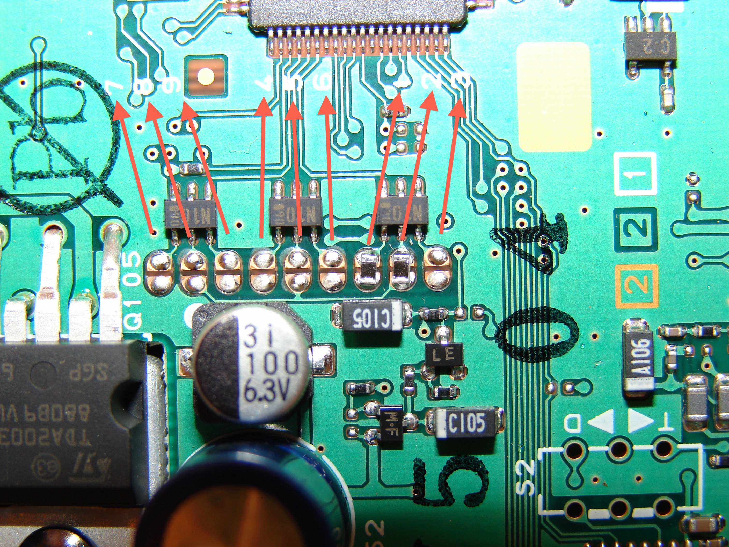

Make sure you have the correct jumpers. They are NOT laid out in logical order left to right as 1 2 3 4 5 6 7 8 9. Looking at the configuration below the jumpers from LEFT to RIGHT in the image are # 7 8 9 4 5 6 1 2 3

I double-checked the jumpers and as per your picture and the Yaesu numbering scheme Captain, I had jumpered (I thought) 7-8-9 and 6 and removed 1-2. I used the strictly left to right numbering scheme when I referred to them before, but anyway I did at least do the right ones... :)
What do I mean by that "I thought"? Well I used the circuit writer pen method of jumpering them and used a soldering iron to remove 1-2. I checked that 1-2 had no connection using a multimeter which showed no connection there which I was pleased with.
But then when I checked the *jumpered* 6 and 7-8-9... Well they also showed no connection... what?!?
I mean I could see the dried silver and the tips of the probes right there on a solid coating of the stuff and still no reading on any but one. I believe it was jumper 8 had a reading but still showed some resistance... Which considering how close it was actually was amazing to me that I could still see resistance.
So now I can clean that stuff off and re-do it or after cleaning just do it the right way and use solder.
Is that what you guys would do? I mean use a soldering iron and melt the jumpers together?
Or do you think I just flubbed the circuit writer method somehow?
I do have an iron with a pencil tip (50 watt) soldering station made by velleman but those jumpers are so small... man.
I should have checked for good connections when I first did this but again, such a small area and they were clean and so forth... oh well live and learn.
So what it boils down to is that the radio probably only saw 3 changes, the missing 1-2 jumper and the new 8 jumper since none of the others showed a good connection.

And just to recap what I actually did on this brand new Yaesu 857D (purchased 8-22-2016) was to unsolder the jumpers 1 and 2 as per the picture provided by Captain Kilowatt earlier. And note that I am using the Yaesu numbering scheme as also denoted in the Captains excellent picture.
And then soldered jumpers 6, 7, 8 and 9.
I then did a complete reset holding the <Func>, <V/M> keys while powering on the radio and holding all of them until it then powered off.
After then powering it back on, I had all bands opened up.
