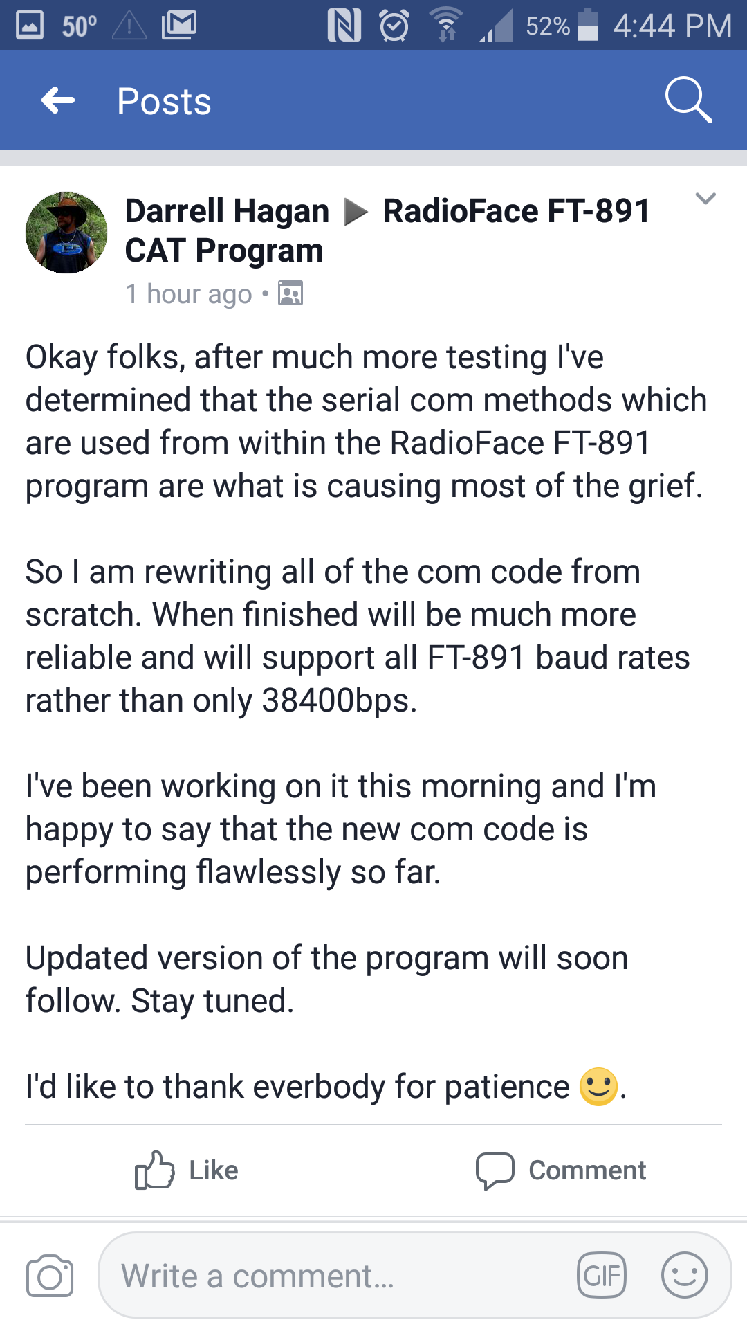

Darrel posted this...
Darrell Hagan‎toRadioFace FT-891 CAT Program
4 hrs ·
Hi everyone, it has come to my attention that some of you are having issues with getting this program to work correctly. RadioFace uses a Microsoft COM control for serial
communication between radio and computer. This method has some apparent incompatibilities with some builds of Windows.
So, I am going to rewrite the low-level comm routines to try to work around this. I will post let you know when the update is available.
Thanks!
Reactions: 2RT307
New updates

Recent Facebook post from Darrell...
Well, we have a problem. New comm stuff for our program is going well but I had a power surge here which damaged 2 of my computers and a router and the FT-891 was hooked into one of them and so now I can't get the computer to recognize the FT-891 no matter what I do (reset radio, hooked to different computer, Yaesu driver properly loaded, etc.) so I can no longer test with it.
Reactions: 2RT307
