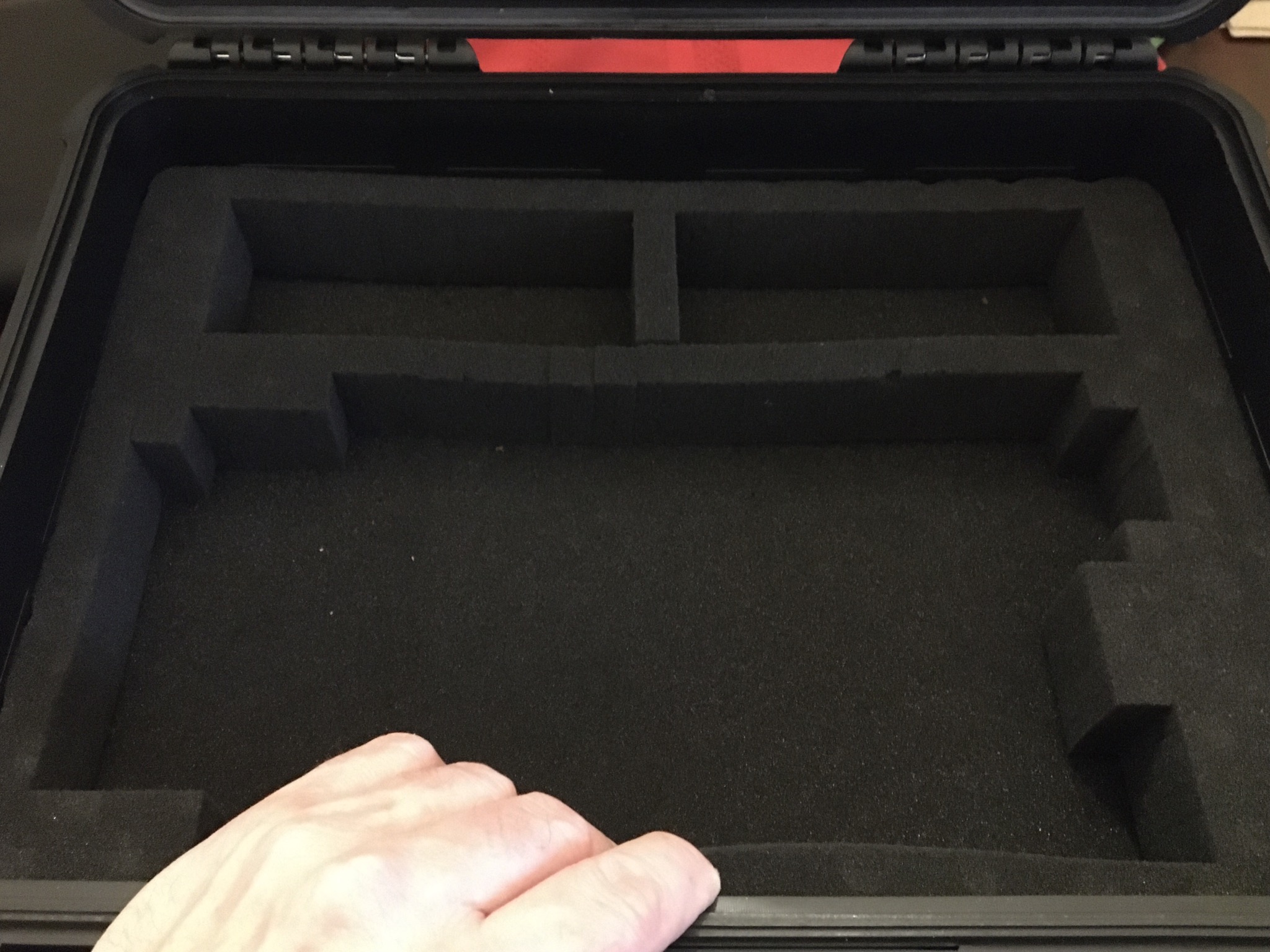

Yaesu FT-891 case options

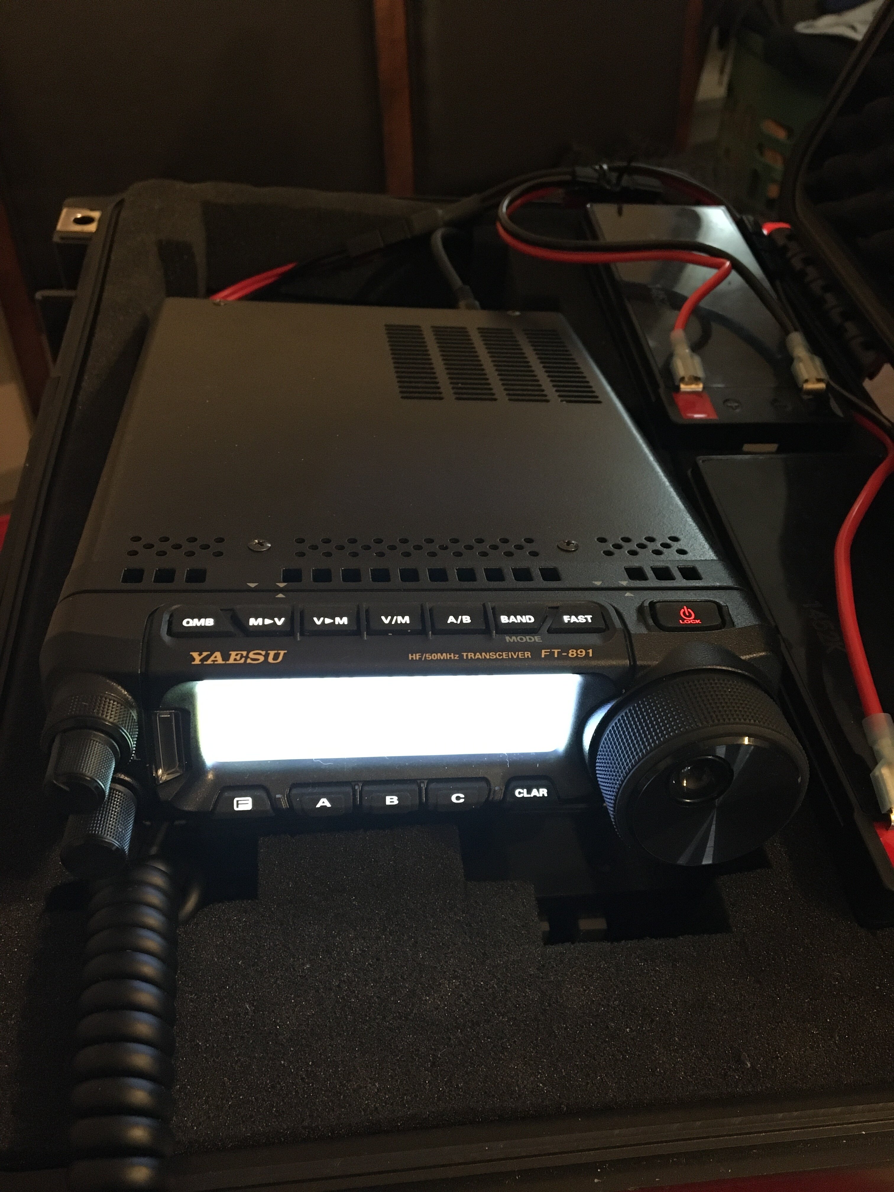

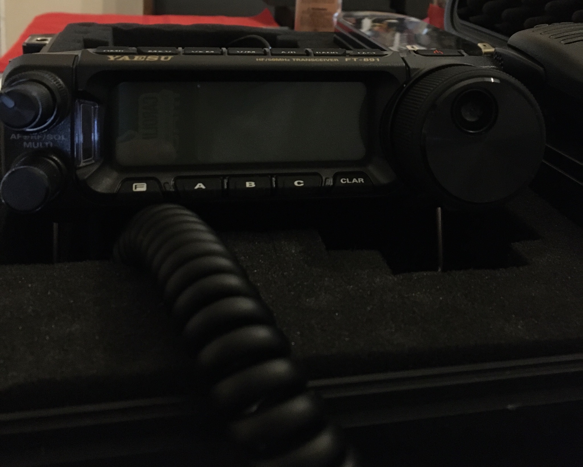

View from end when operating it and leg propped up, and then tuner down in there. Buttons are accessible if needed. Radio works off the radio TNR button so shouldn't be necessary.

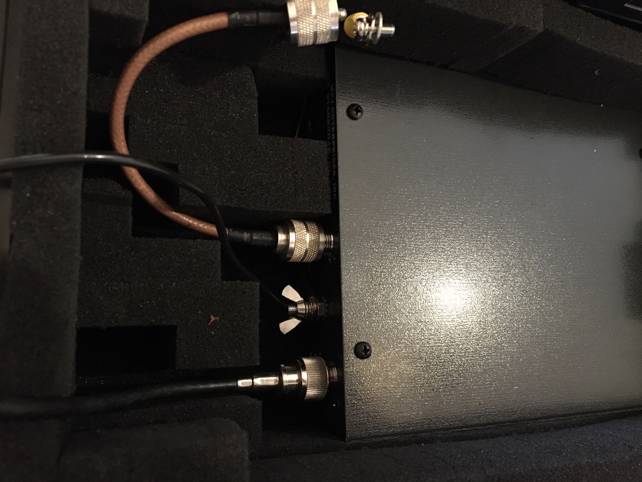

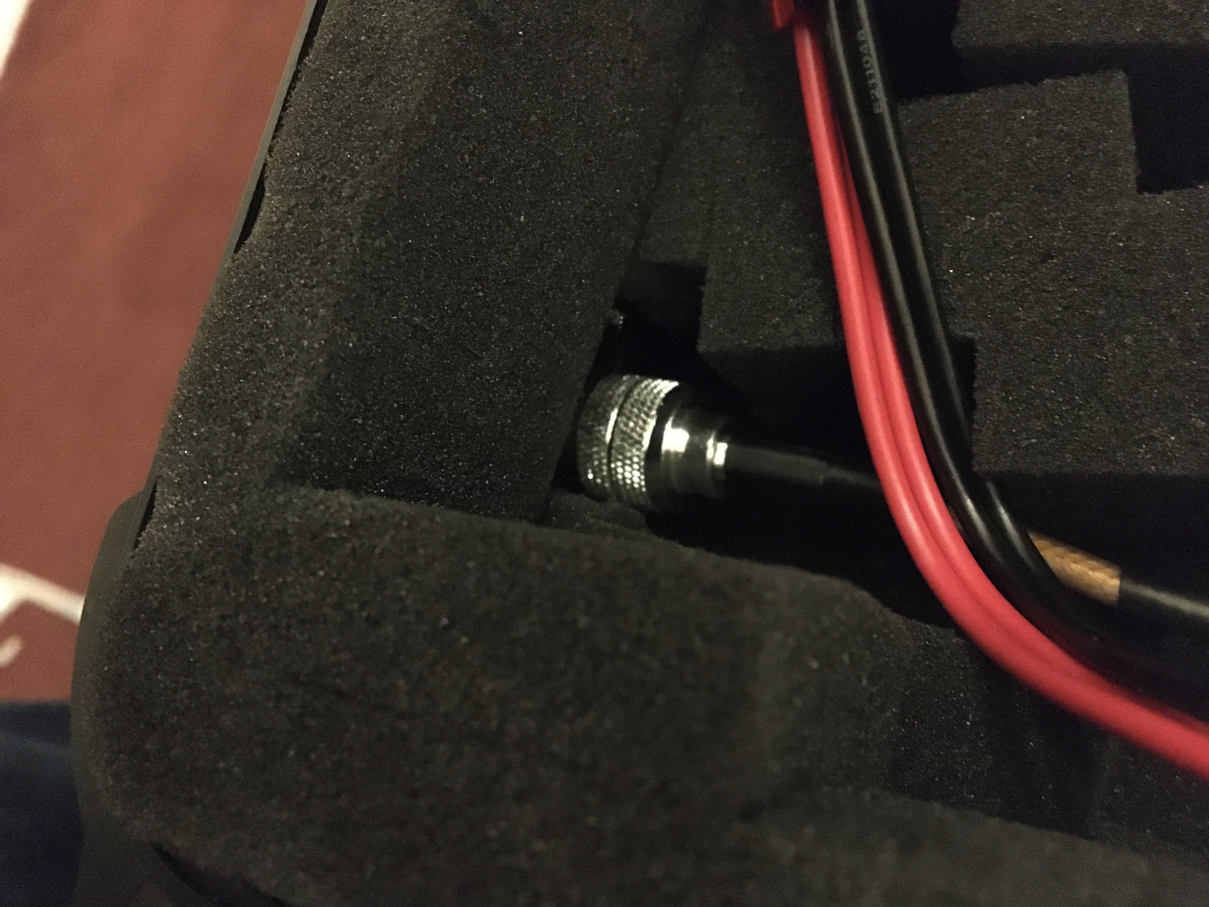

Showing a 30" coax jumper currently in place and other things if missed and the ground wire from tuner to radio.

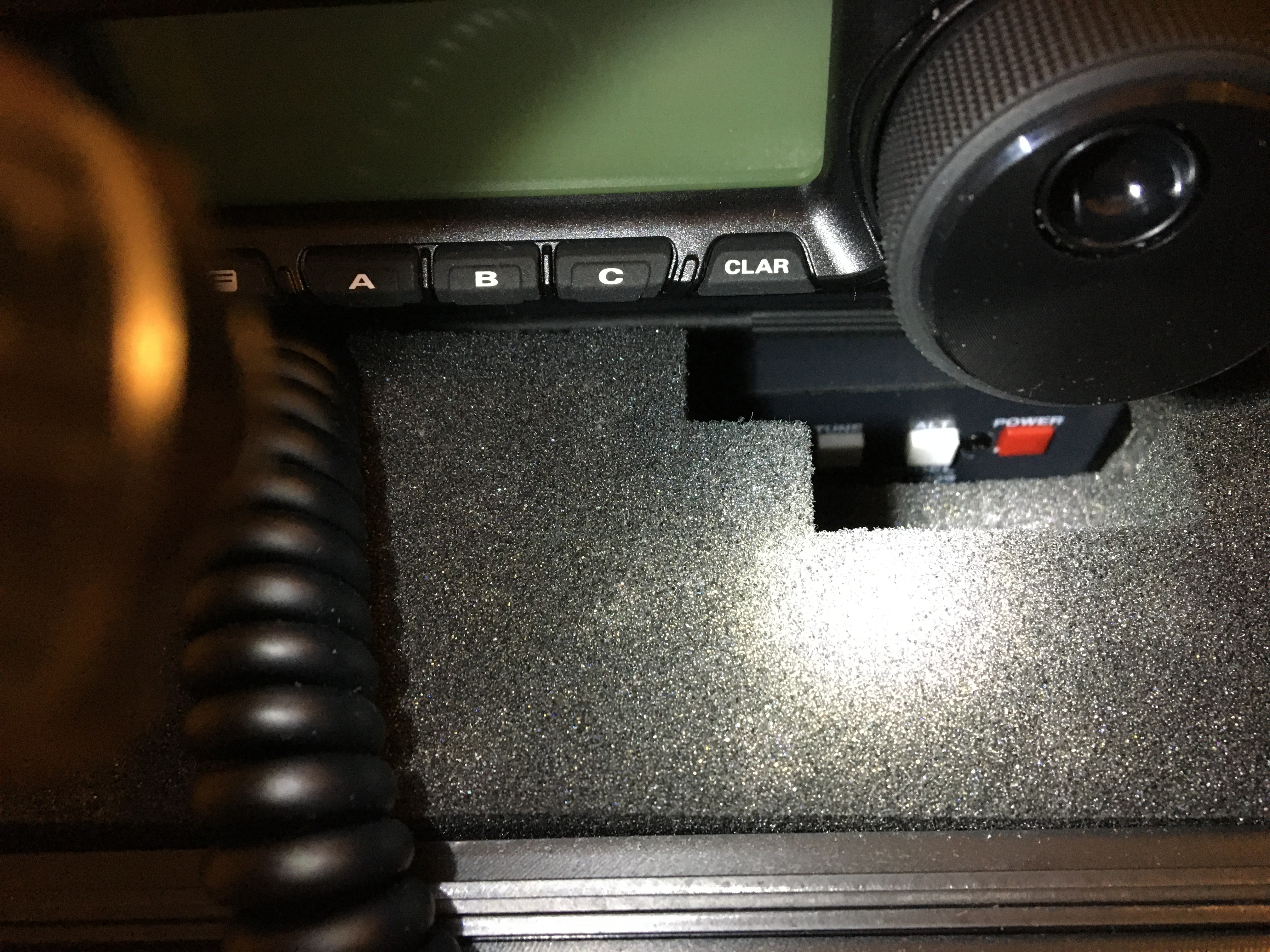

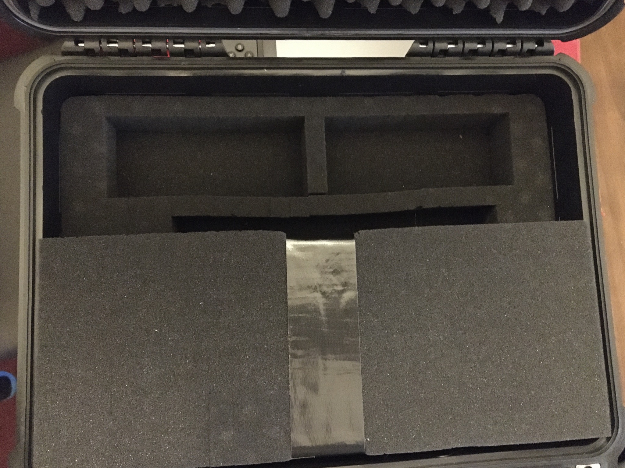

this is showing the tuner level. Radio removed. It's kinda nice the case comes with 2 pieces of foam that are separate so you can let it out kinda in levels.
Reactions: Slowmover

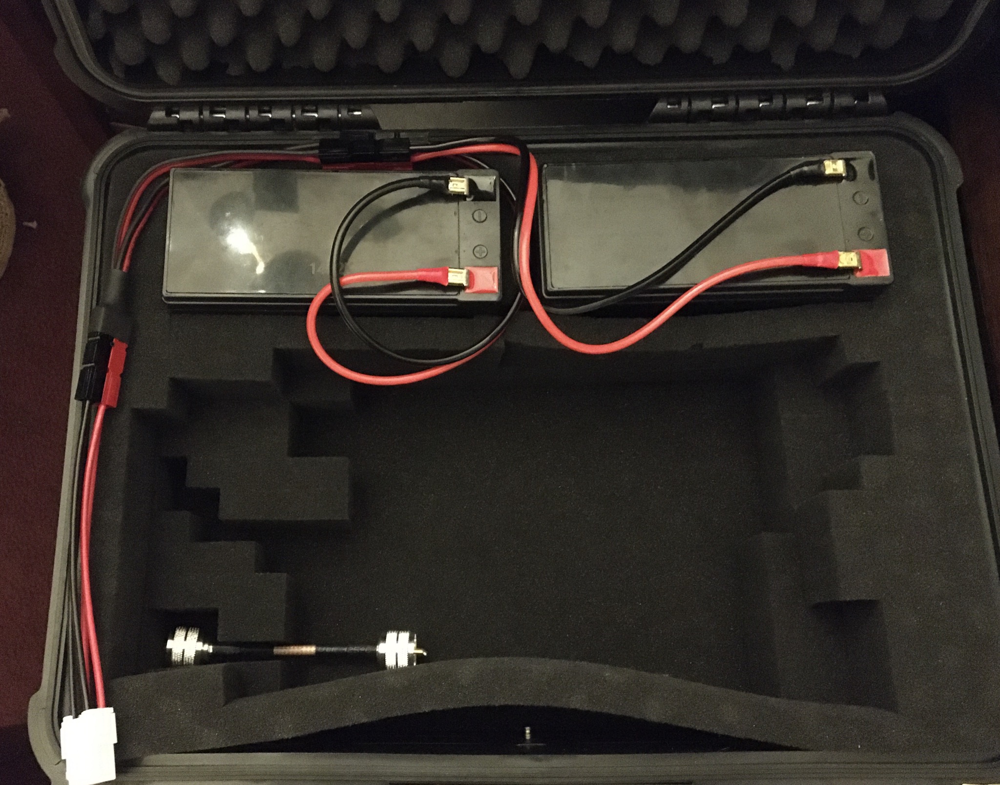

Now. If you happen to run an LDG Z100Plus. I'd say try this. Radio on bottom (as shown). And just strap with velcro the LDG tuner on top. Or mold out the top included padding to fit the LDG and pop the top layer of padding out to run the rig.
2nd photo is extra padding that could lay across the top of the rig at least to keep it inline. Batteries have a 1 1/2" wall and when top is closed shouldn't flip or move.

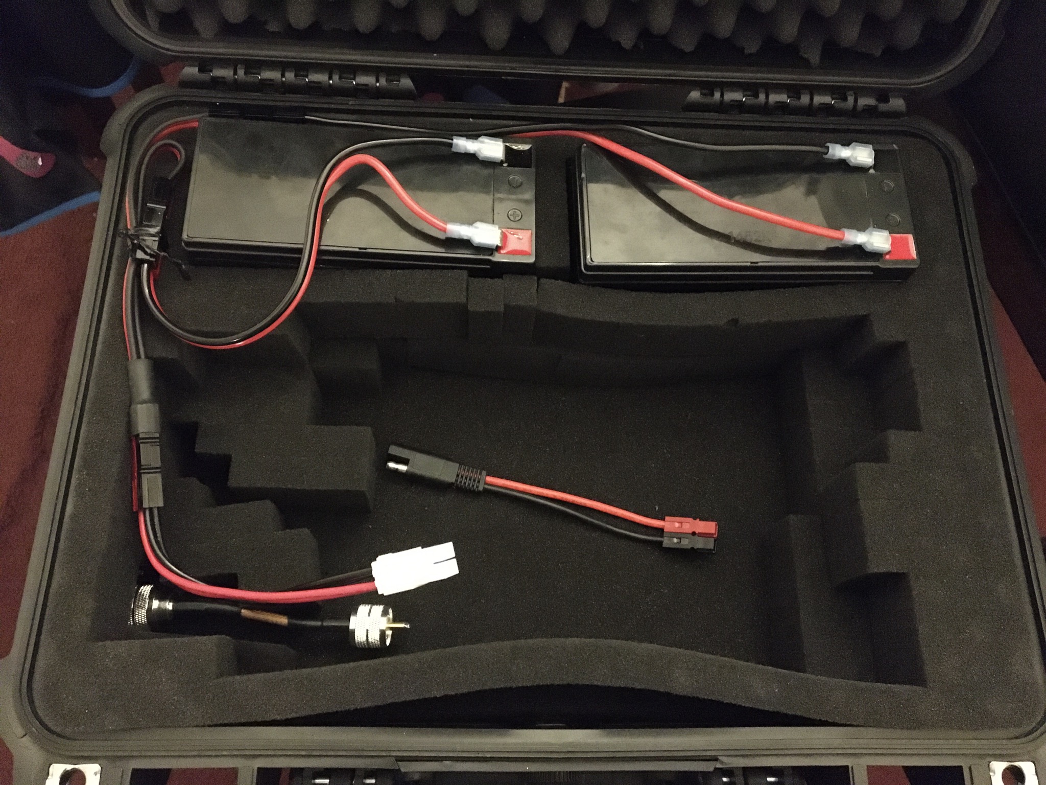

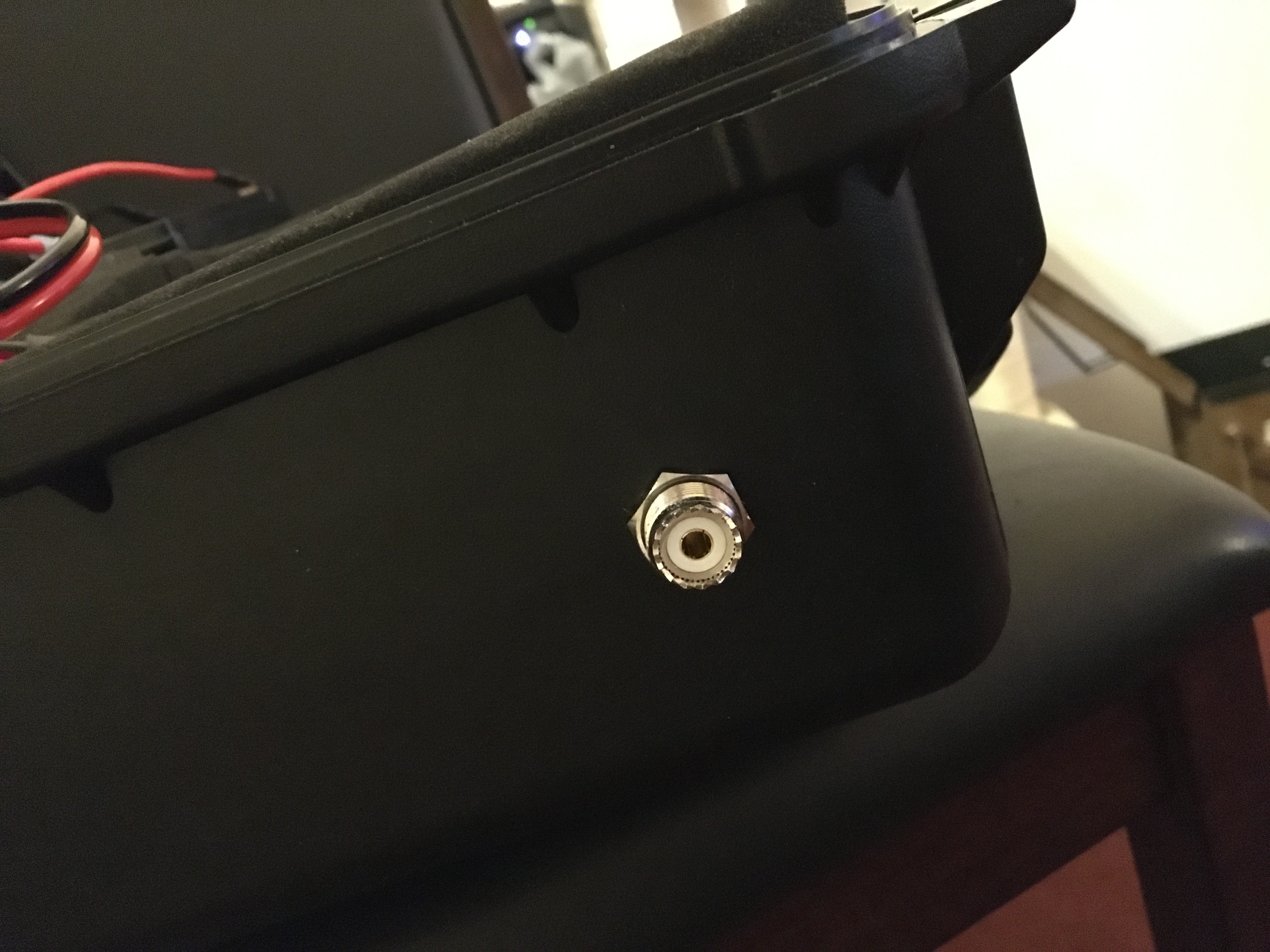

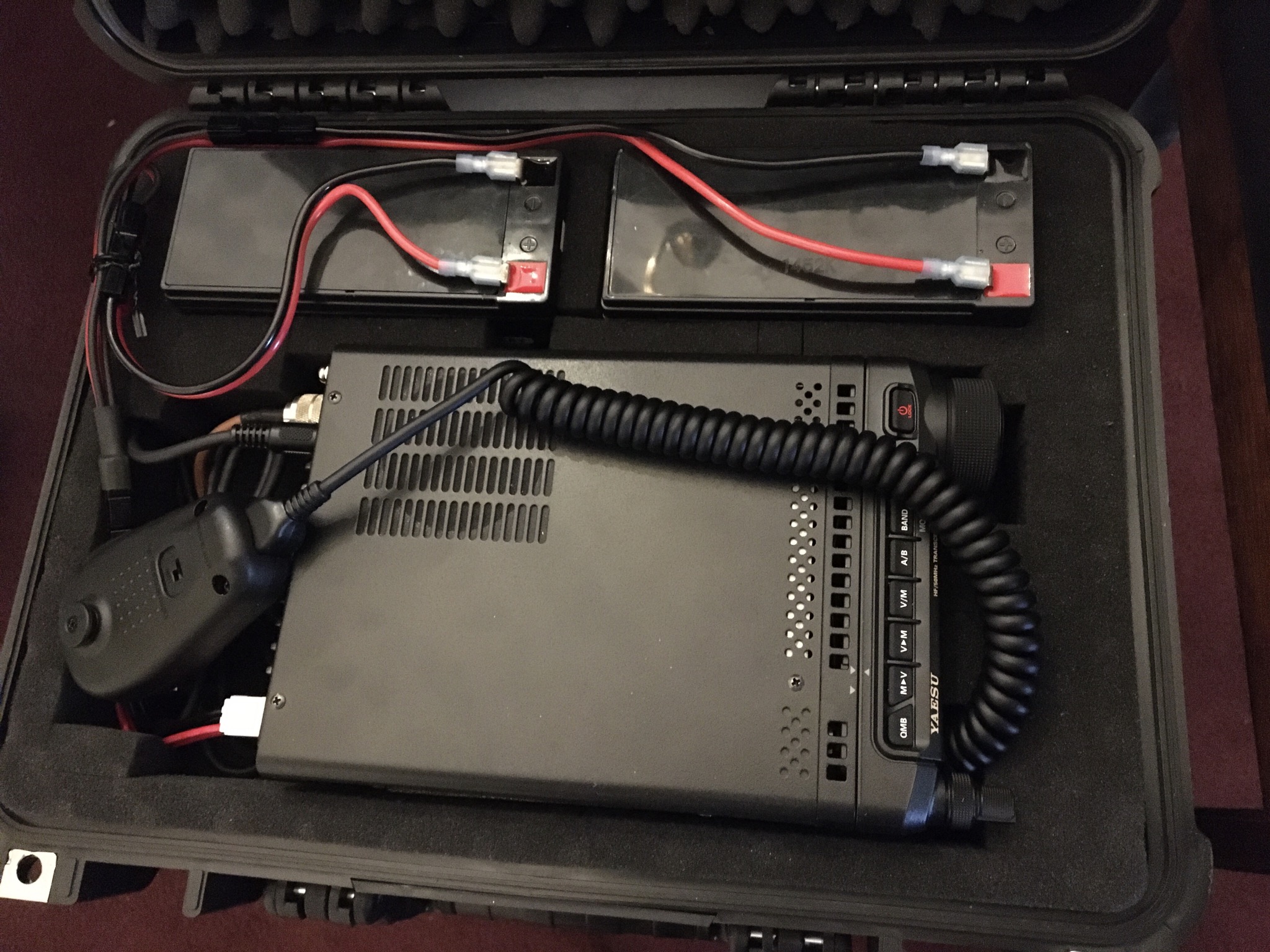

Shortened some wires and drilled the hole for the antenna jack. PowerPole wire in middle is to go to my trickle 3 stage charger. Opted to not drill more holes for anything else's in the case (like a charging port)
