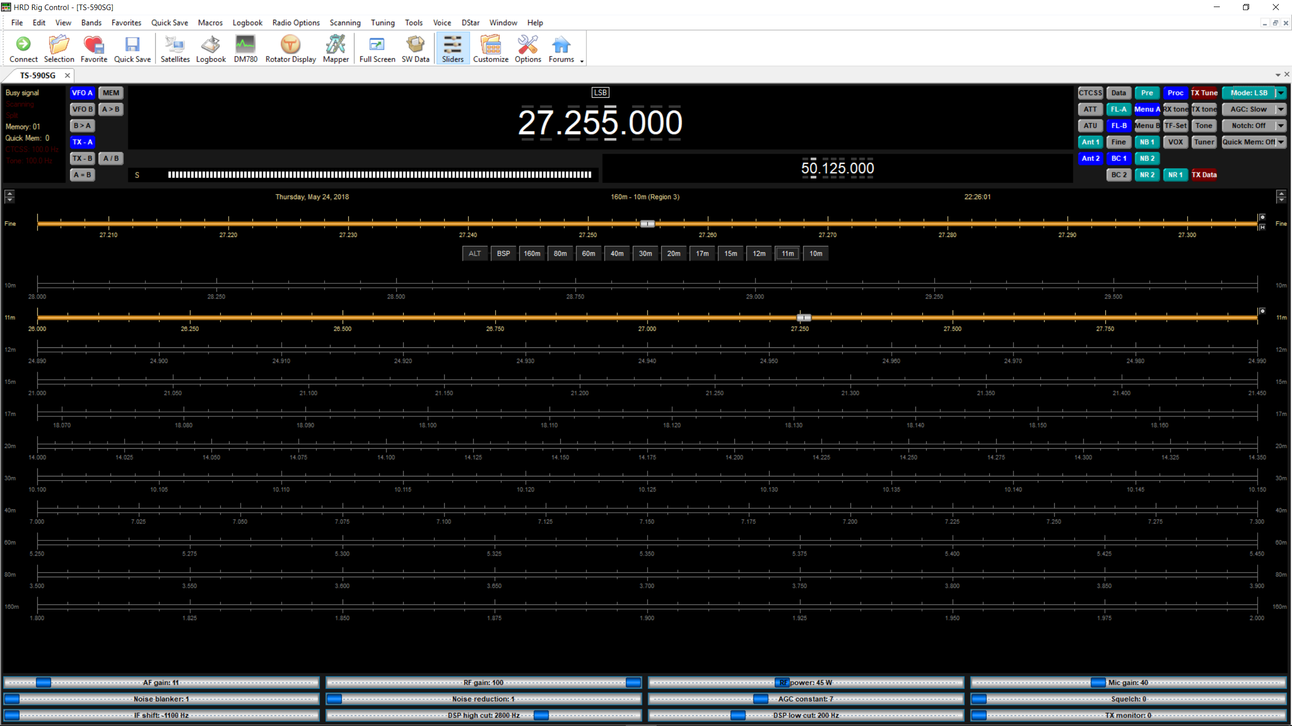

You had me curios so I checked my setup. I have both my 590 and IC-7000 setup on HRD. I have no problem select any mode for any band.
First off, can your radio select any mode on 11m without being on HRD?
On the HRD rig control page, there should be a mode button. For both of my radios this button is on the top right corner on the HRD rig control screen. This will give you a drop down button for mode selection.
Is this mode drop down button available with your IC-7200?
If this button isn't available on HRD by default, you should be able to add it by clicking the Customization icon on the top tool bars, then select the Layout TAB.
Look and see if "Mode" is available to add to the dropdowns list and select it, then drag it over the unused drop down buttons on the customization screen, then hit apply then OK.
There is a Bands tab at the top left of the rig control screen where you can select band manager. I just did this and added 11m so it will show up as a quick select button just below the freq. display.The modes aren't saveable that I can see but at least you have a quick 11m band select button.
I posted a screen shot below so you can see both the mode select drop down button on the top right and the 11m button below the freq. display.
If you need to know how I added 11m to the screen, let me know and I'll tell you know how I did it but I think you can figure it out yourself.
be sure to click pic for a large screen view

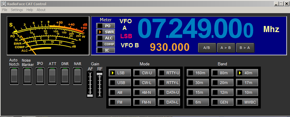

Radio will transmit USB on 11 meters fine, it's when you want to operate LSB. In order to select LSB, you have to fidget around in the menu to do it. Once your on LSB, it'll default back to USB if you touch the VFO. You can save a frequency on LSB into memory as a walk-around, though.
There's a dude that didn't like it, so he wrote his own CAT program called Radioface, that has the ability to select LSB easily. There's discussion of it on the forum. I installed it, but I think it has a conflict with HRD.
Certain owners have been waiting for a firmware update to fix this issue, but doesn't look like it's coming. The radio is still an awesome performer and great rig for the money. No FM, sorts sucks, though. It receives past 6 meters, but not on FM.

The menu needs both sidebands selectable without fiddling in the menu. You could be on 40 meter LSB, then want to listen to aviation frequencies, which utilize USB. To do so, ya' gots to do a menu dance to do it.

Yeah, your right about FM. I had a brain fart and was thinking of my IC-7200 when I wrote that. The Radioface software from K7LZR, works great and easily selects LSB, It's just not full featured like HRD, but it gets the job done. Be nice if HRD threw him a bone for his code, but that'll never happen. QRZ'd crony type hams, boff at my need for easy mode selection.
