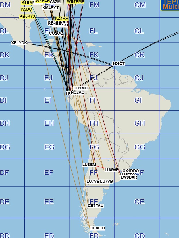

Reactions: Rwb
6m Enhancement due to Solar Storm...
10 States worked since 10:30z...(now 12:30z)
Grids of note: :cool: EL99 / EL88 / EM96 /EM89 / EM70 / EM60 /EM56 / EM48 /FM08 / FM07 /FM17 / FN07 /EN70 /EN80 / EN71 AND STILL ACTIVE...
Cluster lite up with SSB/CW this morning:LOL::coffee:

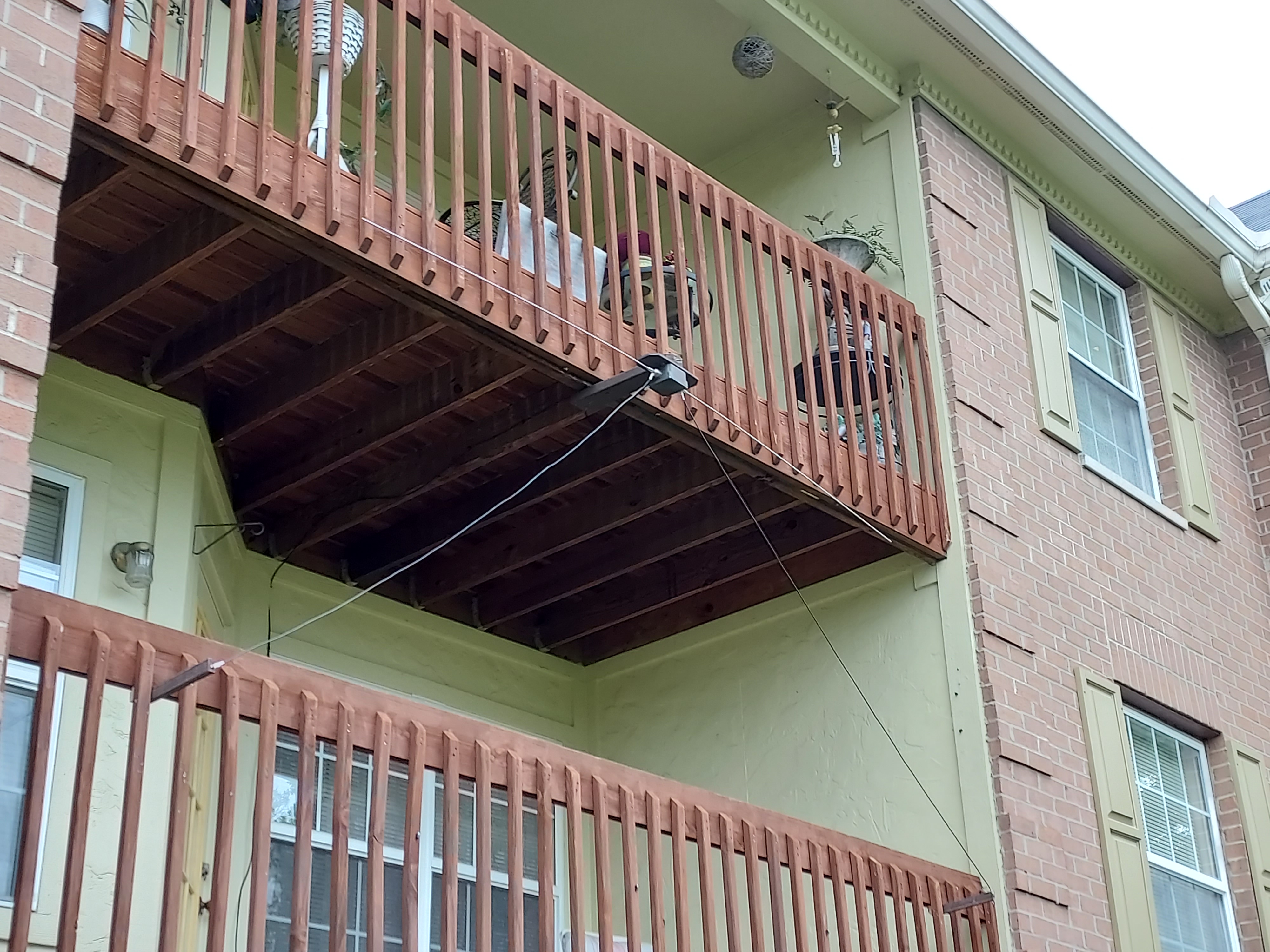

Ok, I have 6m horizontal "legs" added on above my 10m "V".
Looks OK for today, will be tuning the 6m legs a little more.
I know the band is closed but I called anyway hoping to snag a local, no dice. Maybe it'll open up again tomorrow morning.

Work to get the best resonance about 50.150...should be good enuf.... Height for Eship and scatter works best from about 35 to 60 ft....with the "sweet" spot for most seems to be 45-60ft. The op's running at 60-80ft do better for Ground wave(300-400m range) than I. I'm at about 45ft. I can at times out "Hear" many in the 600-800m range. After that it's a crap shot...sometimes I am better, other times others are. That's why they call it "The Magic Band." I have worked attic dipole antennas/Hamstick verticals o_O mobiles, Moxons @ 20ft...even an op in Calgary with a Tarhel bolted to balcony railing 10 stories up in his apartment building. I think, presently I have 46 countries, and somewhere around 140+ Grids Confirmed...more worked but about right on confirmed.
Looking good...Hear you soon.:cool:(y)

18' to the feedpoint will have to do, that's the most I can manage. Beats nuthin.
Thanks for your suggestions Gary. I need a 6m Homer. Hope to log your call.

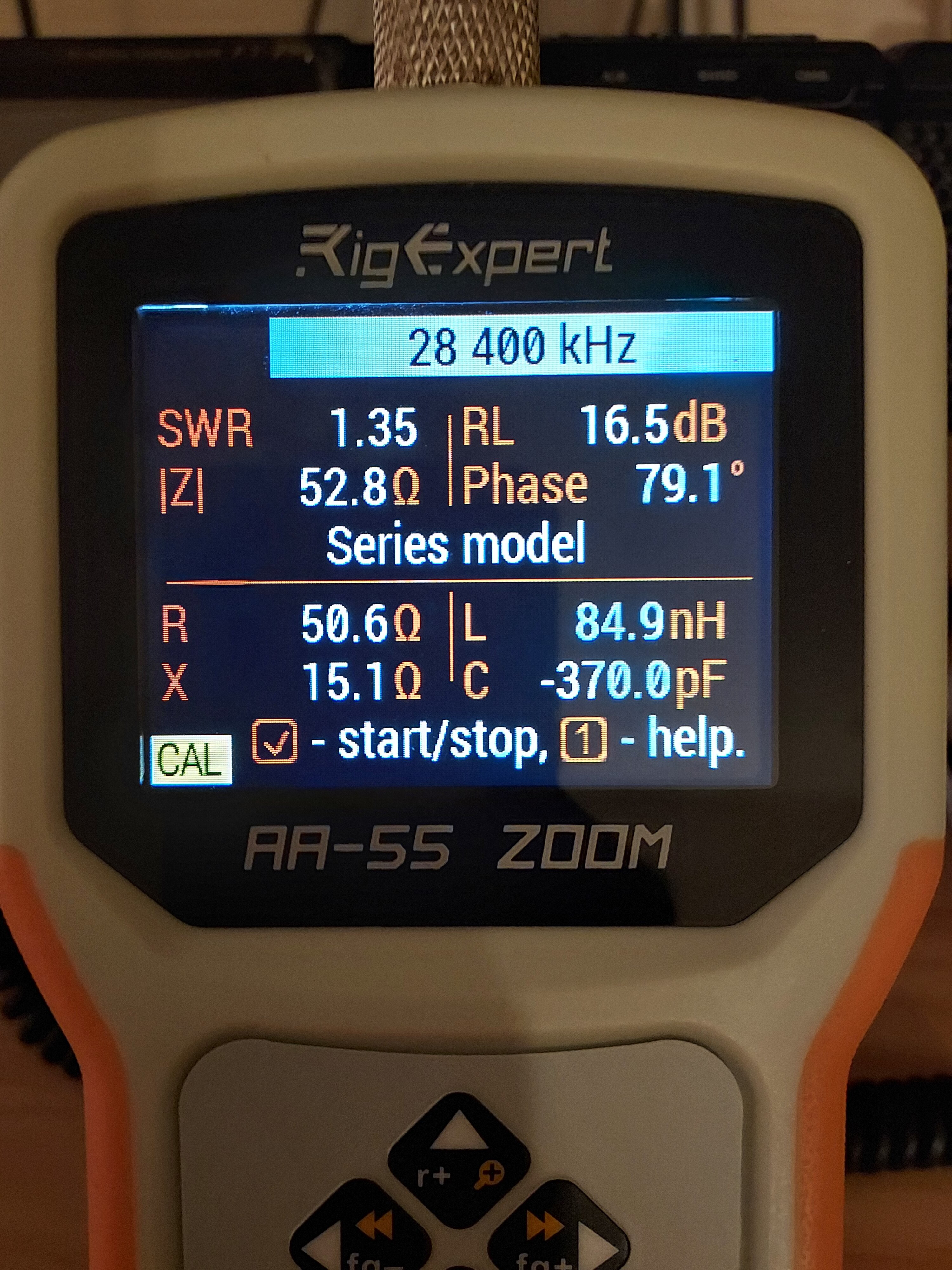

10m Antenna is great...Don't mess with it
Not a chance of that, it works just fine as is. Considering my situation it has done quite well on 100w as my QRZ log shows.

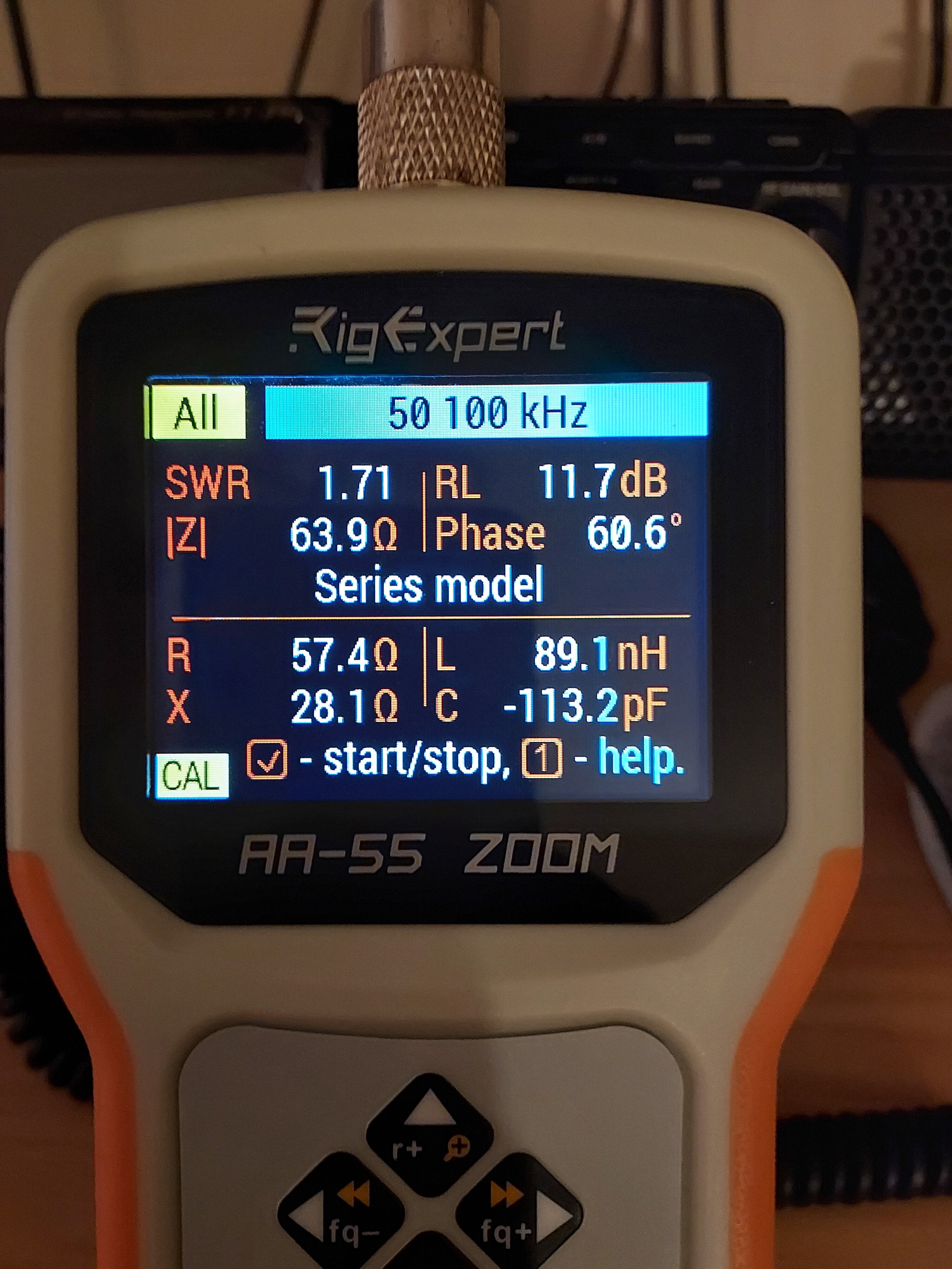

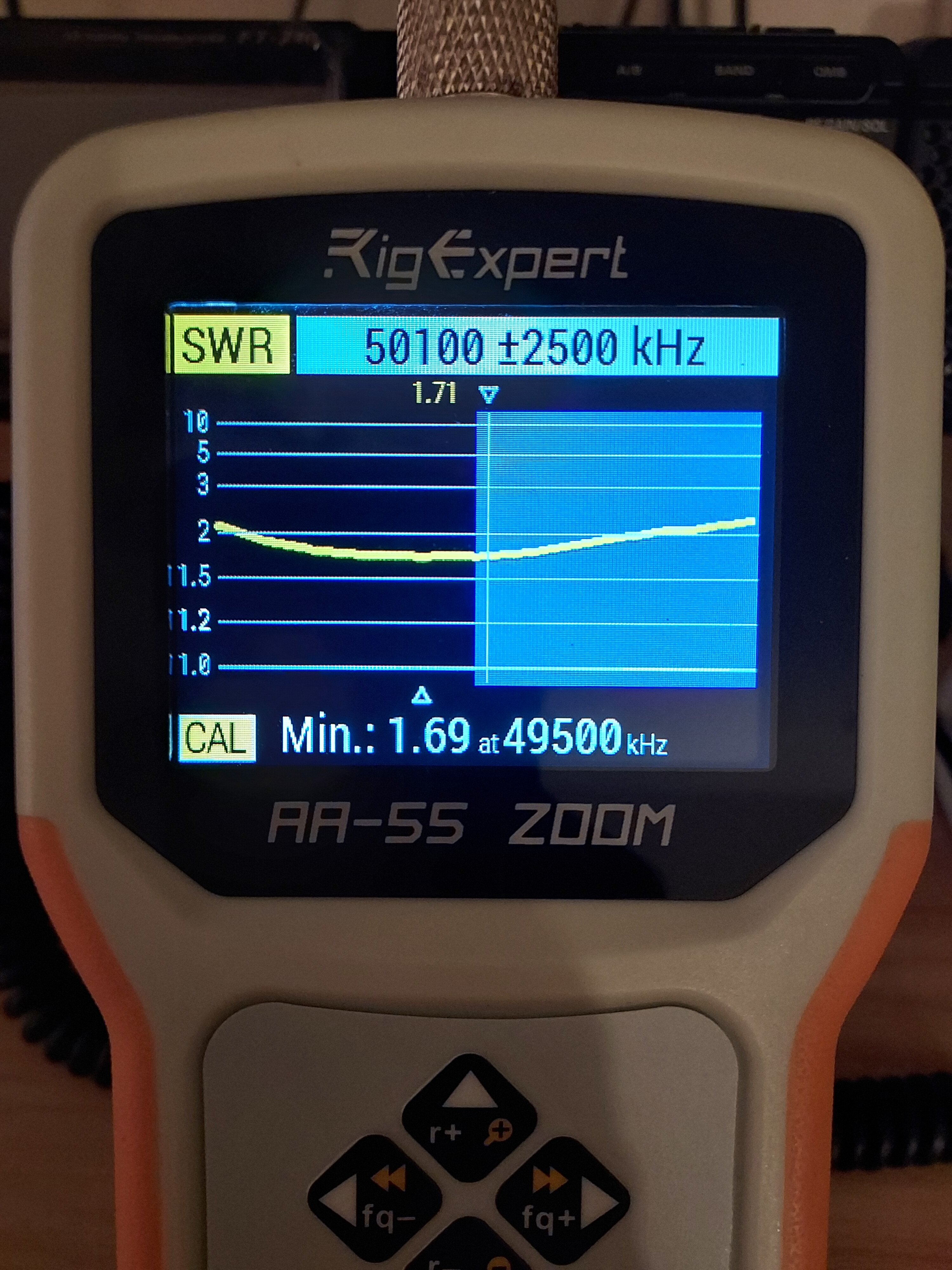

Here's what the analyzer showed yesterday:
I'm sure I can improve those numbers.
