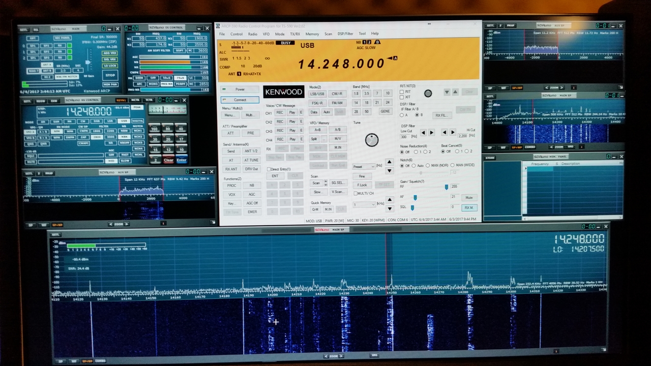

Take a look at the Kenwood TS-590SG. It may not have the prettiest face or all the eye candy but it has one of the finest receivers in it's price range and Sherwood engineering shows it has one of the cleanest transmit signal next to the Elecraft K3.
If you need eye candy and you have a computer in your shack, Kenwood comes with free rig control software (Icom charges $99 and Yaesu has none). Plus for $150, you can easily add the SDRPlay and have a full LCD screen size pan-adapter with mouse clickable waterfall frequency/signal changing with just a USB cable and SMA to RCA adapter cable.
The Kenwood TS-590SG sells for just under $1400 new right now and I have seen used for under a grand.

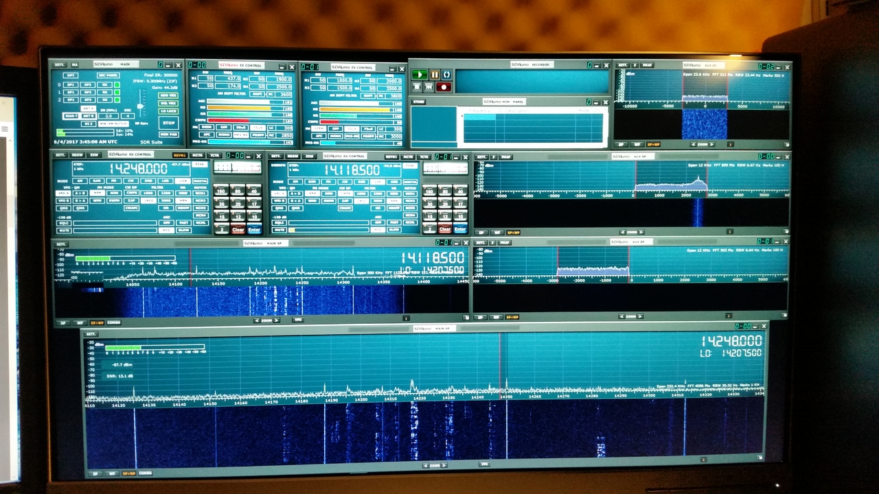

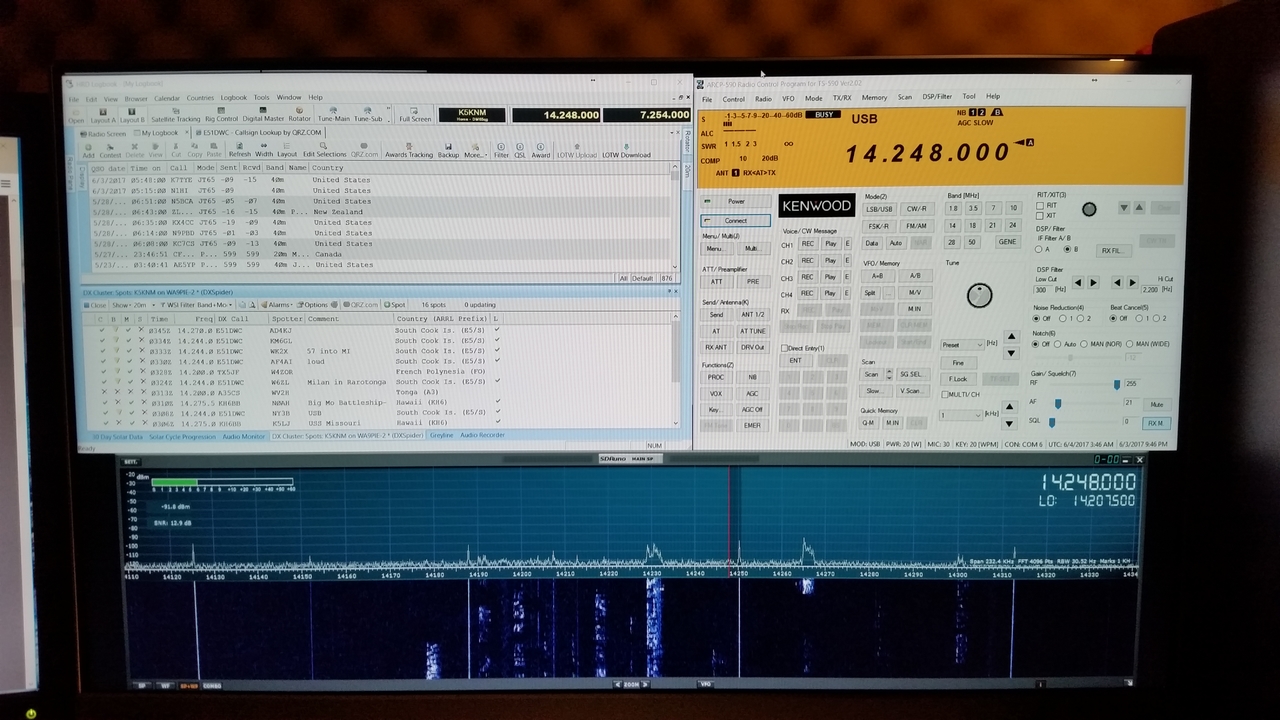

Here is a screen shot of my 590SG's rig control software running with the free SDRUno pan-adapter software via SDRPlay RSP2.
Or run the SDRUno software by itself which has plenty of rig control functions.
The SDRPlay is nothing more than this simple box which connects to the 590SG's RX jack so you still use your radio and existing antenna(s). This RSP2 model has another lowZ and 1 highZ input for another radio/antenna. I have my Icom 7000's VHF/UHF going thru the other SDRPlay antenna port so I can see all that spectrum and beyond. NEAT!!!
I like to run Ham radio deluxe for logging, the Kenwood rig control software for rig control, and just use the waterfall portion of the SDR software to see the whole band. This gives me all the eye candy and techno-geek stuff which is far more versatile than a fancy radio with fancy "LITTLE" LCD screen!
