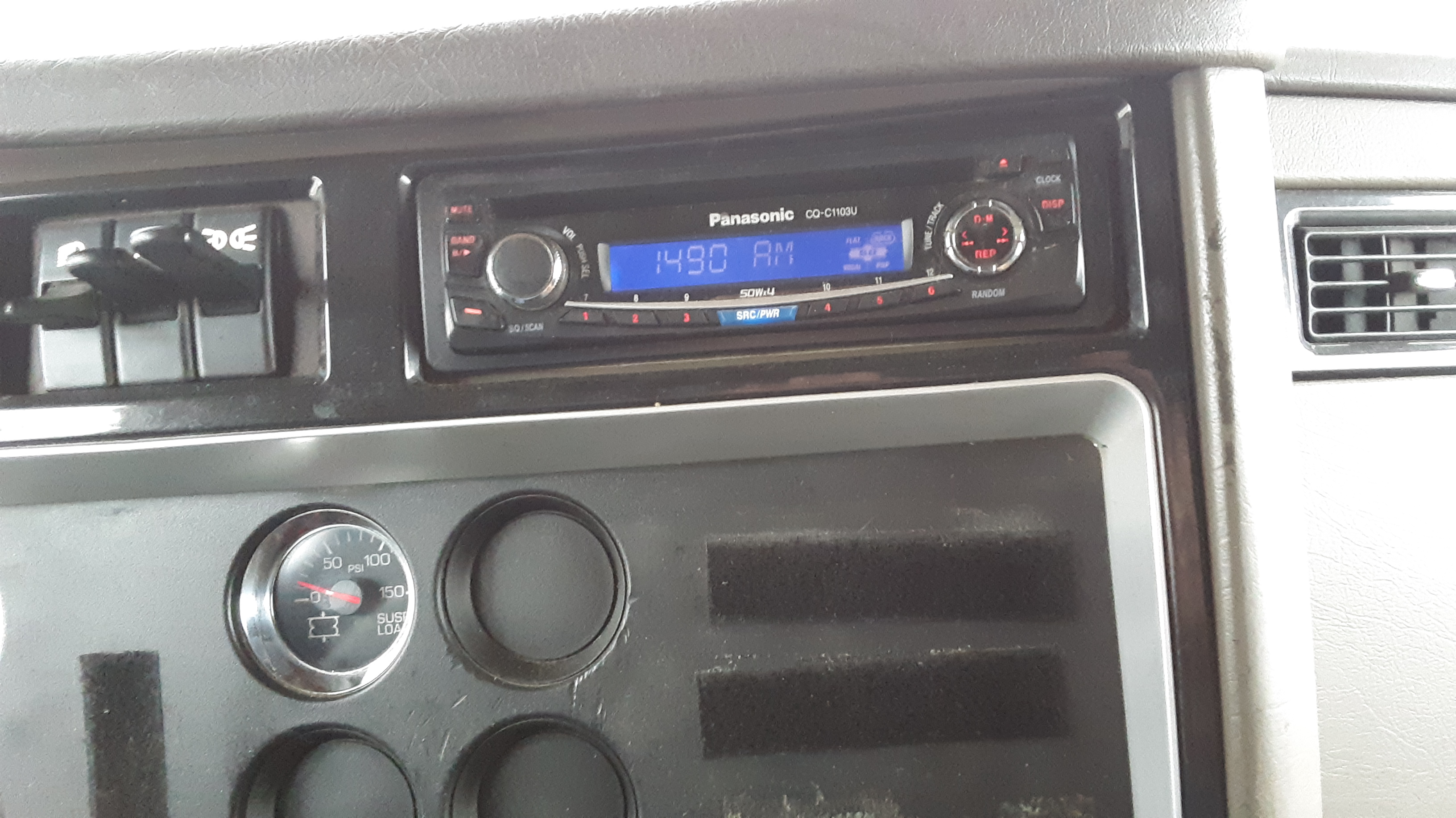

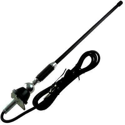

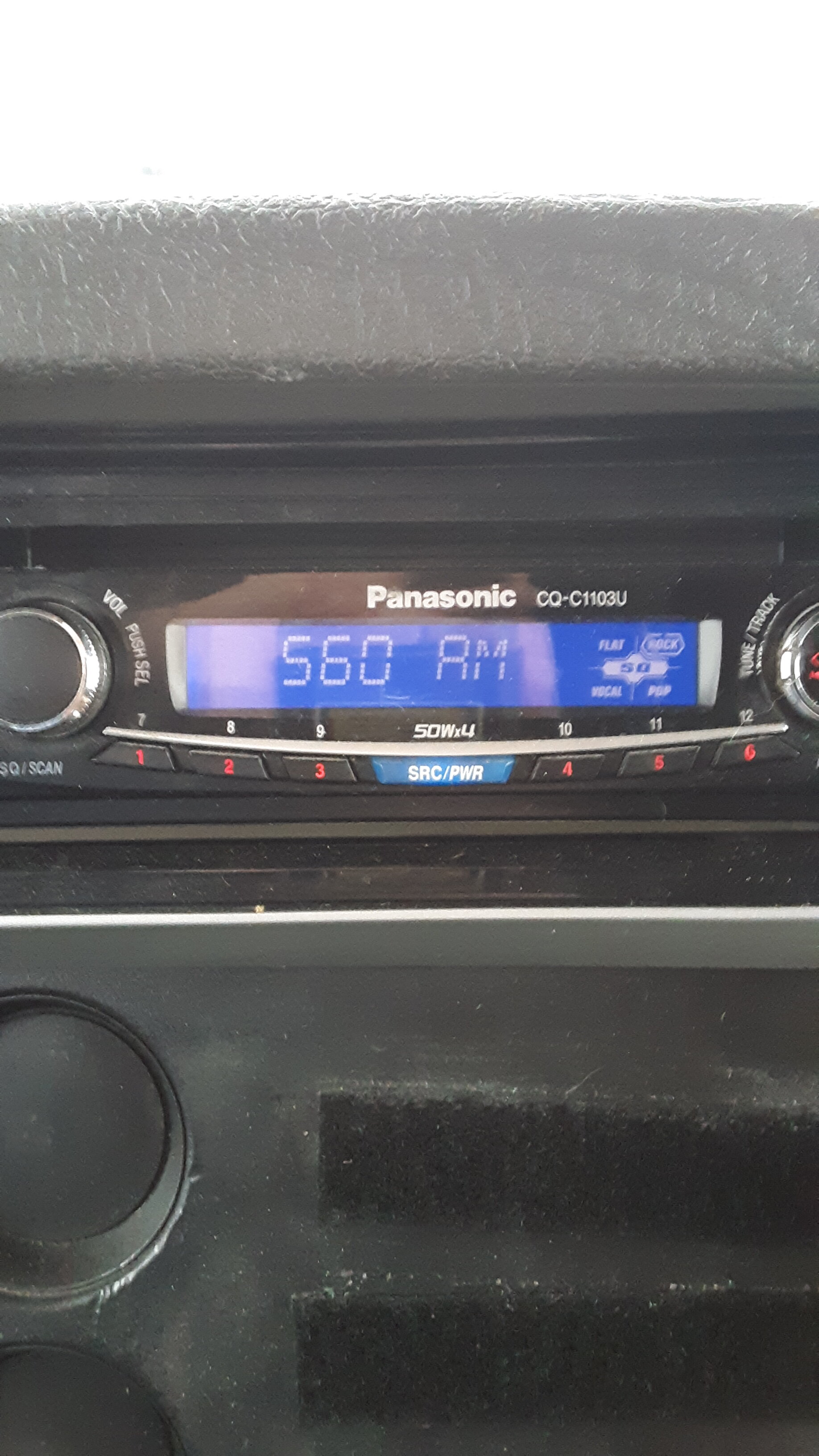

mudfoot i agree on am.i listen to it lots when truckin.wish kenworth had put better antenna on their trucks but they think we just listen to fm
