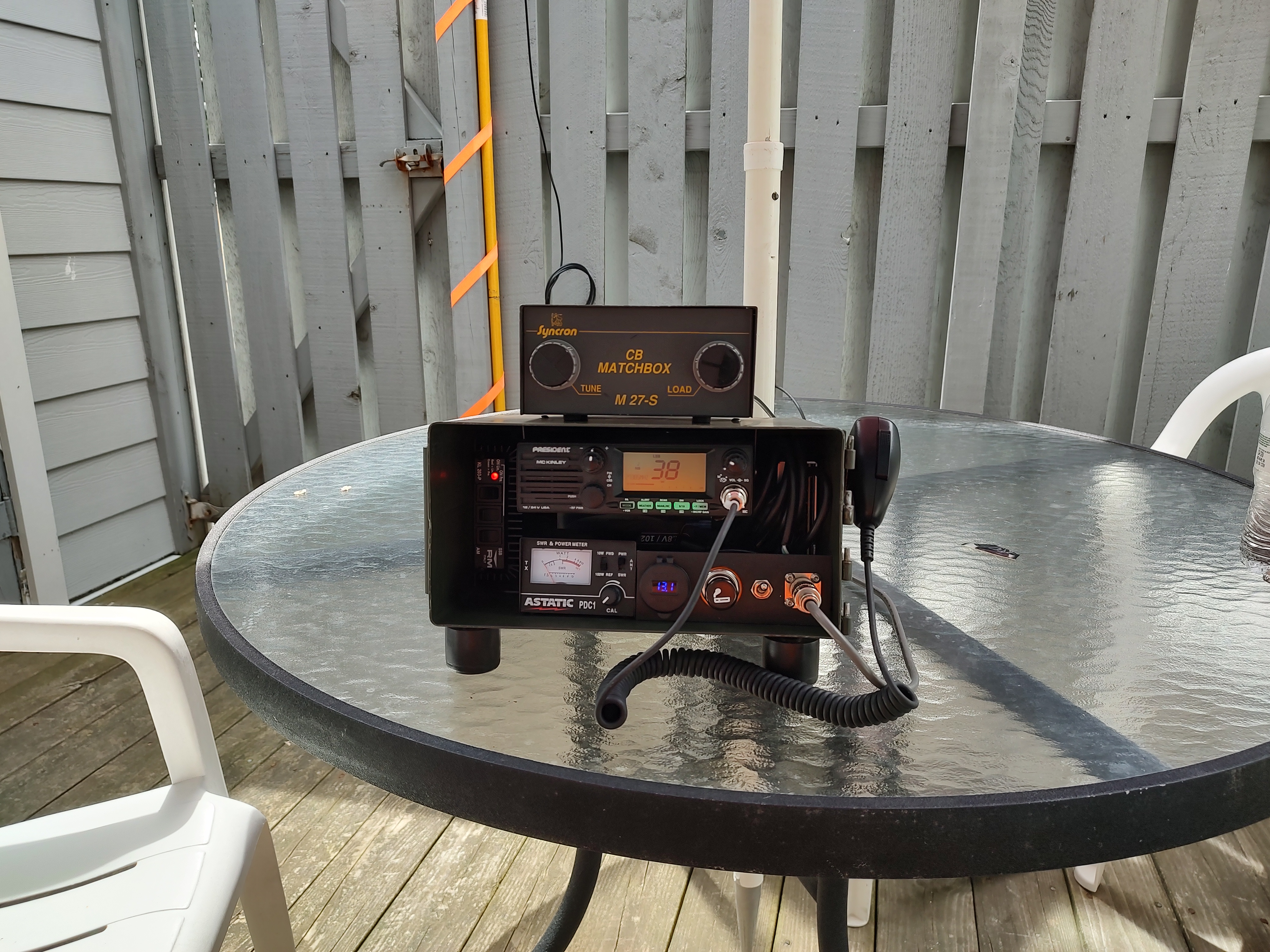

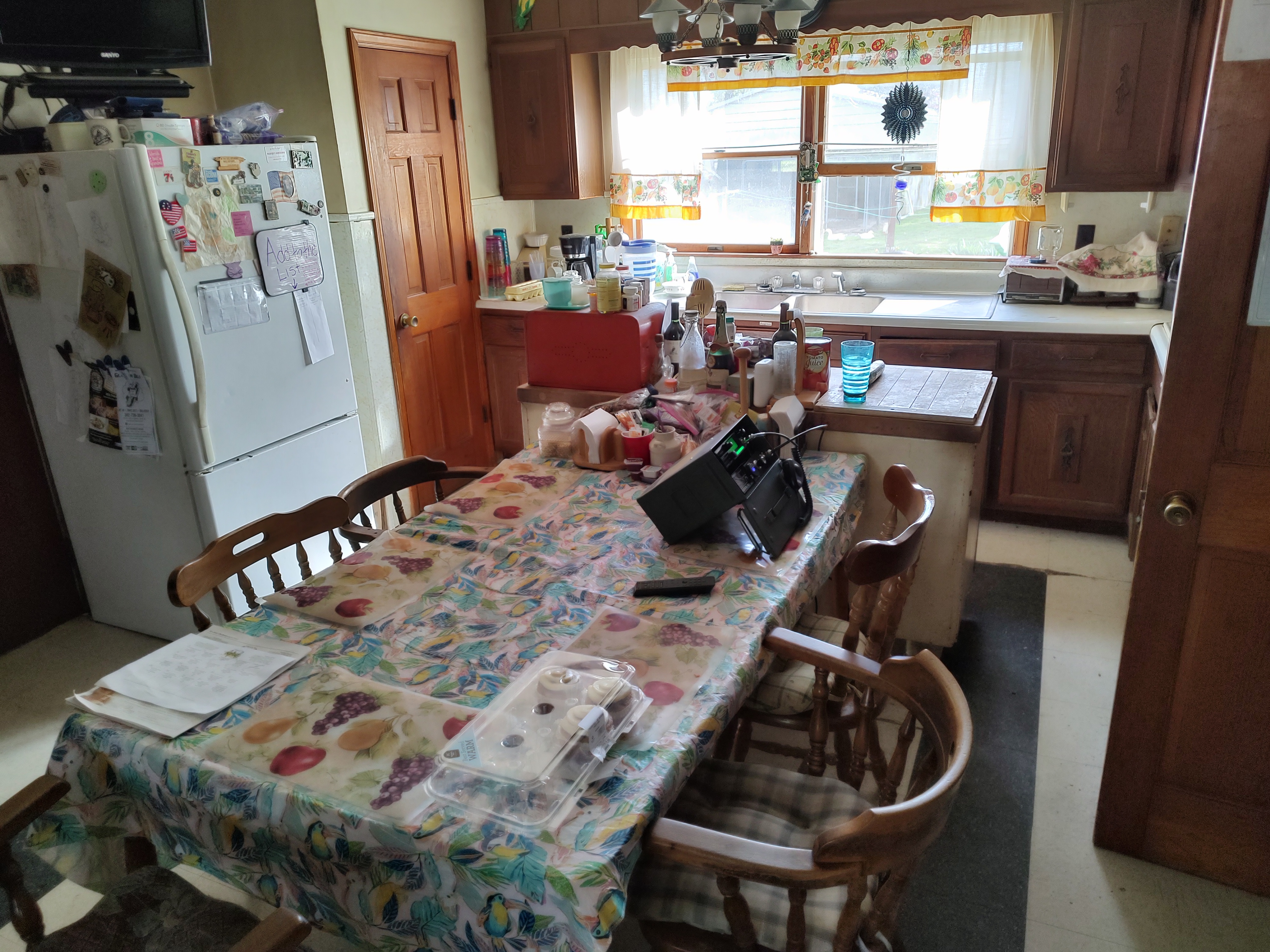

Currently using the Lincoln box at my mother in law's. I put up a Sirio 1/2 wave antenna on a 30 foot pole at the end of the house, works great. Having it in the portable can is nice, because I can put it out of sight when not being used. Here it is at the end of the table where I sit.

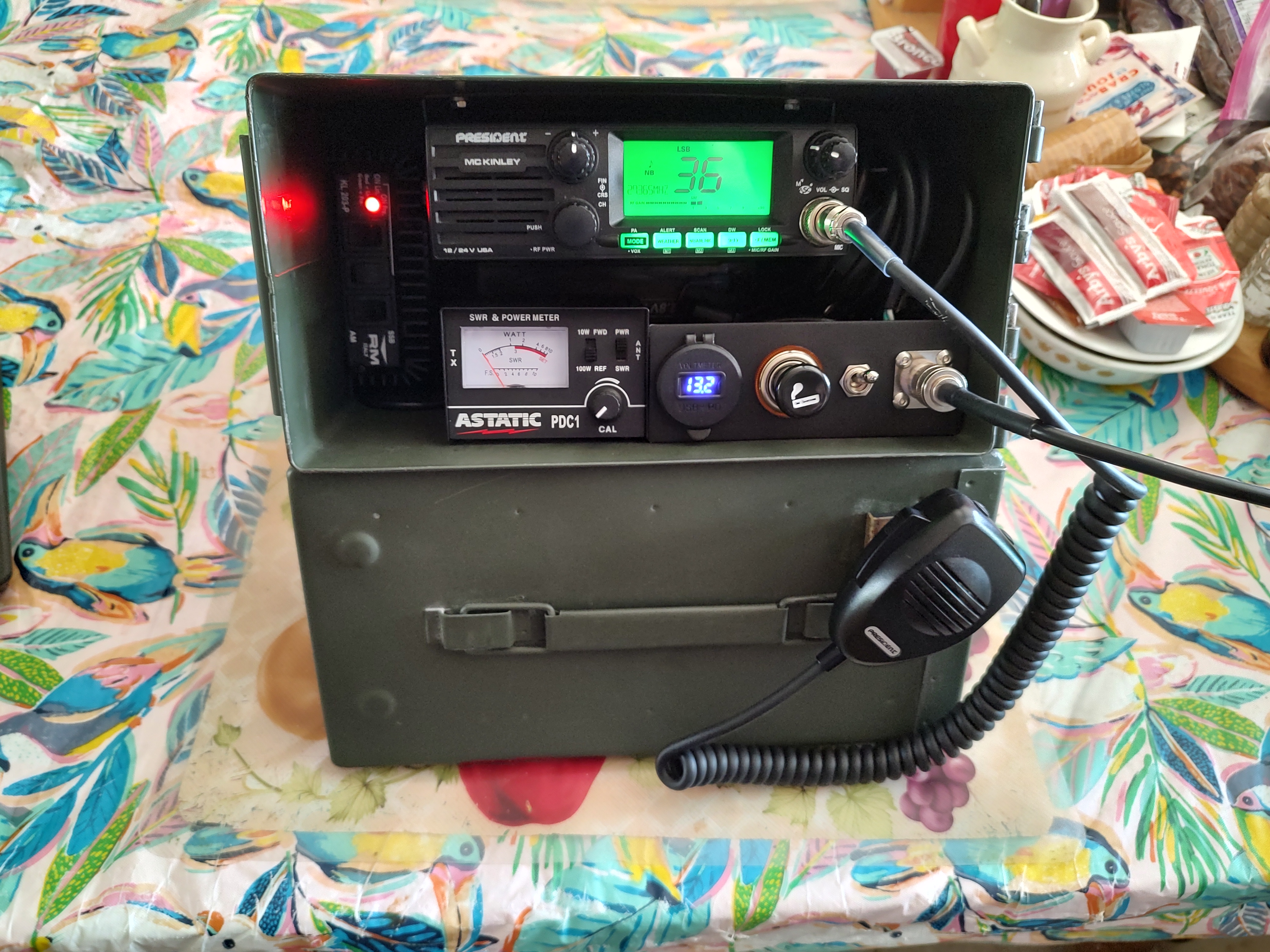

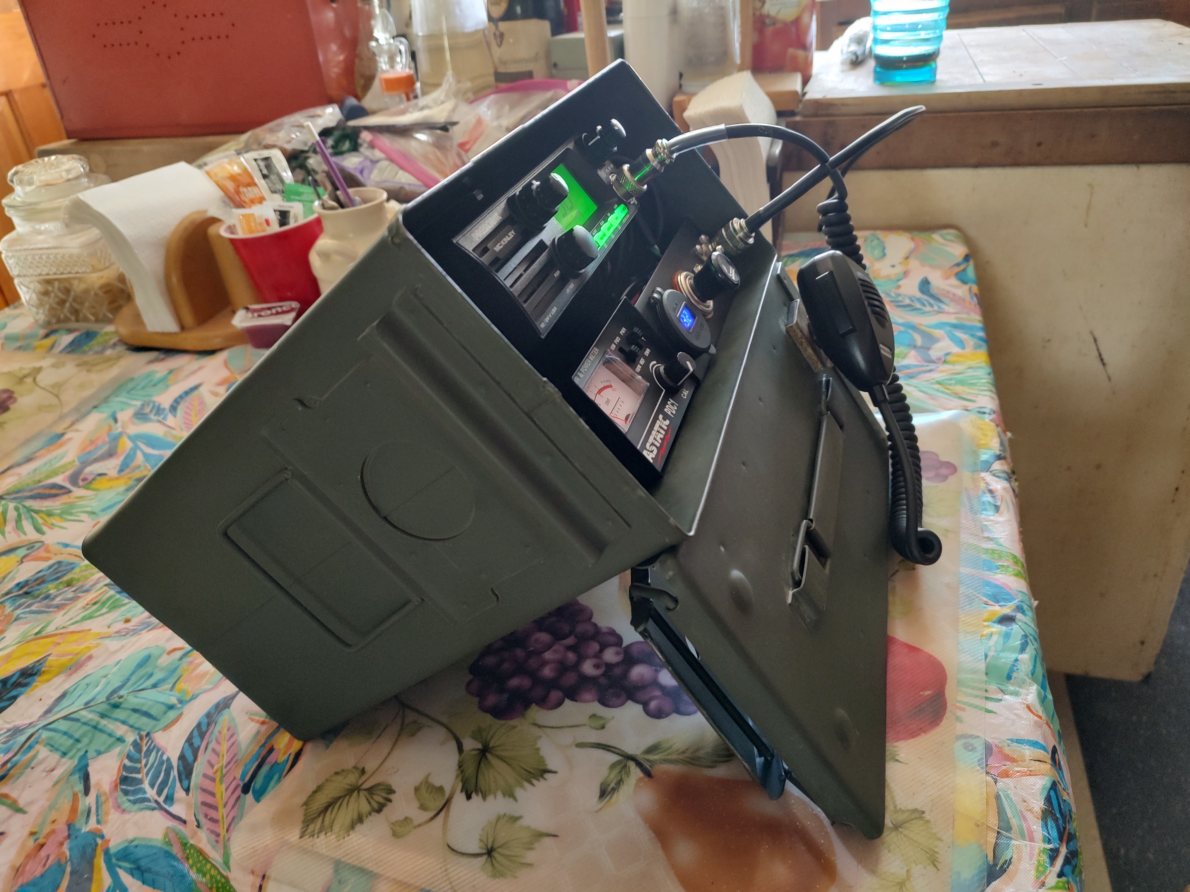

Just got the McKinley box together, putting it through it's paces. At my mother in law's house listening to California work DX into England. And I can hear both sides, what a treat. Even with the 203, it is hard to get a word in edge wise. Talking to some locals, I am getting great reports. I believe I have another winner.

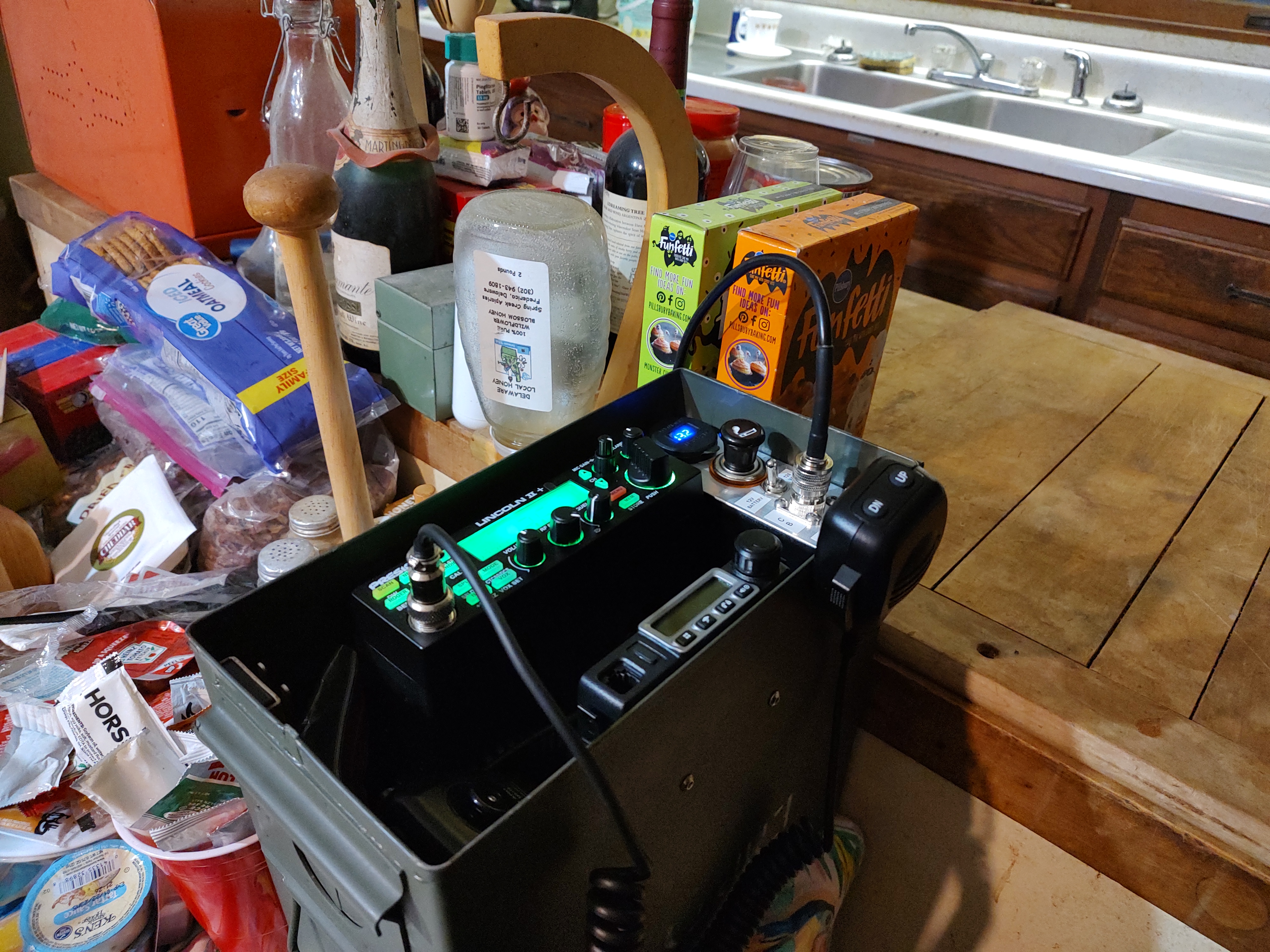

The boxes are doing great, I took the Lincoln out and replaced it with a Quad 6. The Lincoln developed some kind of receive problem where it has a little distortion sometimes. I have the Quad 6 box and the McKinley box both at my mother in law's house. So now I have a choice depending on what I am in the mood for. The 8 ah batteries do well and will last several evenings before needing to recharge. When one box runs down, I can put it on charge while putting the other one in service. I haven't been using the onboard power supplies because they make a little noise in the receive. Some day I will make a filter to clean them up, but the battery power works so well that I am not in a hurry.
