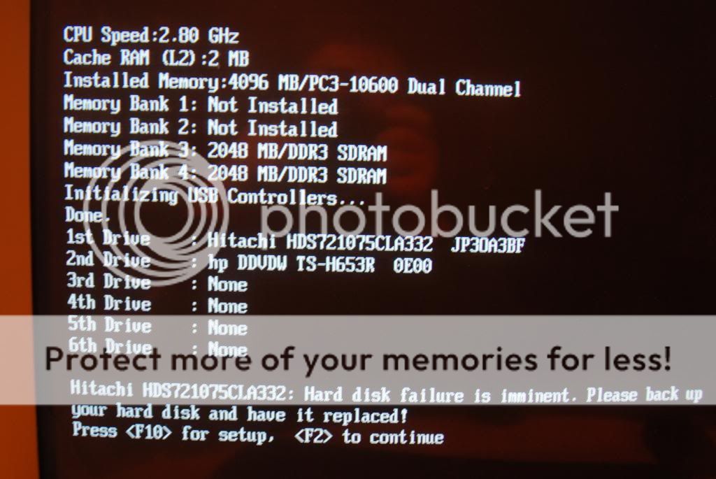

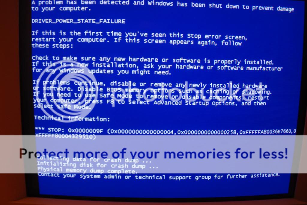

The "check disk" utility ran all nite and crashed when it was almost done....here is a pic of the blue crash screen and the black screen after I turned it off and turned it back on.....it started the check disk utility all over again.
