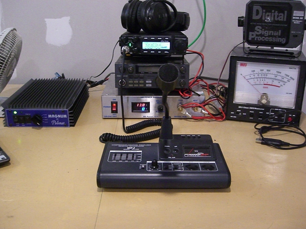

Any thoughts on running a Mic with a compressor with the at-6666, was thinking of trying out a mfj-299.

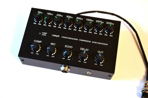

Finally got around to wiring the mfj 299 to the 6666, used the yaesu port on the 299 and have the modulation on the radio set at 28 and with the output on the 299 set at 2 oclock position getting good reports with compessor set on low and medium, but high really picks up some background noise from the fan I use for my little amp. I have not really played with the eq side yet. So far seems to be working good, also thinking of trying out one of those Russian made equalizer with 8 bands and compressor with a few other non powered hand mics I have laying around, not sure if anyone else does it or not but I totally remove pin #6 on connector so there are no mistakes made. Anyone have experience with those ebay equalizer's?
Ebay EQ
