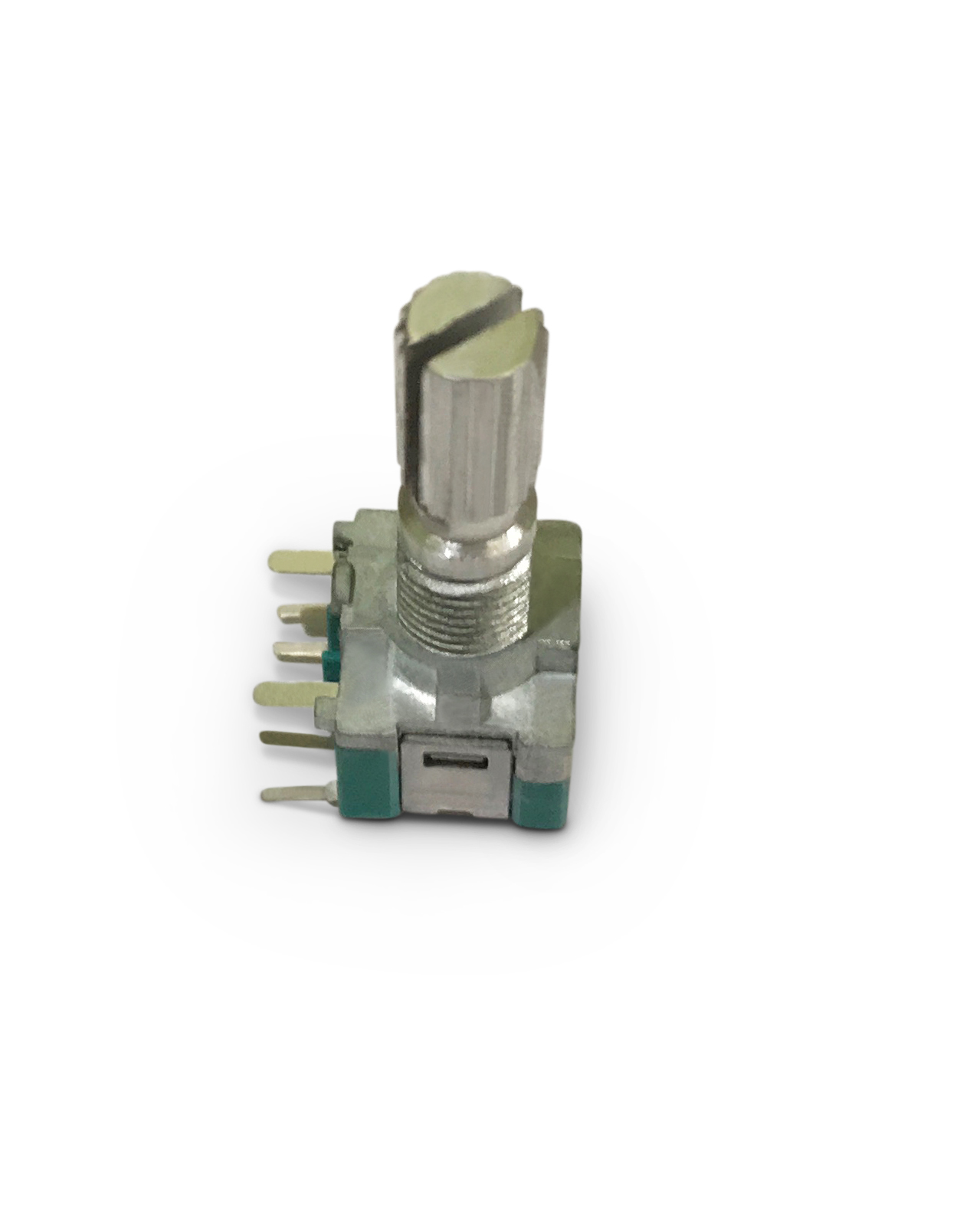

channel encoder is damn near becoming unusable. It's been finicky from day one and was for certain that it would be the weak point in this radio and it shows to be true. I've noticed that in the recent months it has started to get worse and after heavy use last night I think it's had it.
As common as these are nowadays, there has got to be someone out there with an encoder to replace these.
I'll continue to use it and changing channels via the mic but sure would like to repair it.
Anyone here know of a possible parts source?
Replying to myself here and hoping this could turn into a solution because the channel encoder can drive a guy nuts.
I'm thinking this might possibly be a compatible replacement for the quad 6. Am taking the jump and will report back.
