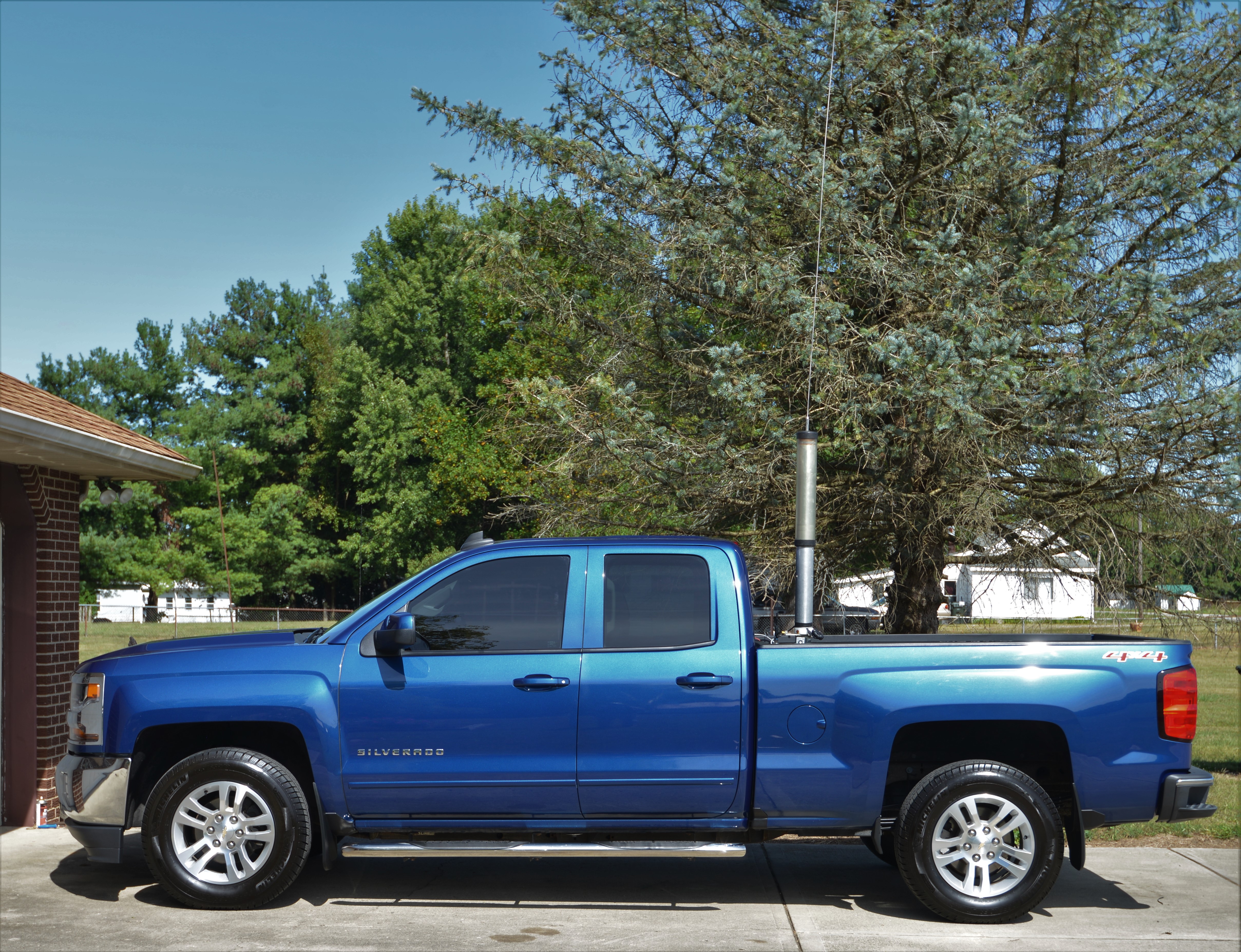

No rack on the truck. Extended cab. Until now I've been using a bed toolbox mount about a foot behind the cab. I have two mounts, one on each side, because I tried installing a six meter mobile. No success. Still have an option in that.
Homer about the only thing that will come close to a good screwdriver is those Hustler antennas...You get the foldover masts that are 54" long then add the 10 / 11 /12 meter loads close to 7ft long to end...The mast puts the center loads above the cab line in clear space...Hard to find anything to rival that set-up.
With the Tri-band adaptor can have 10/11/12 meters off of one stick..
I used those Hustlers for years before screwdriver antenna....
No Hamstick or base load style antenna will work better!
