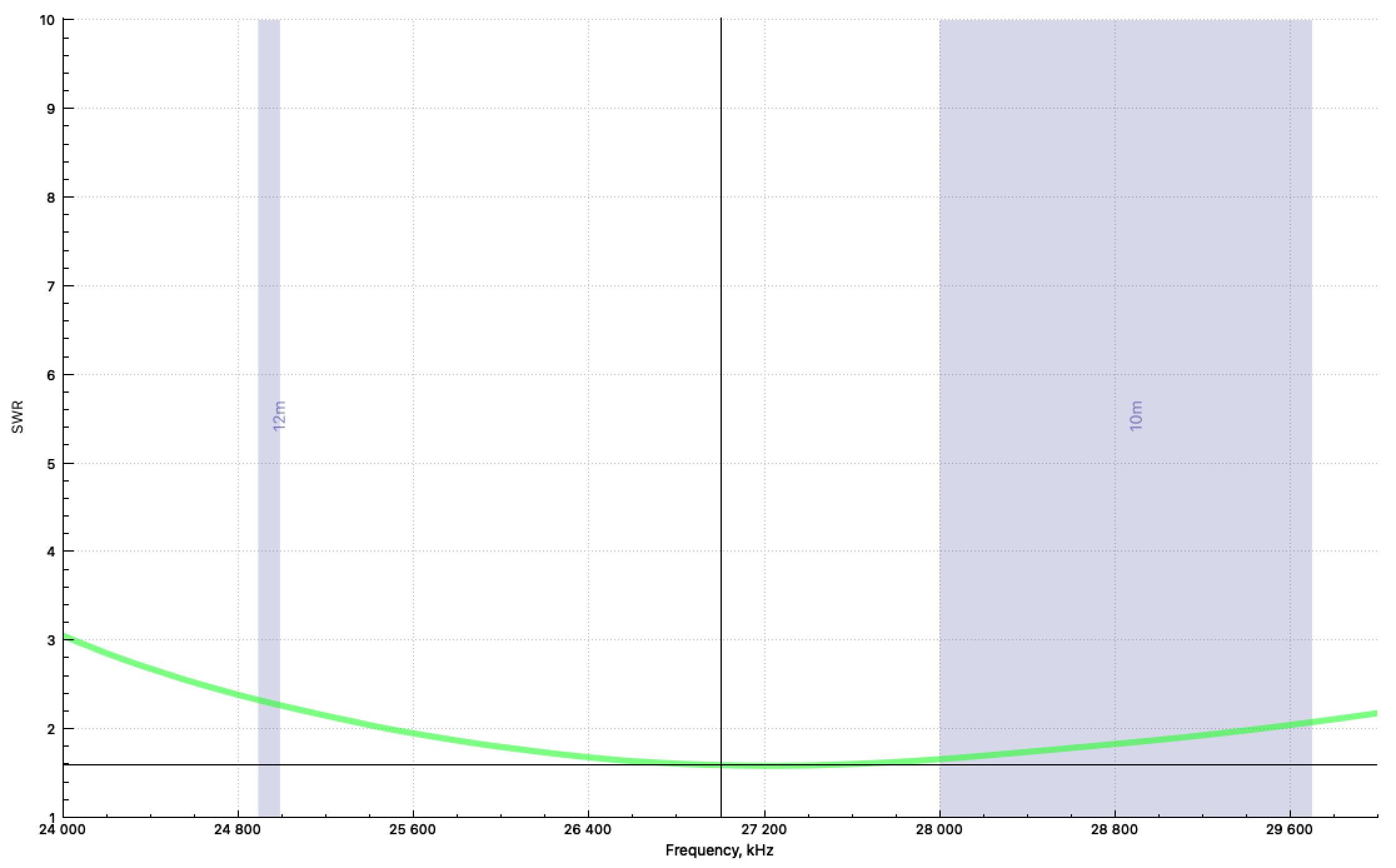

Those of you who do this may have found an antenna system that keeps them operational through the CB band and the popular lower SSB portion of the 10m band. Could you share your setup?
Hustler 1C-56 102 inch CB whip on a SSM-3 pot-belly spring and a MFJ-945E mobile tuner. The whip is resonant at 27.2 MHz, but the tuner can take it up to 29 MHz no problem, as a full-size quarter wave whip is fairly broadband. See the SWR plot above from a RigExpert analyzer, which shows the whip is about 2:1 SWR at 29.6 MHz without a tuner. Hustler also makes the 1C-56A "adjustable ferrule" whip, which you can cut to 29 MHz and then run a tuner when you want to go to 27 MHz.
Yes this will "work" but remember the tuner is only fooling the radio and not the antenna. You will still have a very out of band antenna. I did something similar before I got the screwdrive, I used a 17 meter hamstick and used a LDG tuner to load it up on other bands. It worked but the screwdriver worked so much better both TX and RX

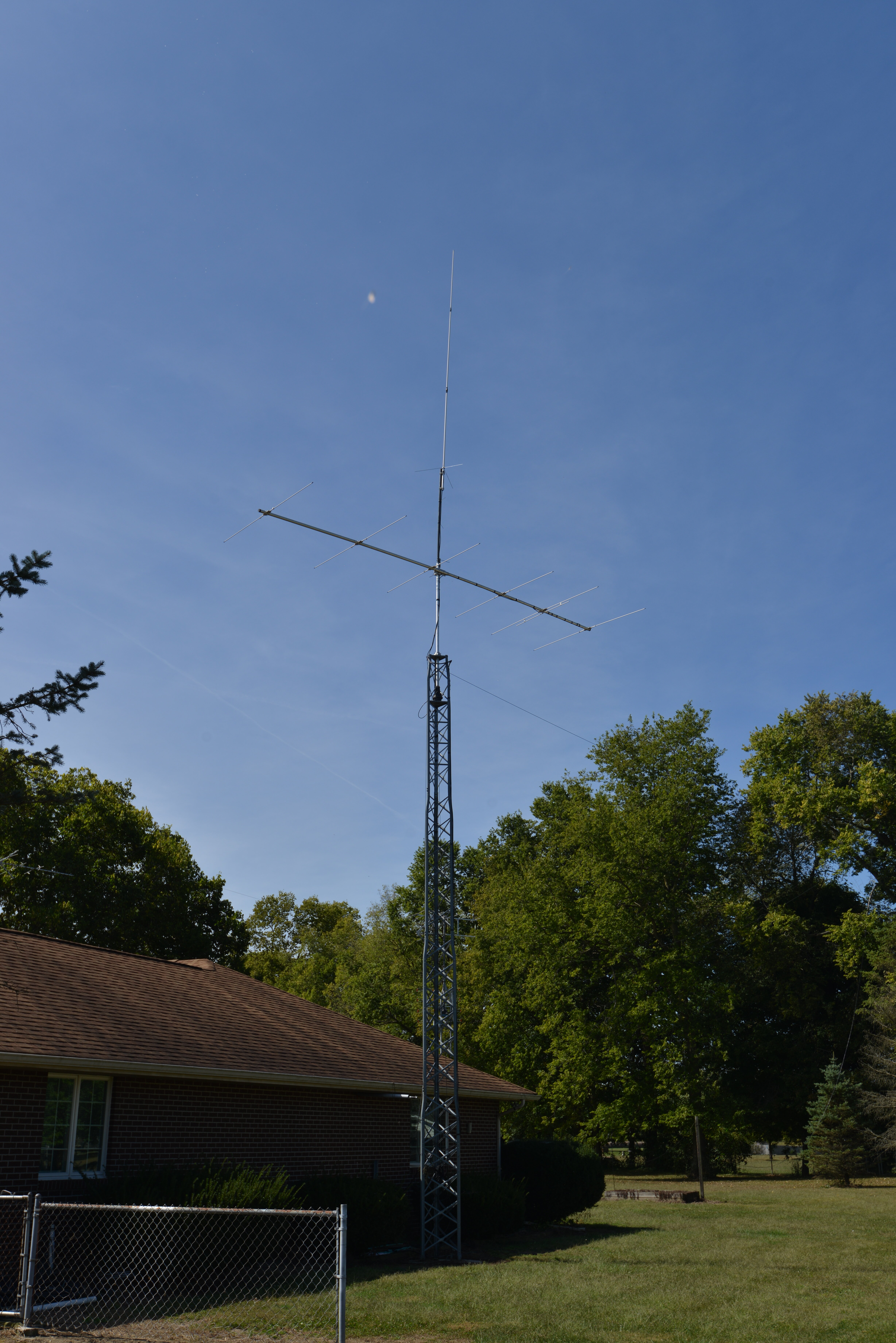

Two questions, Gary.
Is that a garage door your truck is parked in front of? Looks kinda small.
And what’s atop the the tower? :whistle:

Yep one of my garage doors. Truck fits nicely after I drop the antenna on my custom made Tilt-Over mount.
The tower has several antennas. 6 elements on 25 ft boom for 6 meters @45ft.
A Diamond F23H @48ft. : Diamond® Antenna ~ F23H Monoband Base Station Antenna
Both feed with LM400MAX coax.

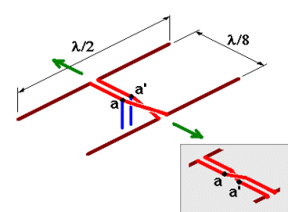

Support ropes for various antennas: My Homebrew W8JK 80-15 meter "Phased" dipole array@45ft. (124ft wide 34ft spacing)
Second rope for my 40/20/15m Half Square @35ft...that favors Africa/Europe.
That's tower #1 ...
