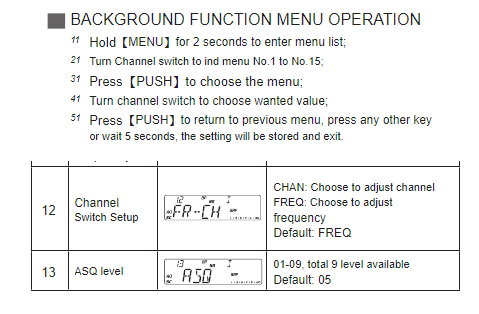

So MAX CCW is not max squelch; it is "ASQ-01~09". Max CW is max squelch (SQL-36). Max CCW is ASQ which is settable from 01~09 w/ default of 05. When you turn your SQ knob, it will show you the level of squelch you are in. To get to "no squelch", you have to go to 9:30~10:00 on the knob to get out of ASQ. The squelch readout will just say "SQL". As you go further CW, it will then indicate "SQL-01;02;03; etc. all the way up to SQL-36 at full CW.

Try setting your ASQ to "01" which is the least amount of squelch. If you have a high enough noise floor level, it won't be squelched when you turn it full CCW.

You can effectively "disable" the ASC function in the service menu. Ch 14. 15, and 16 deal with the ASC.
v3 Service Menu = Hold down PTT + Menu + Mode and power ON Write initial value down before changes otherwise your going to cry when it’s broken.
Default settings:
Ch 14 asqon 0112
Ch 15 asqoff 0267
Ch 16 asc 0587
Lowering the value of 14 and 15 will effectively disable ASQ.
Now when you turn the Squelch full CCW, the display will say ASQ but it will be "off".
